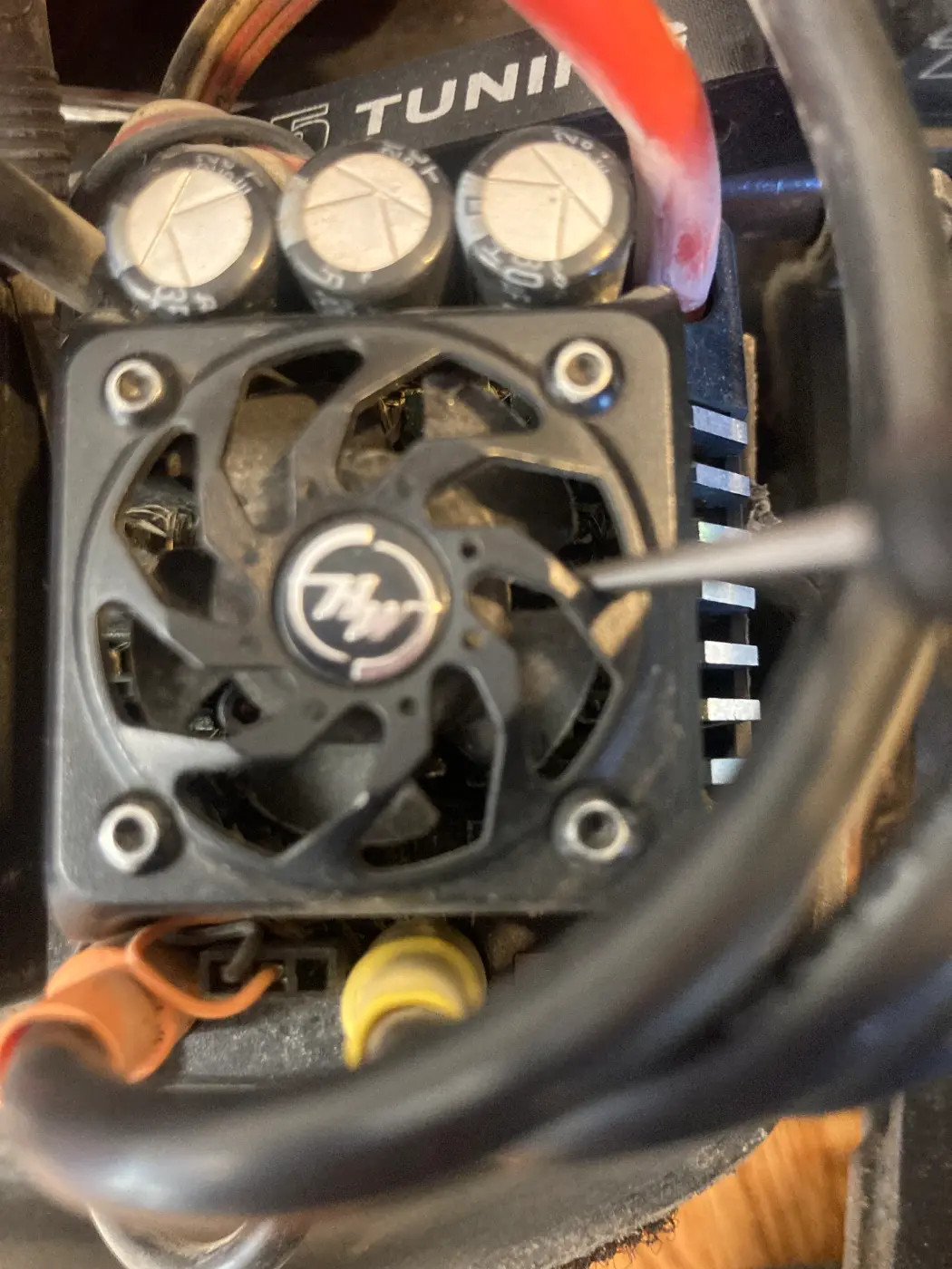

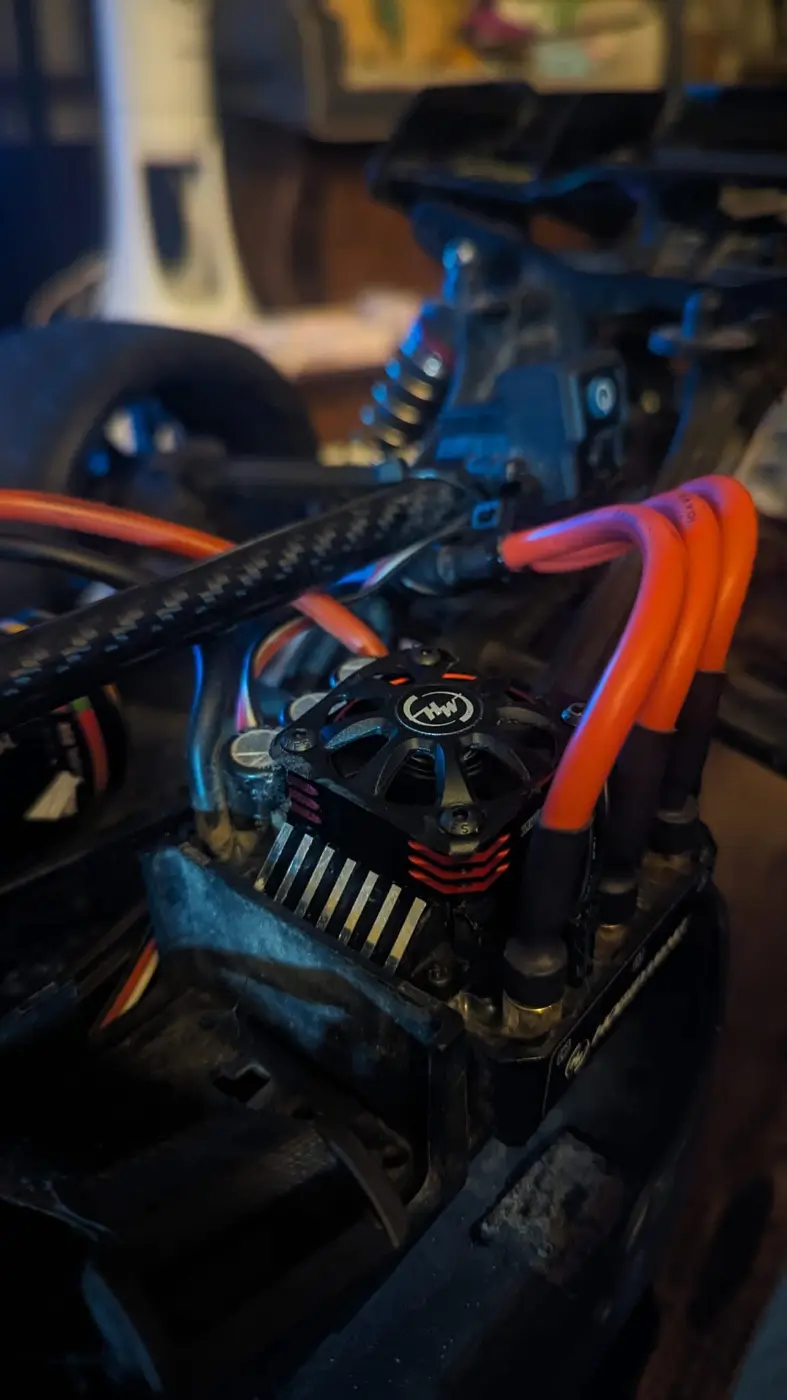

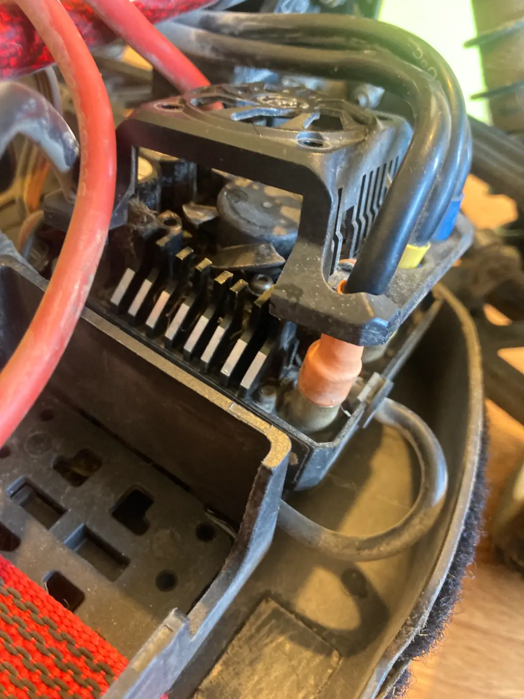

It’s upside down in the pics the shroud comes off and it just screws on, I’ll try take pics of mine, but if want to upgrade the fan just fit a 30mm fan on top of esc.
I'm not picturing how you screw a fan with three screw holes onto a fan mount that has four.
The screws go in between the heatsink ridges, so you basically anywhere on the heatsink.
But I’ve never seen that particular fan in your post.
My max8 came with it installed but wouldn’t consider it an upgrade personally, I’d add fan on top of the esc if want to upgrade it. I buy them in bulk cheap as chips

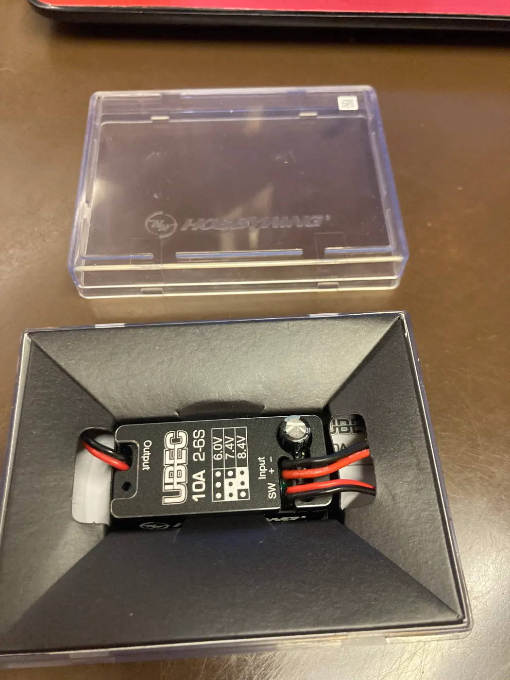

So I checked with a multimeter while the ESC fan was running and I discovered that the fan port on the Max 8 is the same voltage as the BEC, which means if you set the BEC to less than 8.4v it cools less (EDIT: although it's possible that the stock HW fan runs at the same RPM regardless of input voltage). It also means you can put a better HV fan in there and just connect it to the fan port so long as you're running the BEC at 8.4v
Your bec controls voltage to servo & the esc. I don’t like running my servo’s above 7.4v to save them burning out but each to their own.
HV servos are designed to handle a fully charged lipo receiver pack. If they can't handle that then they cannot be used in IC vehicles. The components are actually rated higher than 8.4v, nobody makes mosfets, regulators or passives like capacitors and resistors rated to exactly 8.4v or 7.4v only 3.3v, 5v, 6v, 7v 8v, 9v or 10v. (EDIT: I'm not mentioning voltages higher or lower than this suffice to say no datasheet I have ever seen has the rated maximum voltage for a componant listed as somthing point somthing unless it's 3.3v or less). This is why for example FrSky gives the maximum rated voltage for their recievers as 10v and not 8.4v, because 10v is the rated maximum input voltage for the 3.3v linear regulator they use.
That said I would not reccomend running a servo above 8.4v because you have no way of knowing what the maximum actually is, it could be 9v or it could be it's designed for heat dissipation at 8.4v and going higher could overheat it. However if run off a 2S reciever pack (which was the original intent for HV servos) they are going to be getting 8.4~7.4 for part of the runtime because 8.4v is the voltage of a fully charged lipo or li-ion battery.
lol like I said each to there own, I like having my fans & lights running @8.4v but not my servo that’s why Ive got a separate bec controller for mine run of a separate battery
