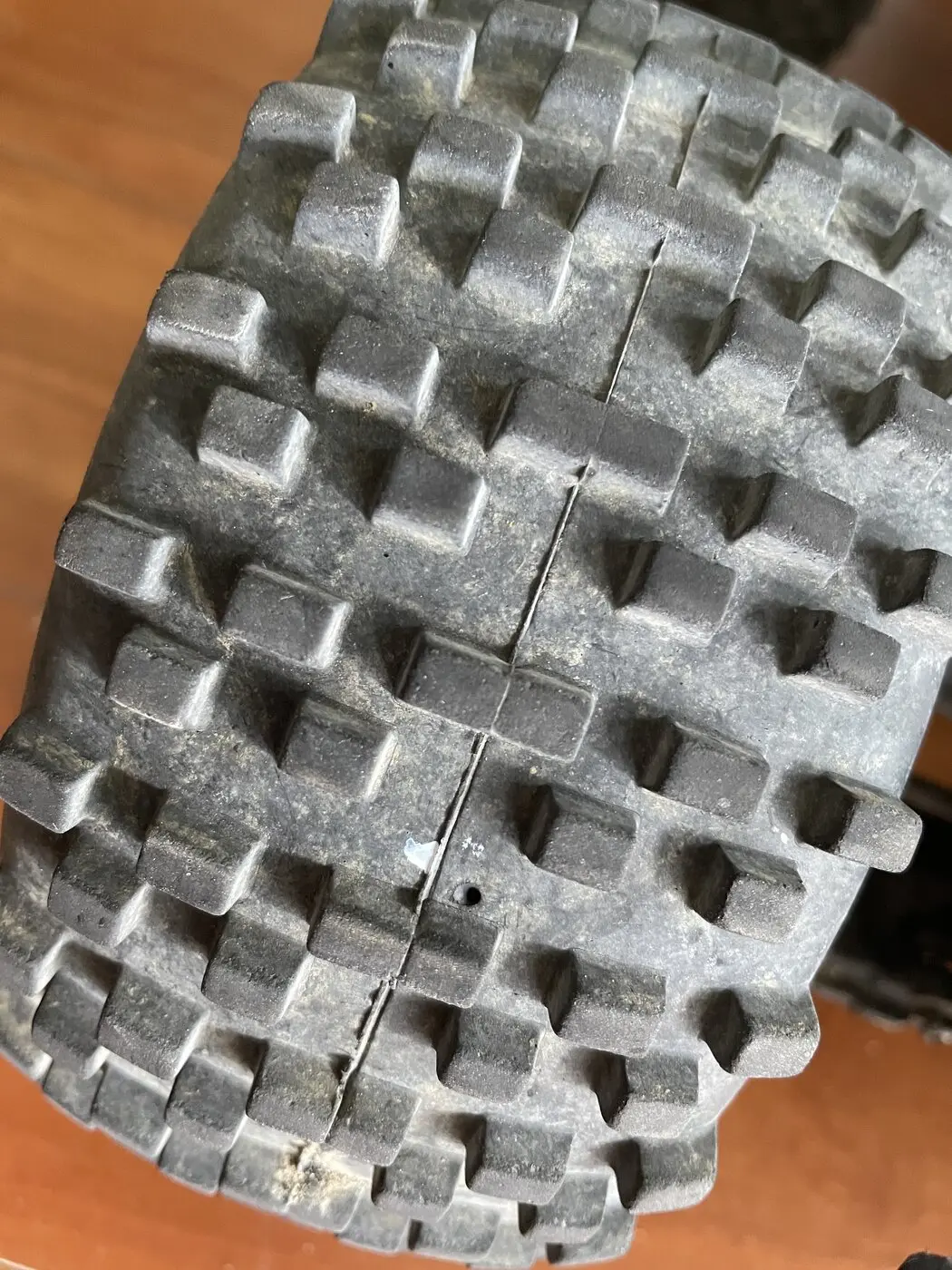

Do you guys pinch your tires?
Since I seal the holes in the rim but prefer vented tires I pinch some holes (three per tire).
It looks like this:

Yes, I have been doing the same recently. Holes in the wheels seems all wrong to me since that's where snow, mud and water collect then forced into the tire during use. If the tire and wheel are both sealed, pressure would likely break the bond between the tire and wheel, as well as making for a bouncy ride.
Yes, I'm the same. I don't understand why manufacturers keep venting the inside of the rim instead of the outside of the tire.

I've been testing this on the Dementor tires that I bought, I sealed the holes in the wheels but didn't put any holes in the tires. It doesn't really seem to affect the ride at all and the tires are staying on better than my factory dBoots Backflips did.

Arrma has stopped doing this. I bought a set of dBoots Backflip LP the wheels are sealed and the tires are vented, same goes for the dBoots Copperhead 2s on my Kraton EXB.

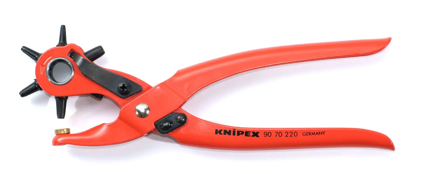

Gosh! What an effort! o_O
I took this very (un-)sophisticated tool:
lots of individual adjustments are available! ;)
And you won't need any band aids or paramedics...
