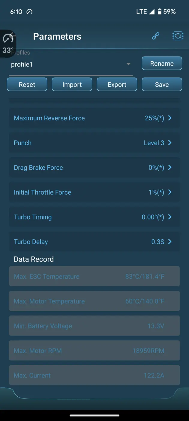

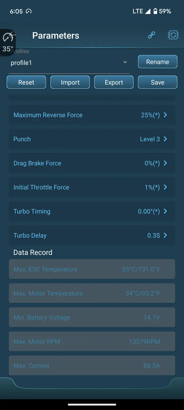

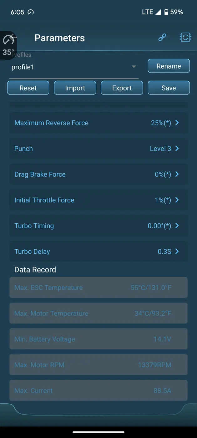

Today was 91 degrees when I ran my Kagama on 4s for the 3rd time.
Within 5 minutes (timestamp on the screenshots) of running with a throttle dual rate set at 75% but never hitting full trigger, my ESC shut down with blinking single red light.
I had driven the truck 15 minutes to the place I run at, but drove it at 5 mph max.
Temperature was 131 at 6:05 and 181 at 6:10
ESC fan is operating fine. Am I expecting too much of this ESC running in 90 degree weather? I never expected to thermal shutdown on 4s in 5 minutes. Anyone else run Max 8 ESC in hot weather wanna chime in ? Does the stock fan suck? Do I need an aftermarket fan ? I use a 40mm 12 volt 1 amp server fan on my motor, and it only gets a little hot.
I didn't expect the Max 8 to be such a p***y ESC. My bad ? I bought it from Amain Hobbies, so I don't think I can just return it and buy a Max 6 instead. I shoulda stuck with Amazon...
Any advice would be great. Thanks in advance!

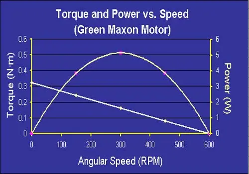

I can't comment on the Max 8, not really, although the Torox 185 is similar.
The Kagama is a much heavier rig than your Felony, so the load on Motor/ESC is going to be greater.
Lower speed running, with on/off on the throttle tends to be more demanding on both ESC and the motor, much like racing on a tight twisty indoor track, although I note that it's your ESC with the heat. Your motor seems cool enough.

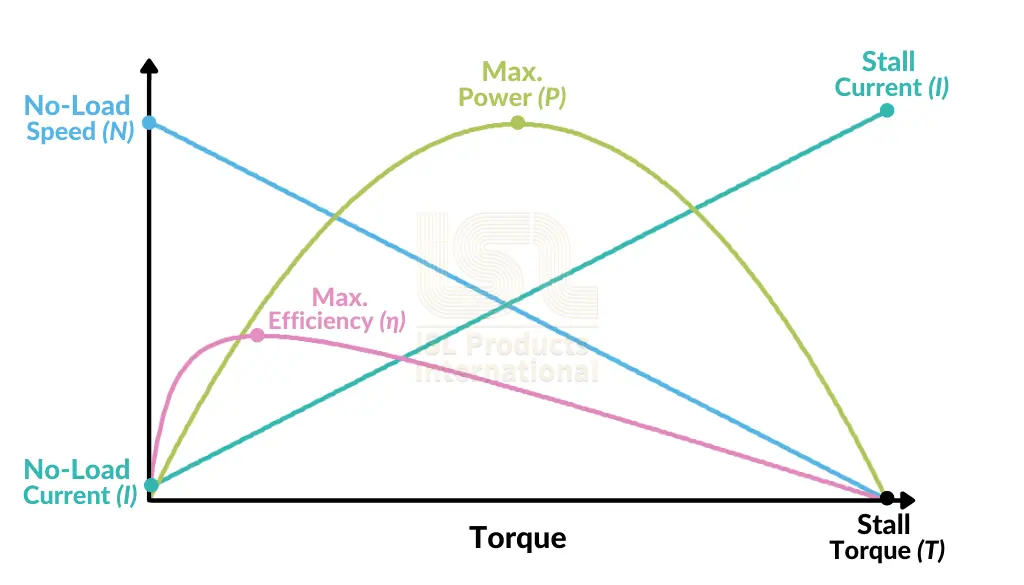

But it's where the rig is accelerating hardest from stationary or low speed (or anywhere closer to the stall current shown on the graph) that draws the most current. At maximum speed or cruising at a fixed speed will draw less, even at full throttle. This is counter-intuitive, but motors produce maximum torque from stationary.
You'll note that maximum efficiency is achieved around 30% of maximum power. Maximum power (torque multiplied by revs) is right in the middle of your rev range, before torque falls away as the RPMs rise.

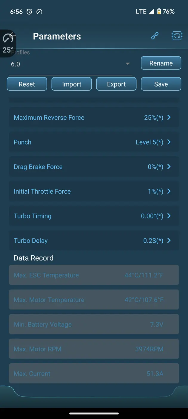

I did a little better tonight, only one thermal shutdown at the end of my run.
I run on dirt \ loose gravel.
I put a second 30mm fan on the ESC, above the stock one.
I ordered a 40mm 12v 1 amp server fan (same as on the motor) to put on the ESC.
I'm thinking about contacting Hobbywing.
I'm also wondering if Kagama is too heavy for the max 8.
I use a 9000 mAh 80c 4s Zeee soft pack, which is a heavy-ish battery.

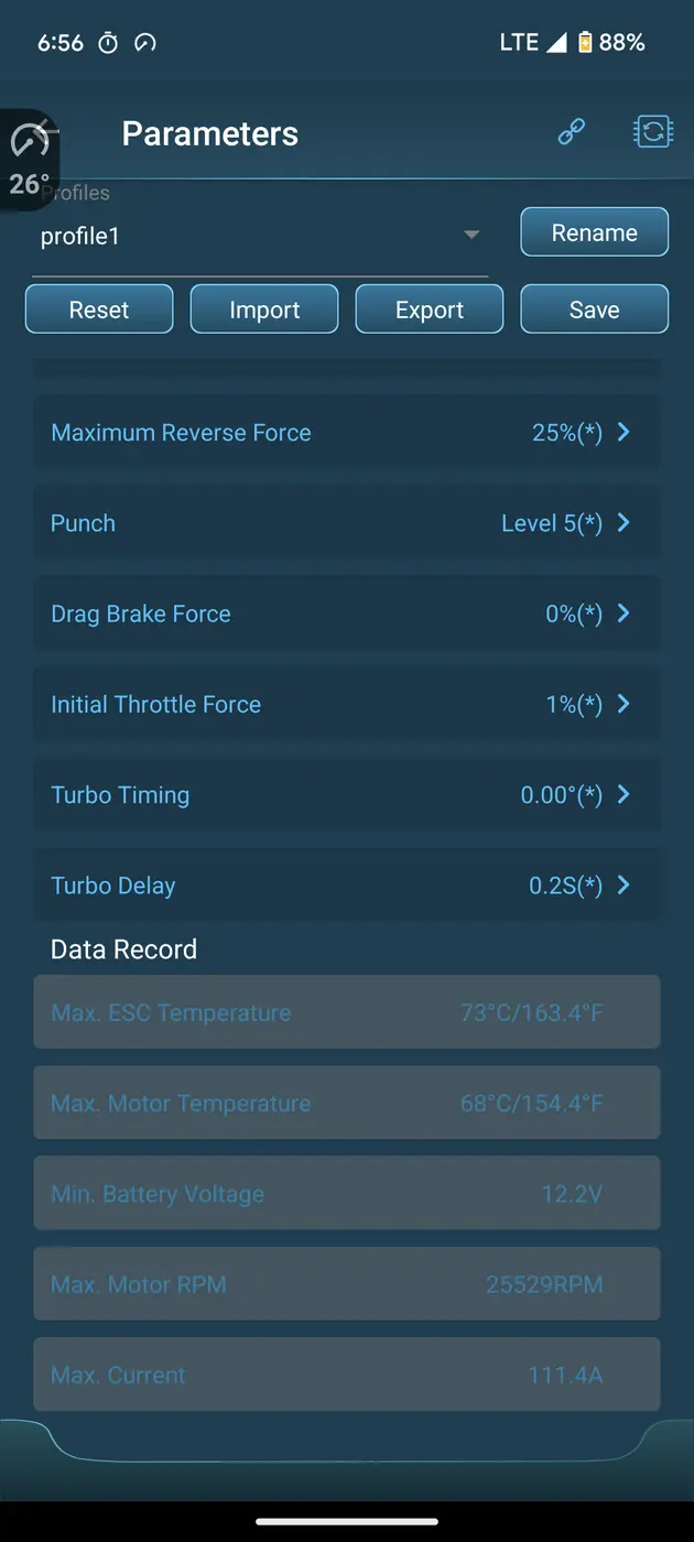

Today I went to an 11 tooth pinion and my temps maxed out at 160-something after 20 minutes. My ESC fan is running fine. Stupid G2S has feature where the fan only runs when temperature is elevated. I put a second fan on top of ESC fan, same size, it runs all the time.

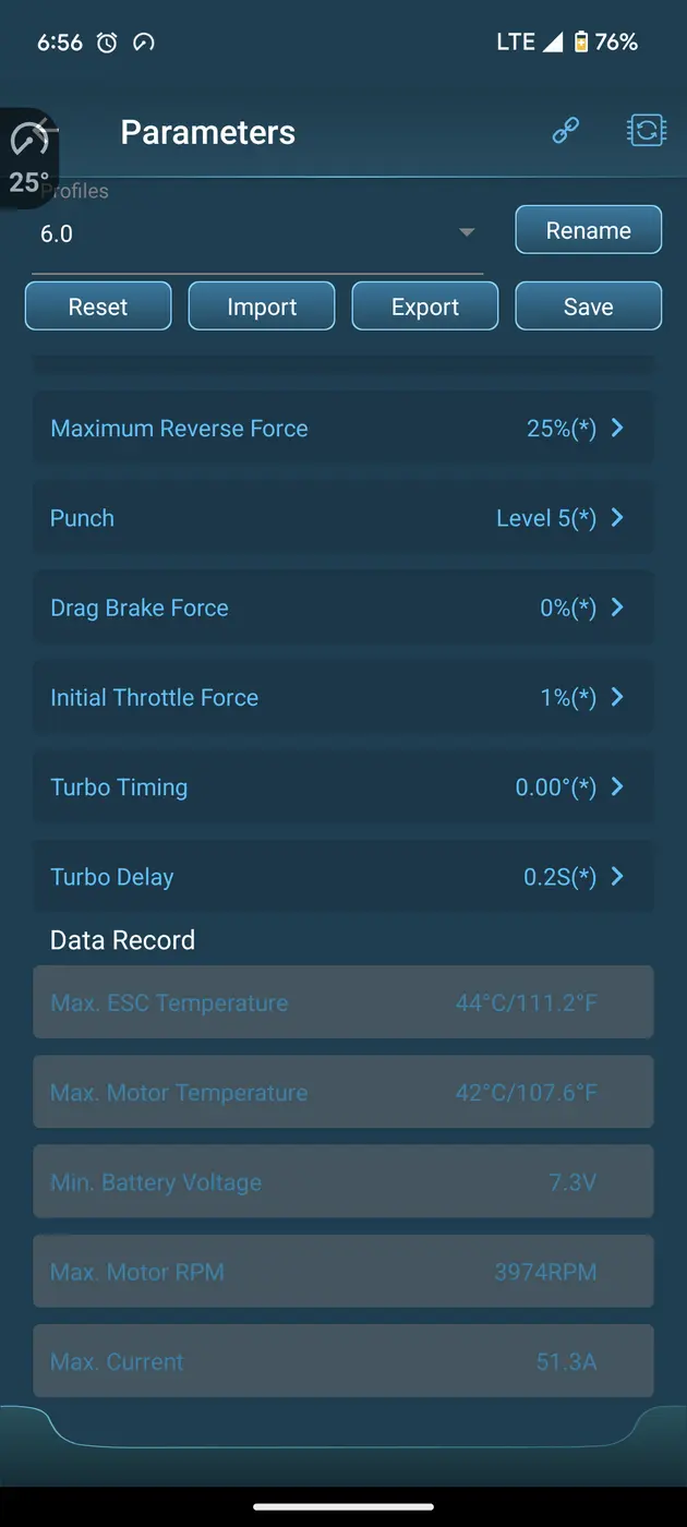

I'm an idiot. I assumed I was getting an ESC thermal cutoff because the truggy completely stopped moving, only the steering servo functioned.
But I had the red light on the ESC doing a single flash, which the manual says is LVC state.
I am open to the possibility that my Zeee "80C" battery is a lying can of feces, and my ESC has decided I was at LVC because the Zeee battery cannot provide enough amps due to a low C rating, regardless of what the specifications say.
However, I am very puzzled, because in all my other vehicles, when I hit LVC naturally, there is no throttle cut, but the vehicle goes instead very slowly, to indicate LVC
So now I am confused, because I do have high temperatures (high maximum temperature according to the HW app), but the instructions say flashing red light is LVC warning.
I just have never had full throttle cutoff on LVC, not on a hobby grade vehicle. I've seen toy RCs do LVC like that, with no throttle response after LVC.
Sorry I am so confused and confusing with my unreliable information.
It would be a huge help if anyone else owning the Max 8 G2S (sensored) ESC can please let me know if their LVC results in complete throttle cut ?
Thank you everyone again in advance.
I am not trying to make this process difficult, but my small amount of experience is causing me to be confused about the situation.
Everyone here has been a very good help👏🏽 and I appreciate the patience in dealing with my poor skill level and confusing contradictions. 🙏🏽

Okay, the end of the story has occured.
I appreciate everyone's input, and before I go further, I have to ask everyone to please excuse my lack of experience.
Today when I was out, I tried a 6v BEC, and I didn't run into the cutoff issue on the 4s battery.
However, my "drive back home" battery (I live 15 minutes from my bash spot and walk there) is a cheap AF Hoovo "50C" pack, and I hit a shut down 2 times. The second time was right after doing a bunch of jumps for some neighbor kids. This time when it shut down, I noticed my "lowest voltage" reading was 7.3 volts, on a 3s battery, remember.
So, my lipos are to blame, they're only 6 months old, but clearly not 50c and not suitable for Kagama use.
Buy cheap, buy twice, I guess. The voltage remained so low on that 3s battery that when I turned the ESC back on, it just beeped at me continuously, and wouldn't drive. That's when I checked the voltage.
So I wasted everyone's time by not fully understanding LVC.
I apologize, and I have ordered a quality 5s true 40c battery from CNHL.
Again, really sorry for misunderstanding the situation and wasting y'all's brainpower and typing effort \ time.
I guess my voltage was so low that a protection cutoff had been reached.
Now I understand why people pay extra for big brand batteries.
