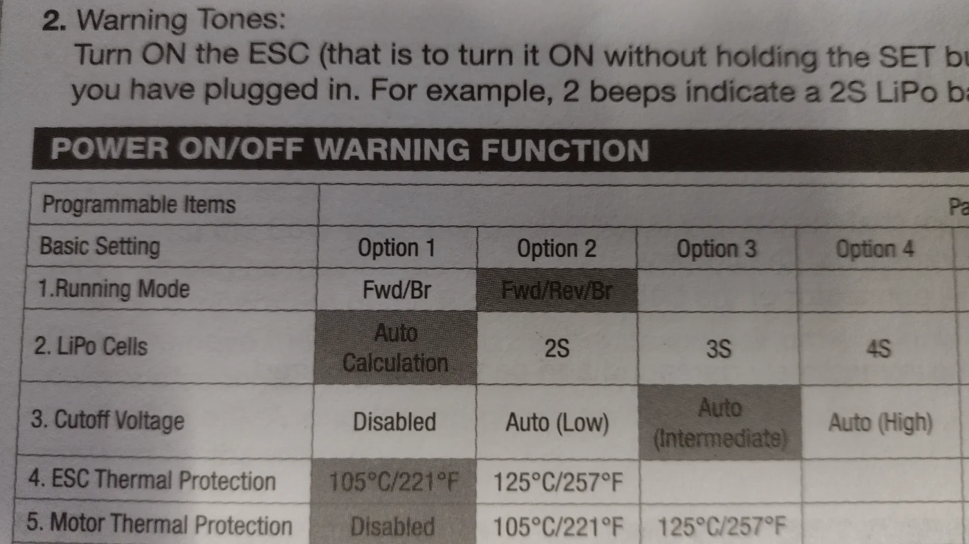

hi just wondering if someone could help me. recently purchased a 2nd hand good condition 6s kagagma everything works fine except reverse, so was thinking is it just forward only.. thanks in advance

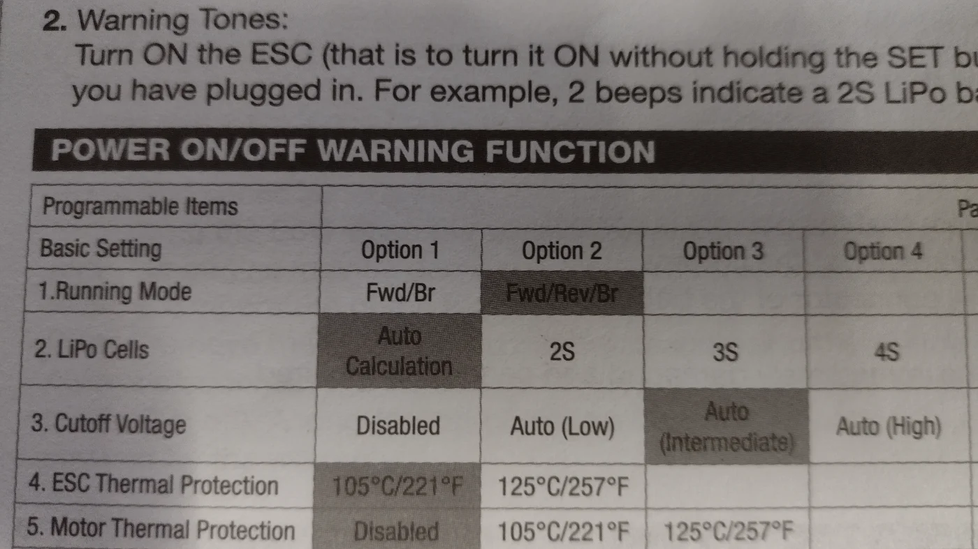

Check the running mode of the esc because yes it should have reverse
It's also worth checking the throttle trim is at neutral and recalibrating the ESC to the receiver, just to make sure that the neutral point is accurate.
The ESC won't go directly from FWD to Reverse, so if the neutral is slightly forward, then reverse just operates the brakes.
