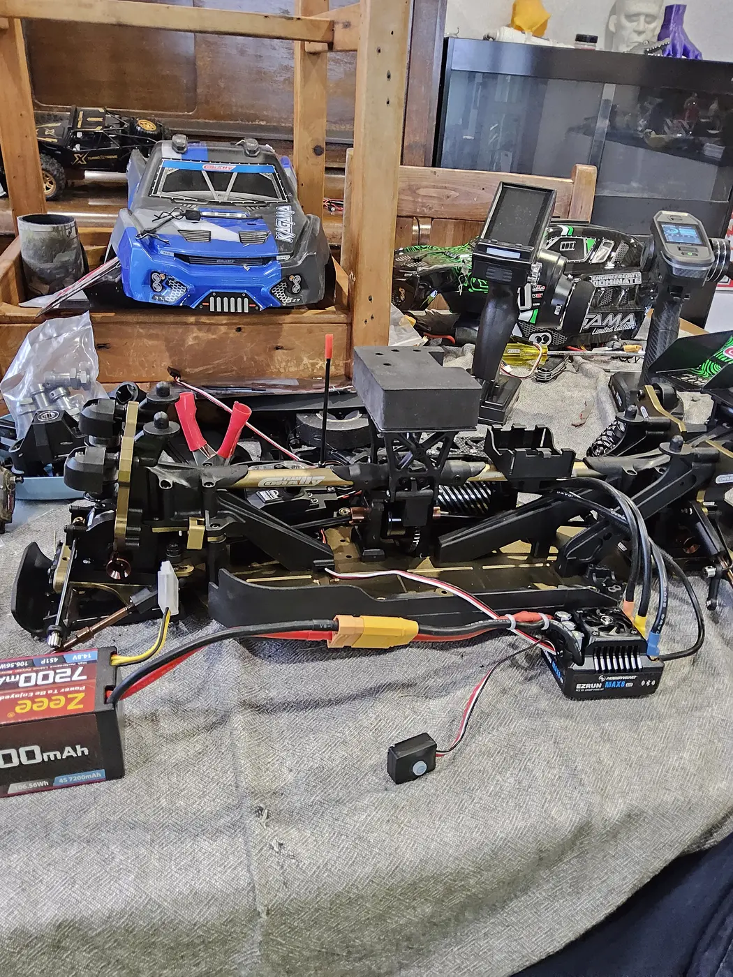

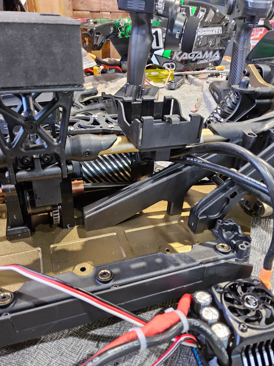

Kagama Hi all,just ran up the new motor and have a very bad vibration from the rear prop shaft,it looks like its bent.this is on a brand new never run kagama

No, that's not my problem. Vibration was first noted without any front or rear dogbones installed and has been identified as a factory-fitted bent rear drive shaft (from center diff to rear diff). I have removed and straightened the shaft, and all is running very smoothly now.
A bit disappointed with Team Corally shipping a new car with a bent shaft.
