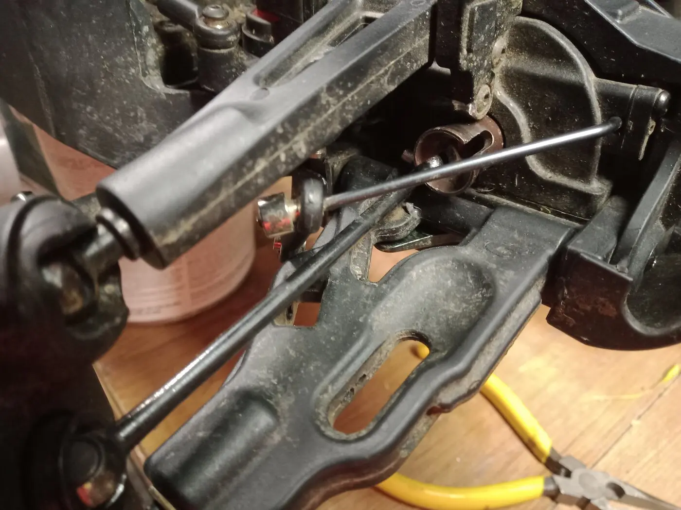

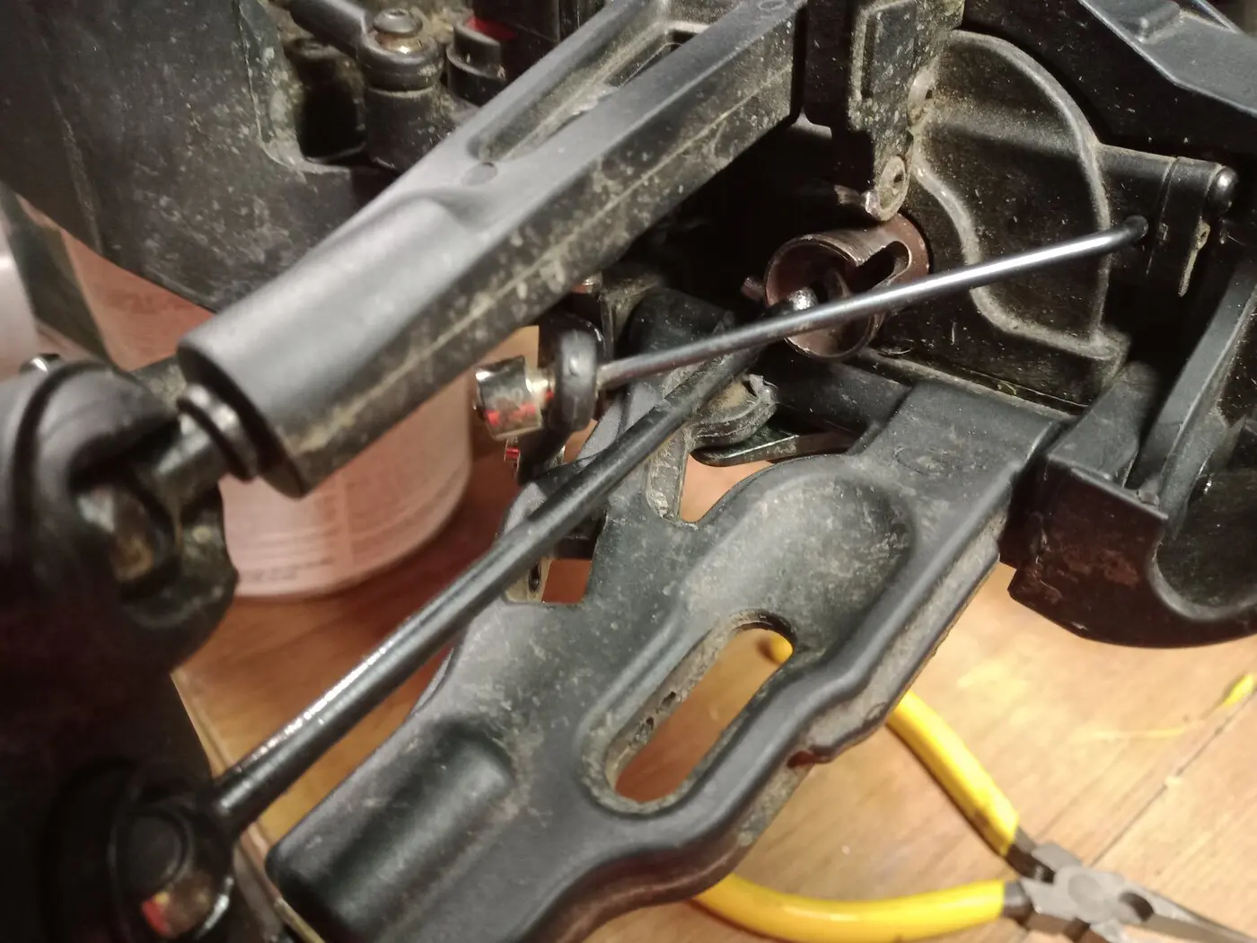

Hey all,
I knocked my dog bone out of the cup. I removed the camber link. What's the next step? I assume to remove part of the arm? Top or bottom easier?
Thanks in advance and Happy Thanksgiving!
Hey all,
  • Remove the wheel
  • Remove the upper arm hinge pin.
  • Check the dogbone isn't bent.
  • Straighten if it is.
  • Replace dogbone.
  • Reinstall upper hinge pin
  • Replace the wheel
Thank you! How do I remove that upper hinge pin? Do I need to start by taking off the front bumper? Sorry I'm inexperienced with TC and pretty much an RC noob to begin with.
The upper arm pivot pins are held captive by the plastic pills in the shock tower, so you need to remove the 4 screws shown here.
