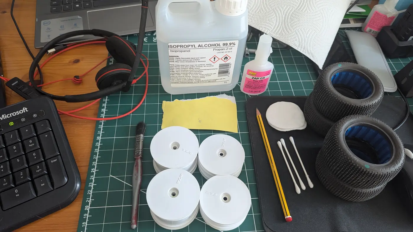

The best tyre glue is aerospace grade cyanoacrylate - super thin.
Zap
It's super thin - thinner than water - and requires very careful handling. It will invisibly coat everything - your bench, tools, fingers etc! 🤣

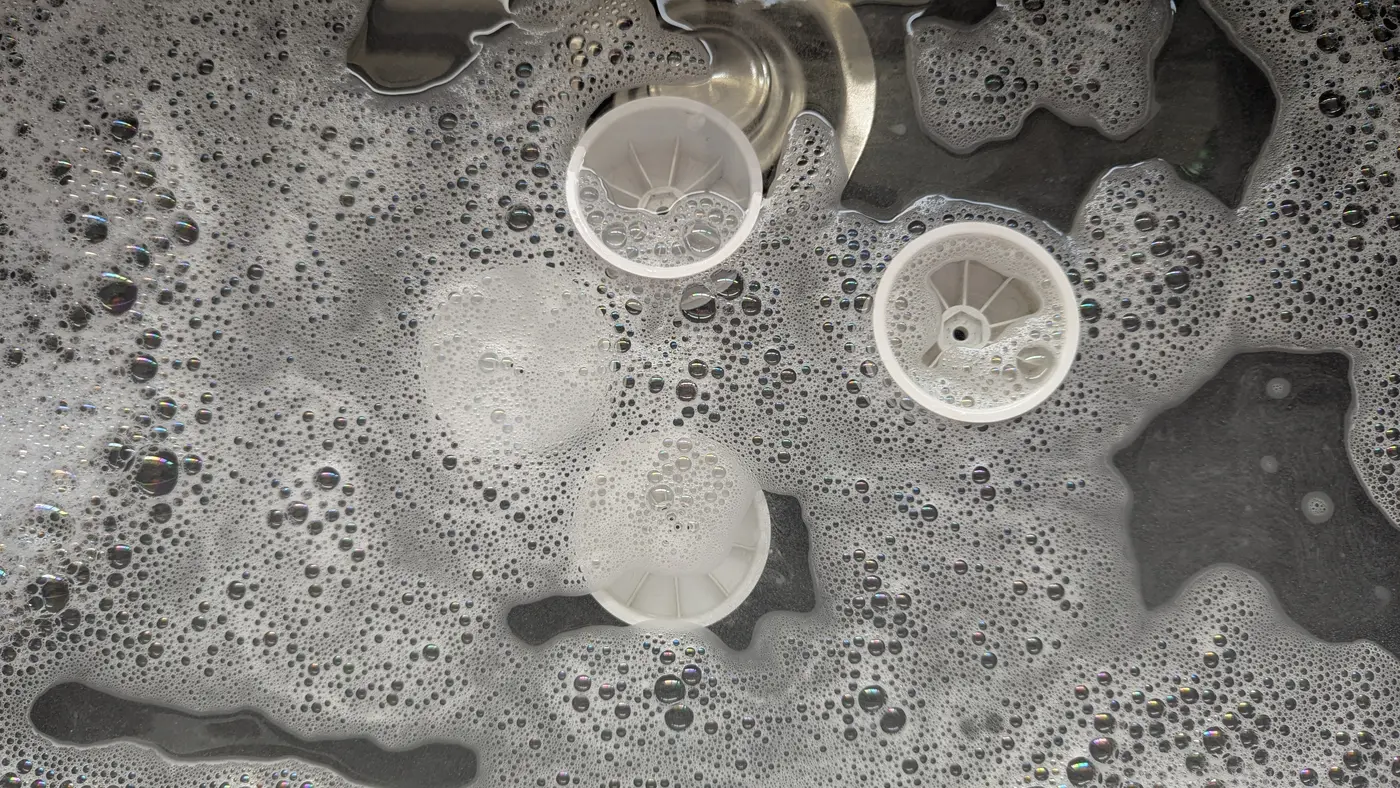

Surfaces to be bonded need to be cleaned in detergent to remove any residual mould release agents and then 'keyed' with a light abrasive.
The quality of the bond is all in the prep.

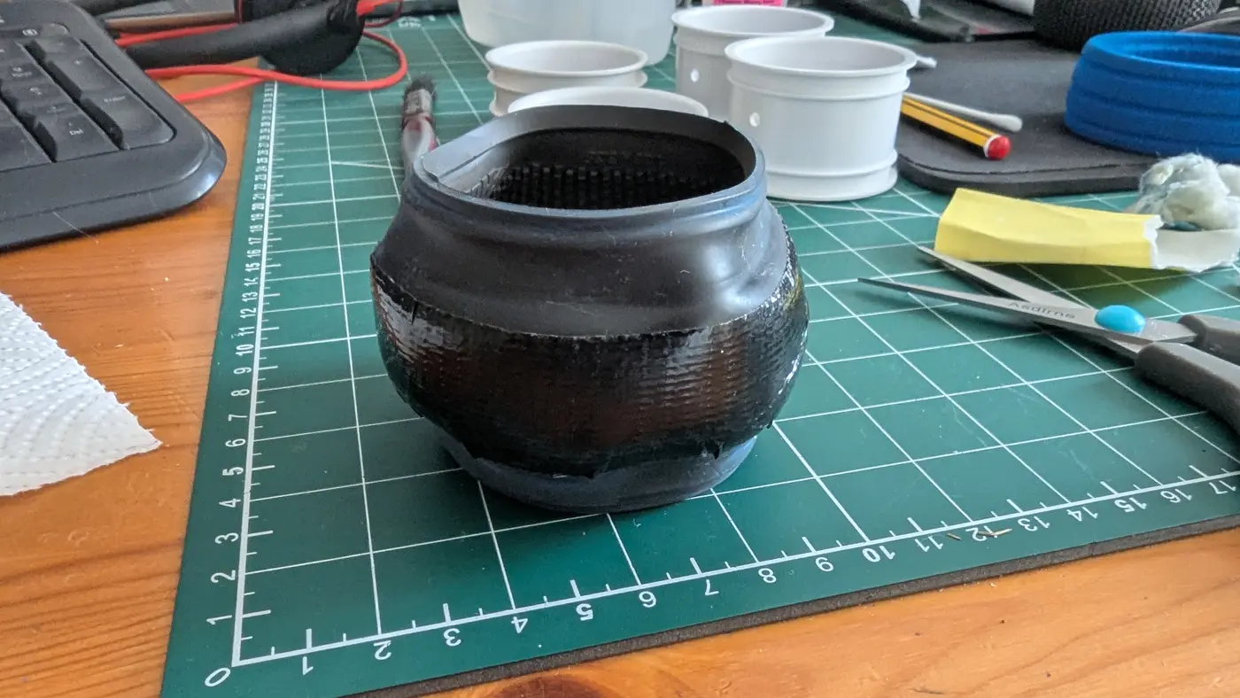

In theory, you can still boil off the tyres without destroying the wheels or inserts.

When the tyres are worn out but you want to re-use your wheels and inserts, with cyanoacrylate glue you can usually release the tyres by boiling them for a few minutes in a pot.

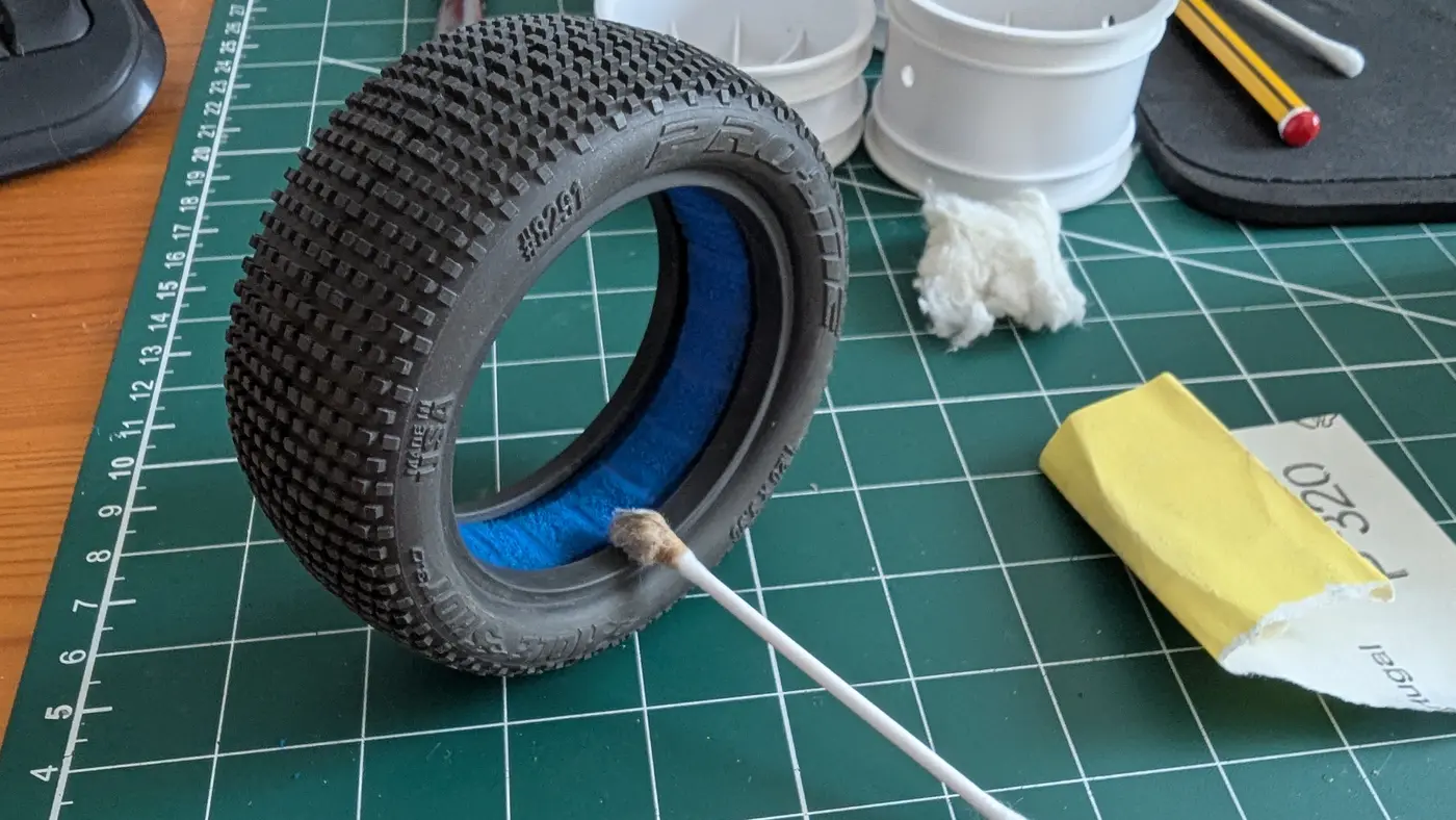

I ended up using Bob Smith Industries super thin CA and ruddog ultra thin steel tips. First try I got a lot of seepage out of the bead but I figured out if I filled the bottom of a saucepan with 1/4" of acetone and dunked the bead in and then scrubbed it with a toothbrush it'd come right off. For less thick oopsies the corner of a microfiber cloth soaked in acetone works well. It won't get into the bead unless you soak it for days or are trying to peel the bead back to let it in. In the future I'm going to try removing any seepage immediately with a microfiber cloth and acetone.
