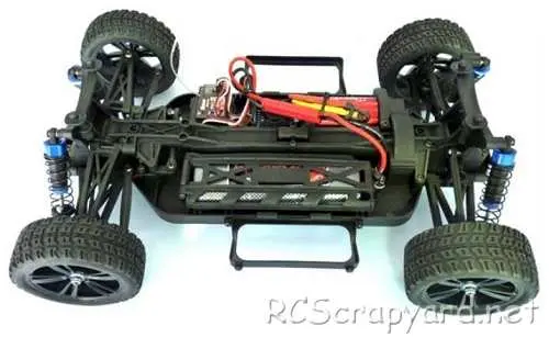

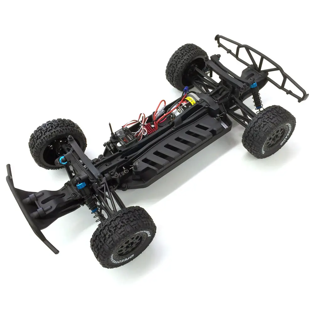

Well if it is any help with that the Ecx 4wd was made and designed by Himoto and is based off their E10 platform. Some of the parts work but I know for sure the chassis, center drive shaft and the slipper assemble will not work, the chassis and center driveshafts are different lengths and the slipper is designed differently as well as the diff outputs that go to it and the center driveshaft. IIRC the a arms, shocks, shock towers and f/r driveshafts fit but do not quote me on that.

@slick2500 Thanks man, that's some really helpful information! I'm in the process of doing some updates/upgrades to it...went to the hobby shop this weeken and picked up a set of new Proline tires for it. I also just picked up a new Arrma Senton 4X4 550 brushed. My son & I took both trucks out today and surprisingly that old Dynamite motor is just as fast if not faster than the 550 in the Arrma! I'm really liking the Torment more & more. I plan on getting new dog bones for the Torment next, as well as a new body for my Mammoth and the Torrent.
