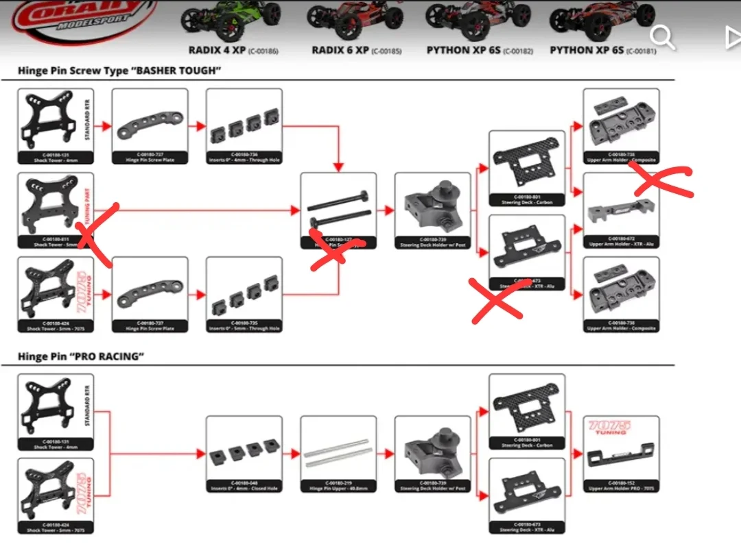

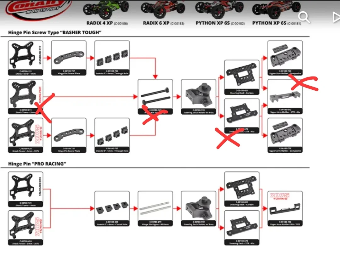

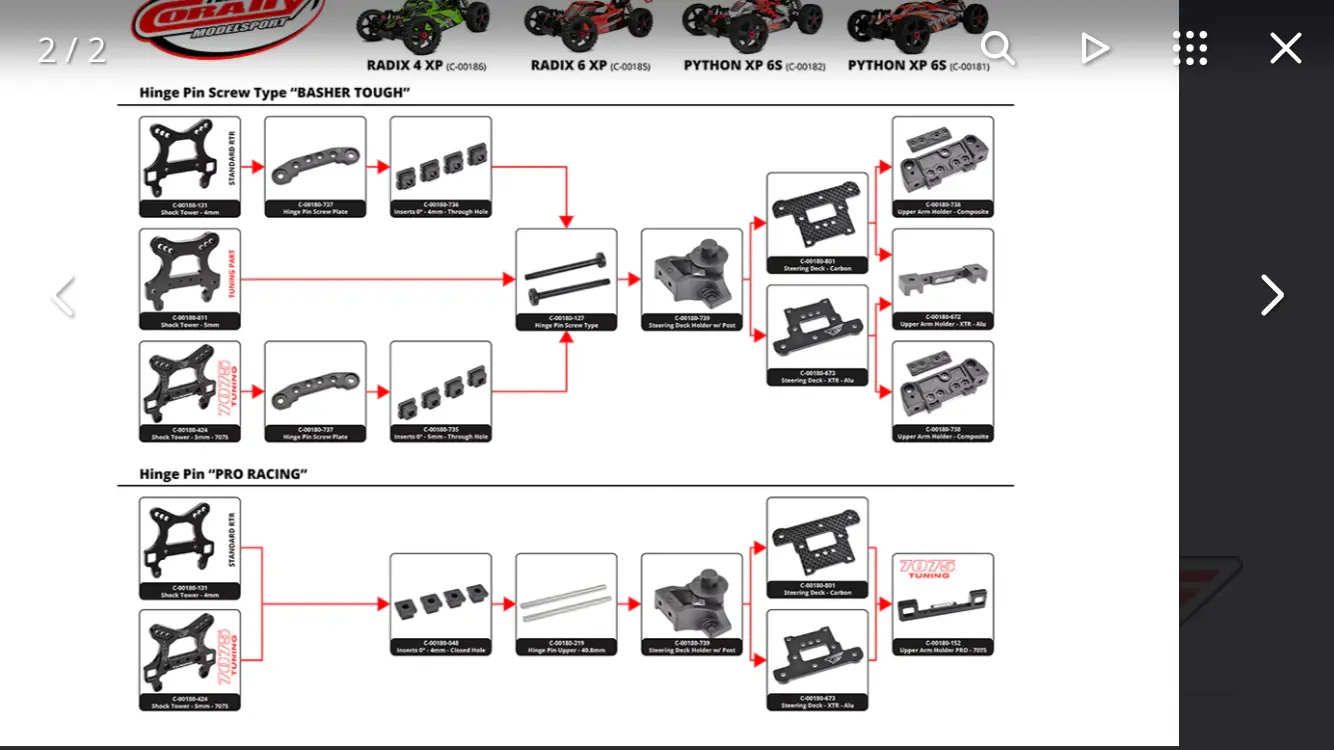

Yes but need to change the top deck & upper hinge pin holder also basically fit the xtr parts. Pick the parts listed in diagram just make sure select correct inserts for whatever shock tower you have fitted.
That was quick work cheers. For my pteference looks like I need the XTR towers, top plate, hinge pins and hinge pin holder too then as I'm not a fan of the rubber inserts on a basher
Yes just not that shock tower that’s for buggy try an rc breakers like jennys rc or RCSpares might find bits cheaper.

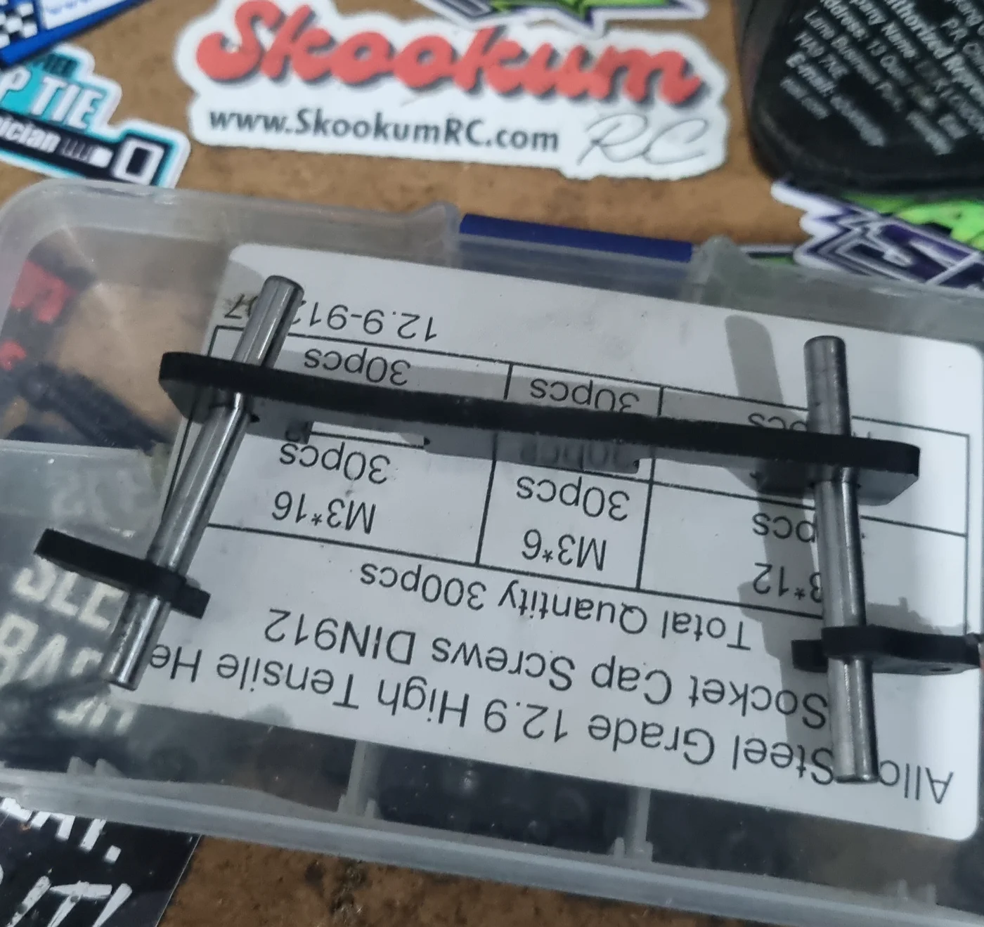

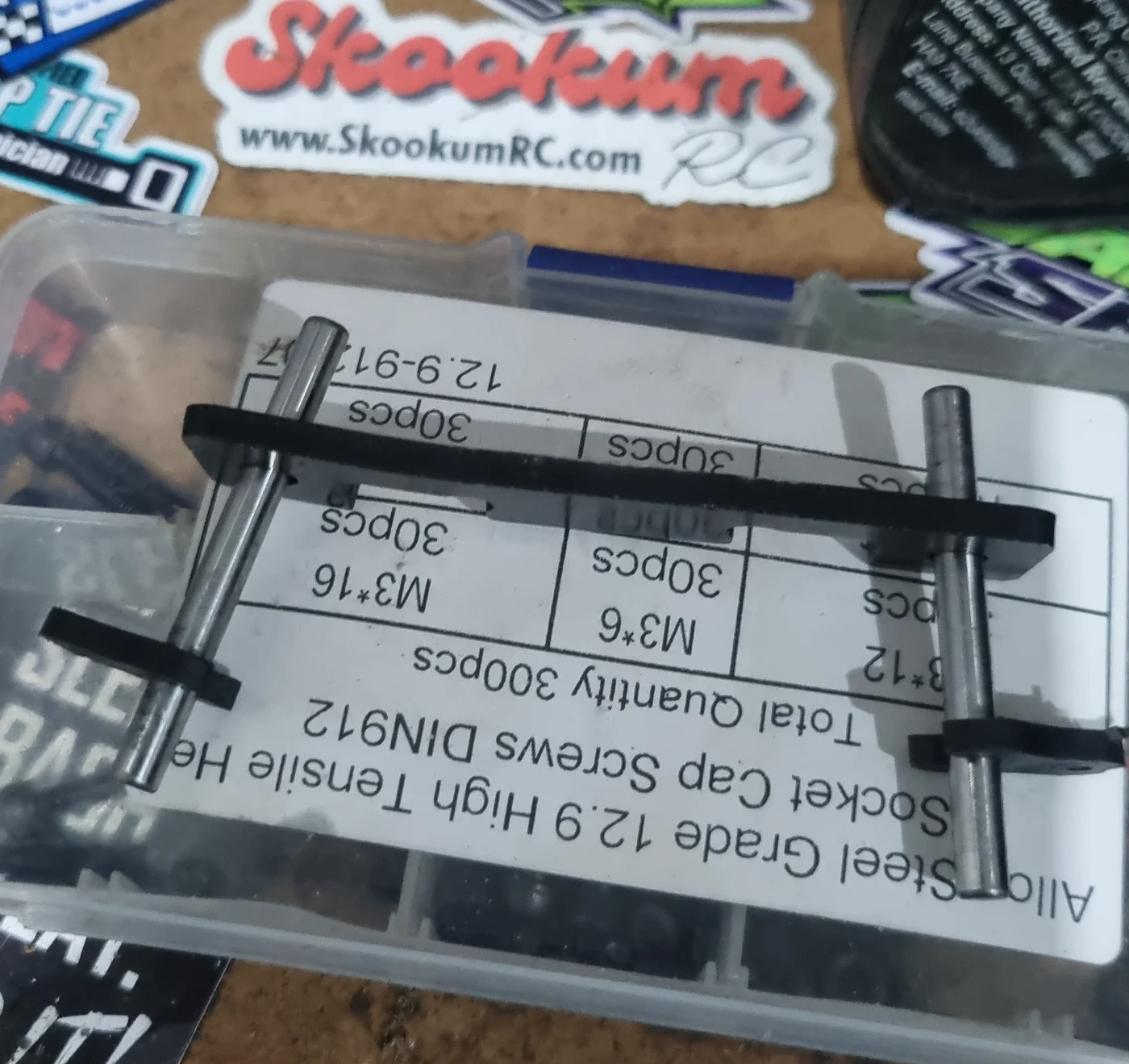

Kronos xtr shock tower & maybe don’t need plastic bit either it seems not fitted on mine but I do have it fitted on my buggy idk 🤷 maybe best get it also better looking at it than for it
