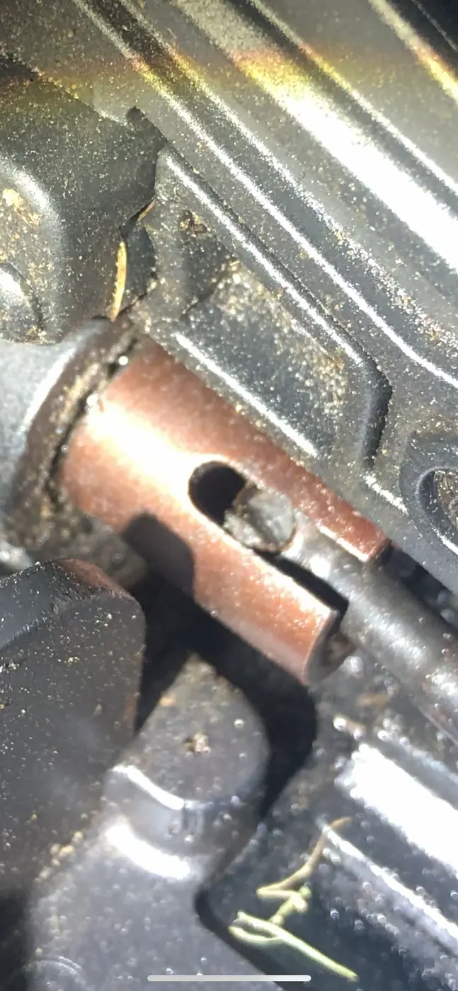

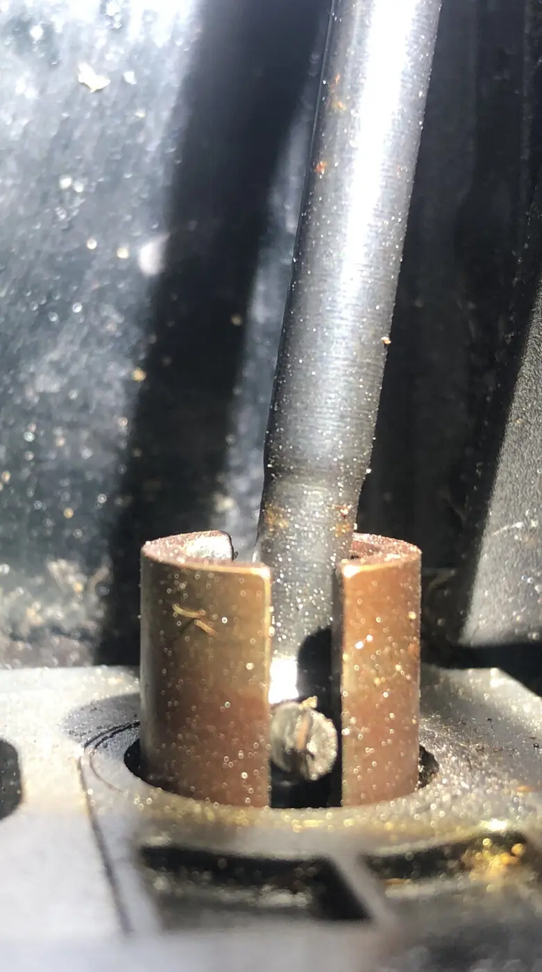

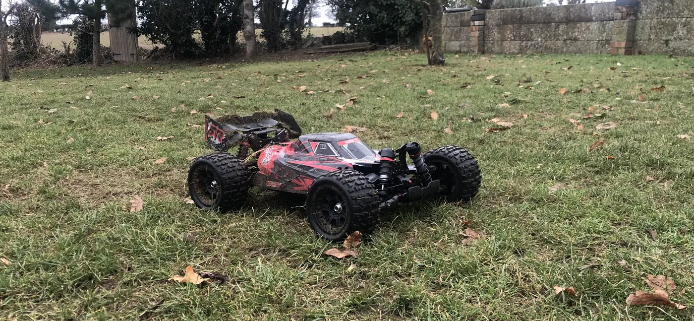

fixed at last and out she went. 4s . 17t pinion , smooth , quiet , fast enough in my garden , outstanding handling too . i see we are getting Louise tyres in the uk soon , so gonna try the pioneer and uphill version . i lowered the rear wing and i think she looks great , on a side note the centre drive shaft pins are worn half way thru
I would replace those driveshaft pins ASAP, you can buy a driveshaft pin tool which allows you to easily and cheaply replace the pins rather than buy a whole driveshaft.
Since the pins are so worn, they will likely be causing excess wear to the diff cups too.

All done 👍🏻
FFS what kind of pin damage is that?
Just wear n tear I suppose 🍻
