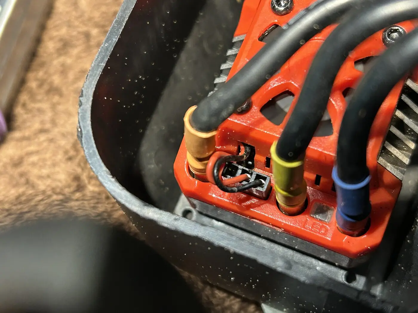

Also in the picture of your ESC showing the fan plug it does appear to be you had it correctly plugged in. If you look in the picture I attached you can see they label which wires go where. Black to ground(-), red to positive(+).

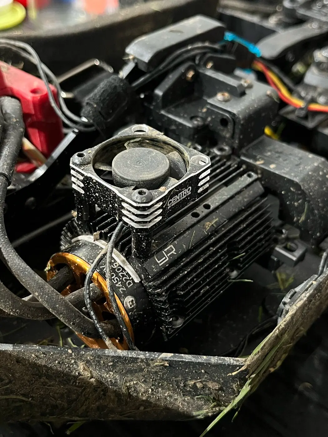

Here is the setup I have on my Asuga, it’s a Yeah Racing dual fan heatsink with 2mm PC thermal pads to improve heat conductivity and a Centro 30mm fan.

Thanks also for the image insert. I hadn’t actually plugged the fan into the ESC, but into the receiver. The ESC on the Sketer comes with. fan attached. I had thought of plugging the extra (motor) fan into this ‘outlet’ to see if it works, but I think it’s supposed to be on Channel 3 of the receiver?

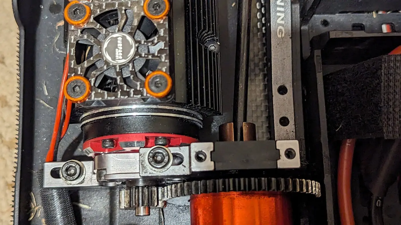

Surpass hobby finned twin fan mount and carbon fibre fan plates, fitted with countersunk washers.
The fan wires are plugged into a spare channel of the Rx with a Y lead. No need to plug them into ESC then. 👍

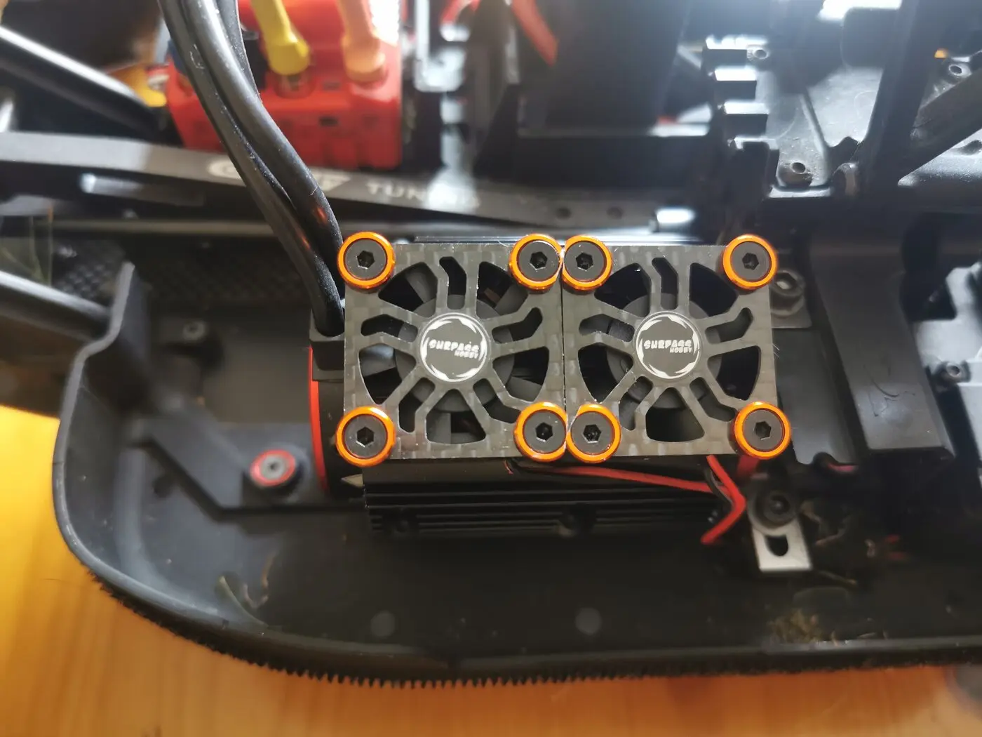

Dual fans fitted on the finned mount now on the 4292 1780Kv motor.
