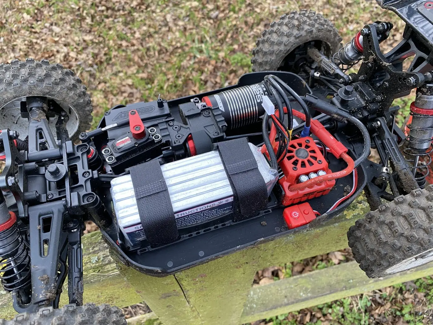

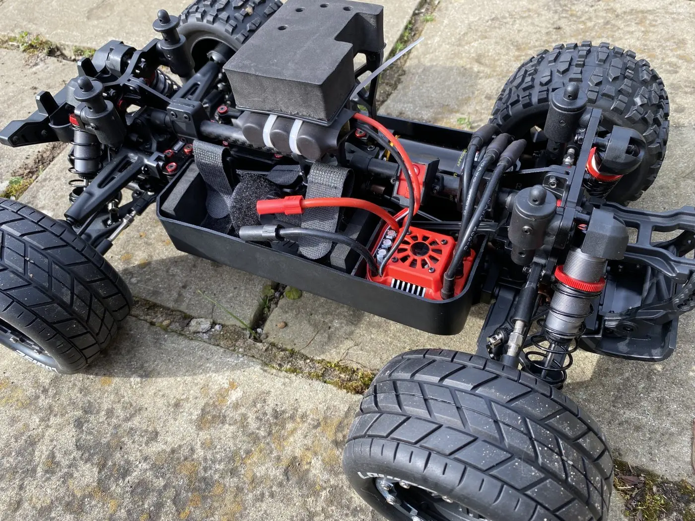

If you look at my pics above, I have mine so you can't accidentally plug the wrong plug in.
