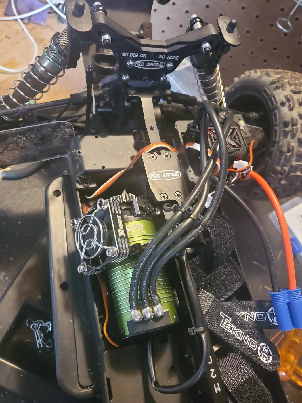

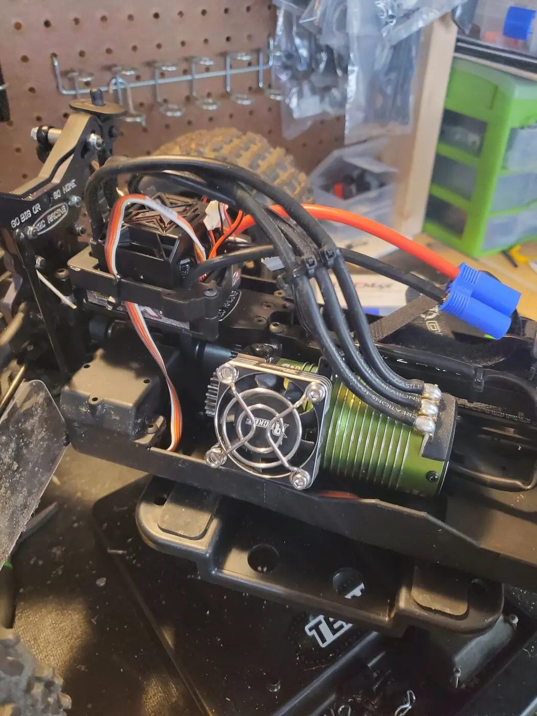

Finally really happy with the Sketer. Took a little bit, but she rips, and handles great. Was thinking about going wider with dementor arms for a bit...but not now.
With the wide hub kit, I have it set up with diffs at 100k/1mil/50k f/c/r.
Went through the shocks, topped off with 80wt fluid, set the rebound correctly.
Softened up the preload so whe will sit with the arms level when loaded with battery.
35kg JX servo
Power from Castle MMX 2200kv combo, 17t pinion.
BEC at 7.4v.
Backflip LPs.
Plenty of power, plenty of speed, handles awesome. Does not bounce around as much when running, soaks up the terrain.

Yeah, have a JX 35kg servo, MMX 2200kv combo. Same setup I have in the Sketer now. It rips. Run a 19t pinion in the MT

The Tekno only people must not like gast rigs. They all talk about 15t and 16t max with a 2200kv. Coming from Arrma....I like overpowered rigs. Ha.
I have all the M2C braces so added a bit of weight, but she is still quick and plenty nimble.

Those Shock towers look niiiiiice!!!
