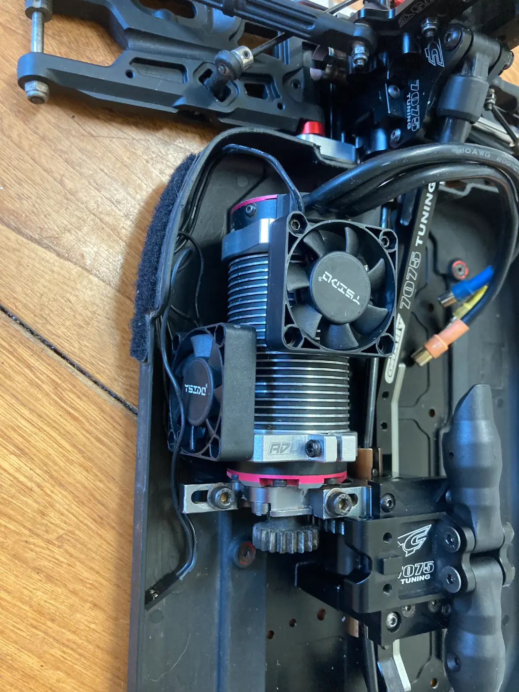

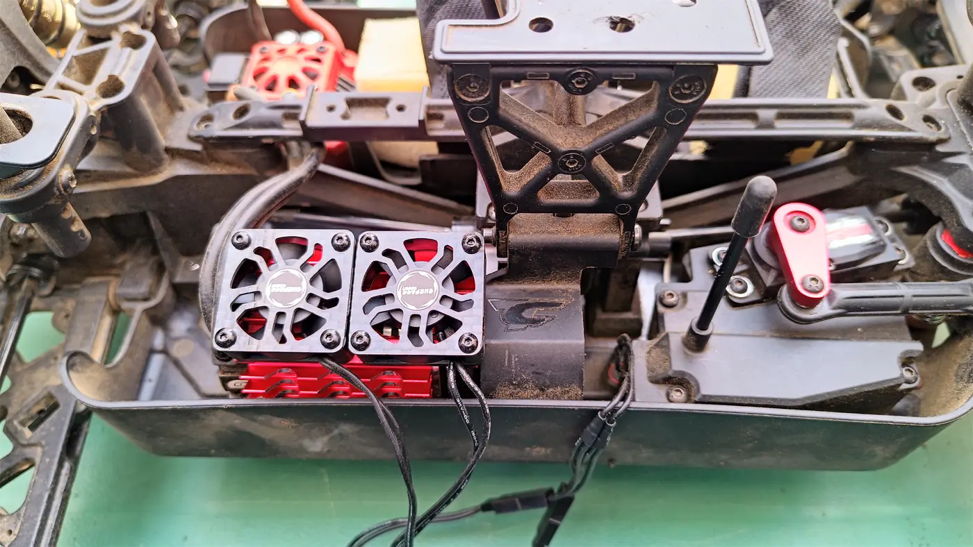

Your kagama 6 is the limited edition going by your previous posts it has a fan mount for 30mm fans. You could also use 30mm fans on your 4s cars maybe get them cheaper buying in bulk. I pick mine up on AliExpress but I prefer to use 40mm fans. Adu fan mount I’m using with mine

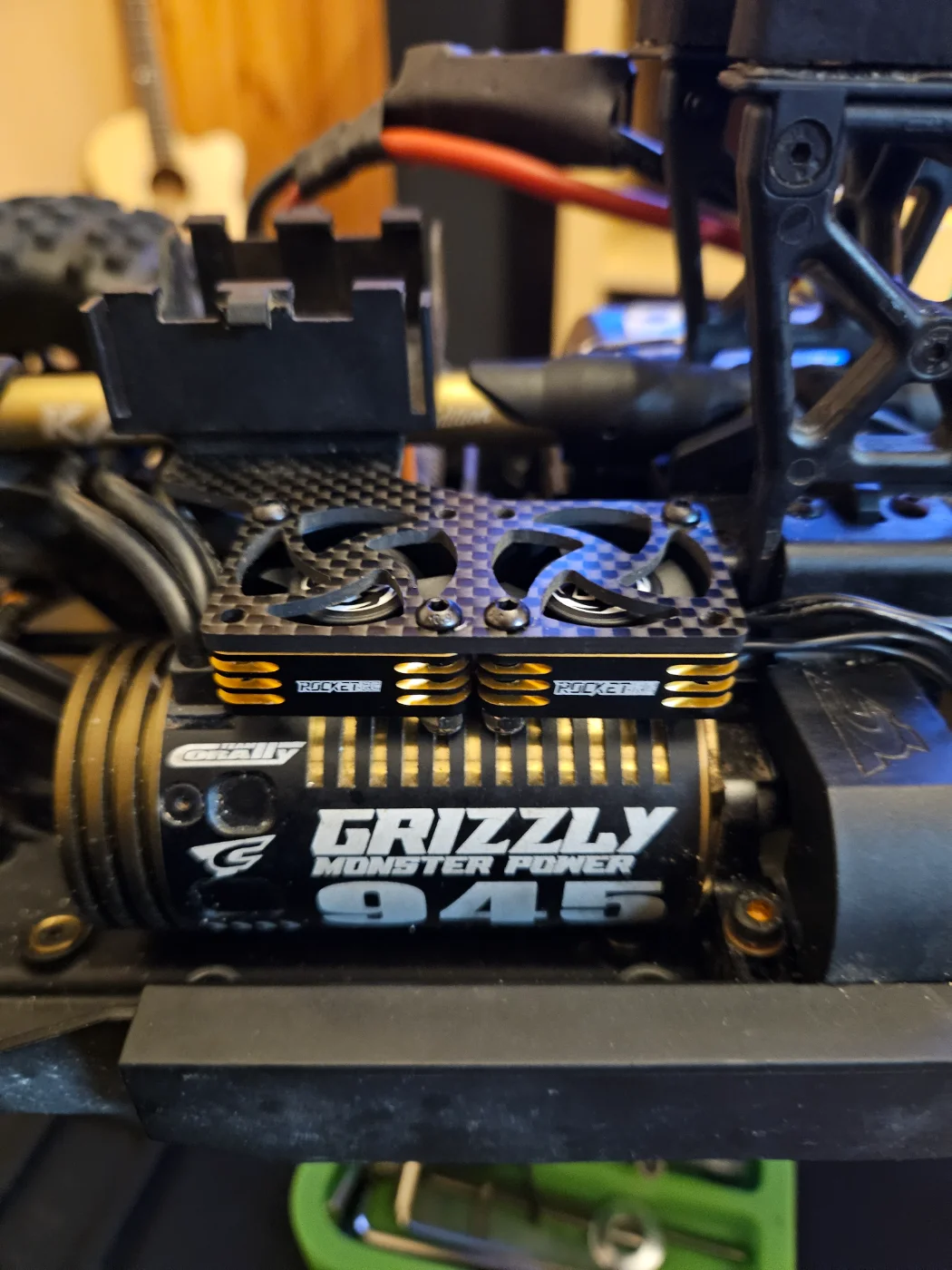

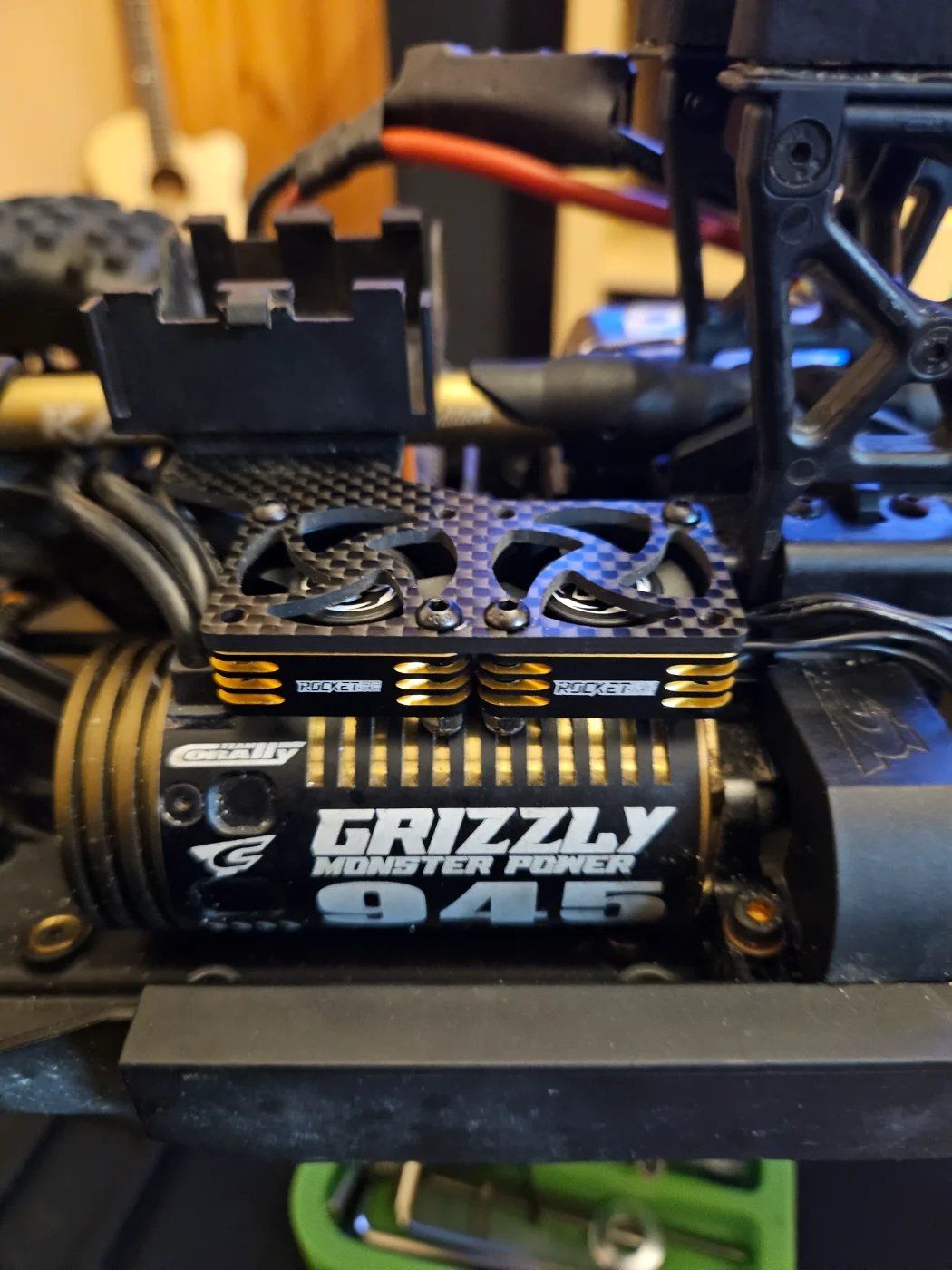

I love how you have mounted the fans on the LE!
I've seen YouTube videos of people mounting them on top, and I thought it was a bit strange. The way you have mounted them makes more sense.
Are they the Corally fans on the LE?

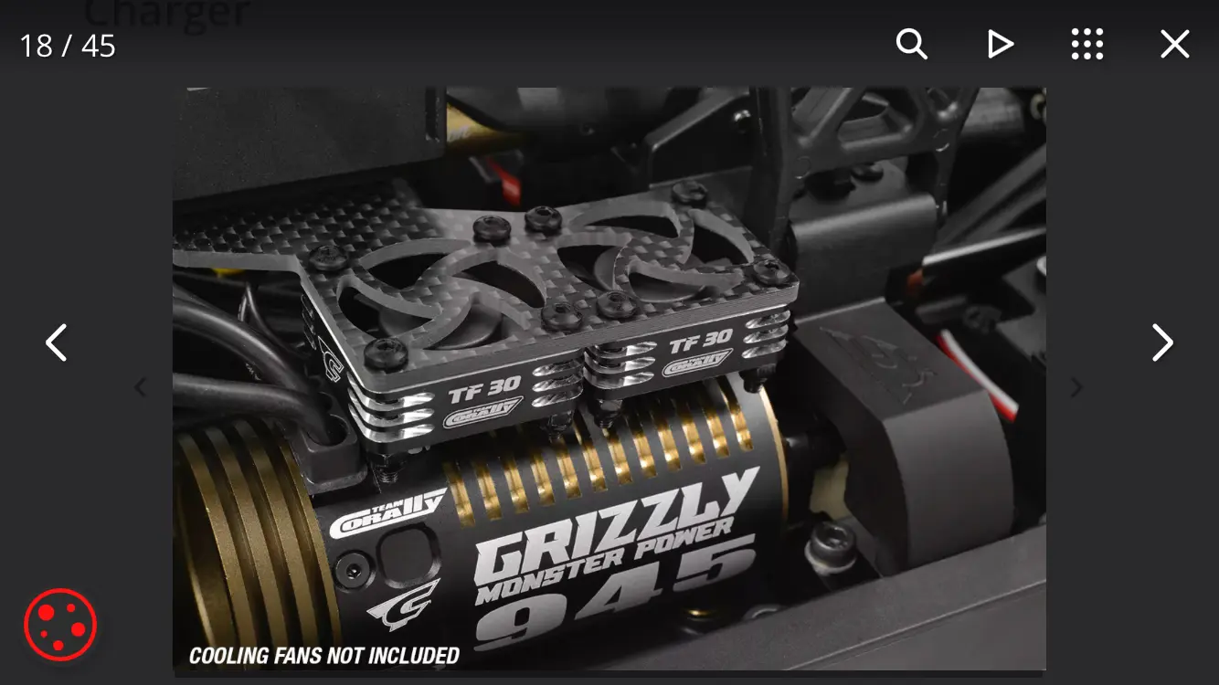

I don’t have an LE just stole those pics of corally site, but yes they are the corally 30mm fans. They all pretty generic you’ll pick up surpass hobby fans for cheaper , identical except for logos

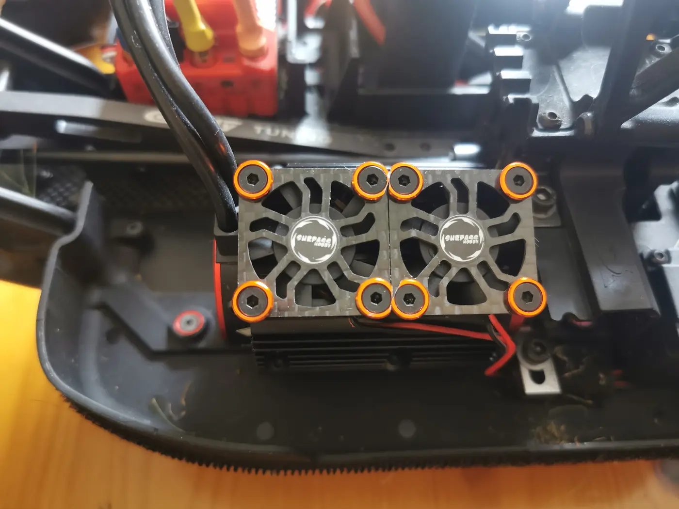

I used 2 fans and the carbon fan covers from a surpass dual fan clip on mount - but the actual clamping mount is a clamping Yeah Racing type (whilst exactly the same - unbranded) which is finned AND has gaps for air to circulate through and around the motor.
On my Losi 22X-4 Elite, which I really must get an ESC/Motor for, the cooling fans fit with one over the motor, and the other at the rear to exhaust hot air from under the body.

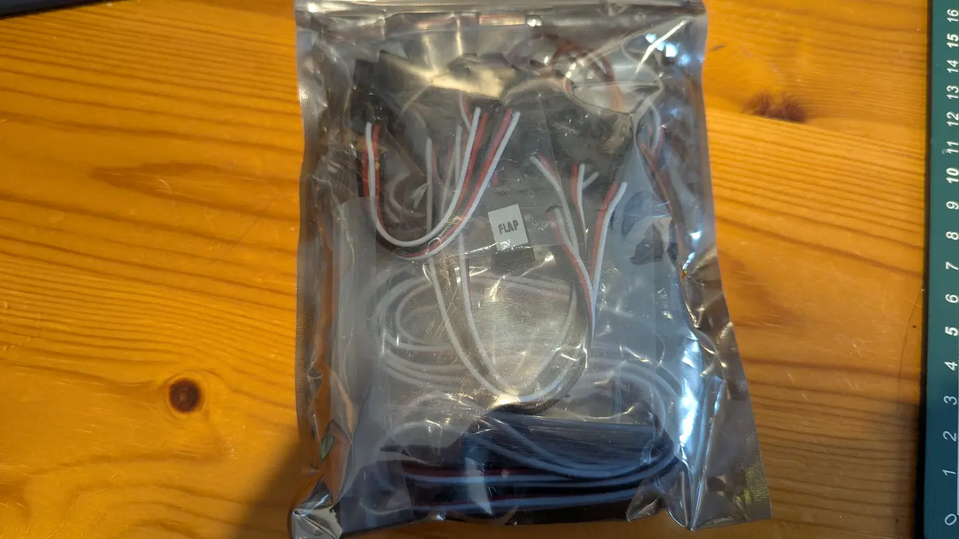

Y-lead:
Any online model shop will have them.
I've got a giant bag of them here somewhere, which I use with my large-scale planes.
