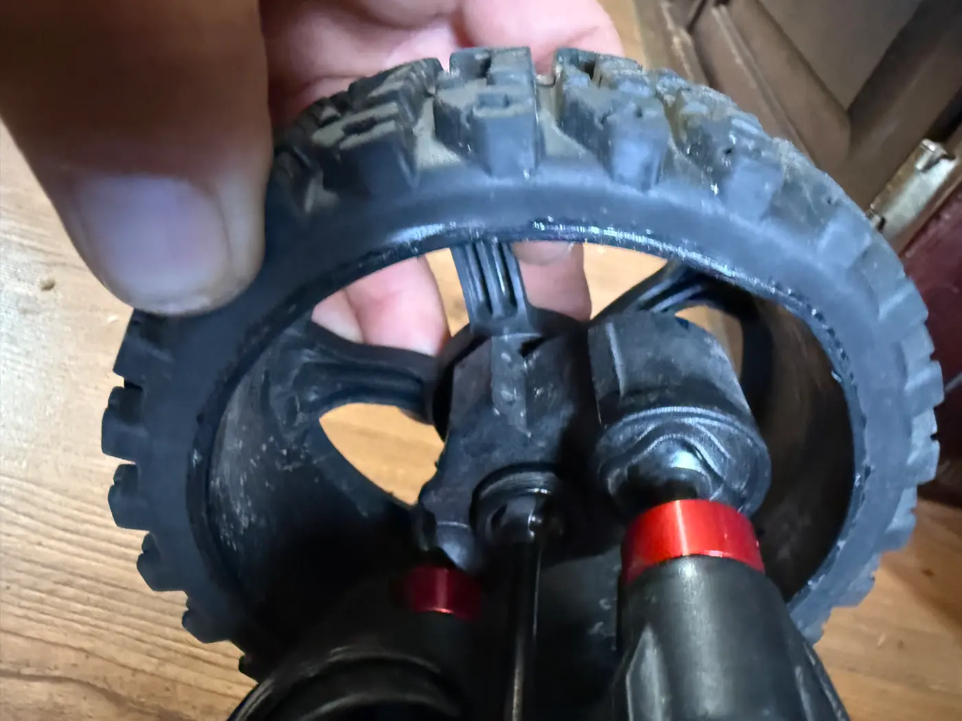

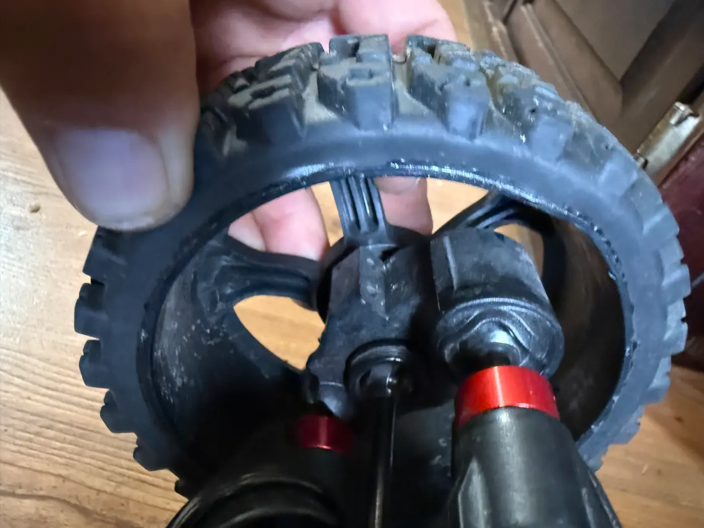

Its been roughly 4 years since I owned a radix6 so I can't remember if the stock servo was the same. But is the asuga servo not that great, I had a few small crashes today at low speed and I'm hearing the notorious crunchy sound. Seemed to insignificant to cause damage but it did, thanks

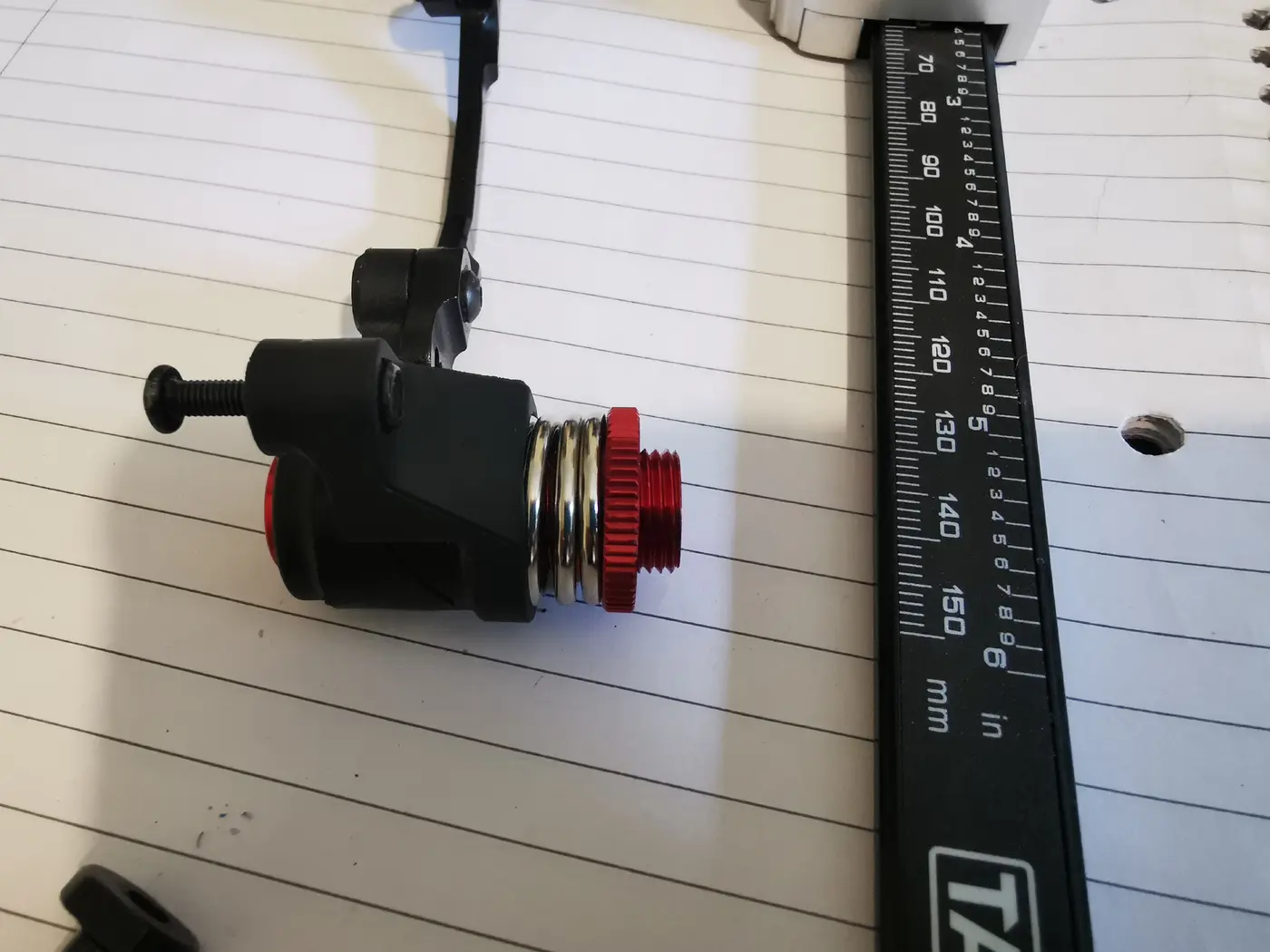

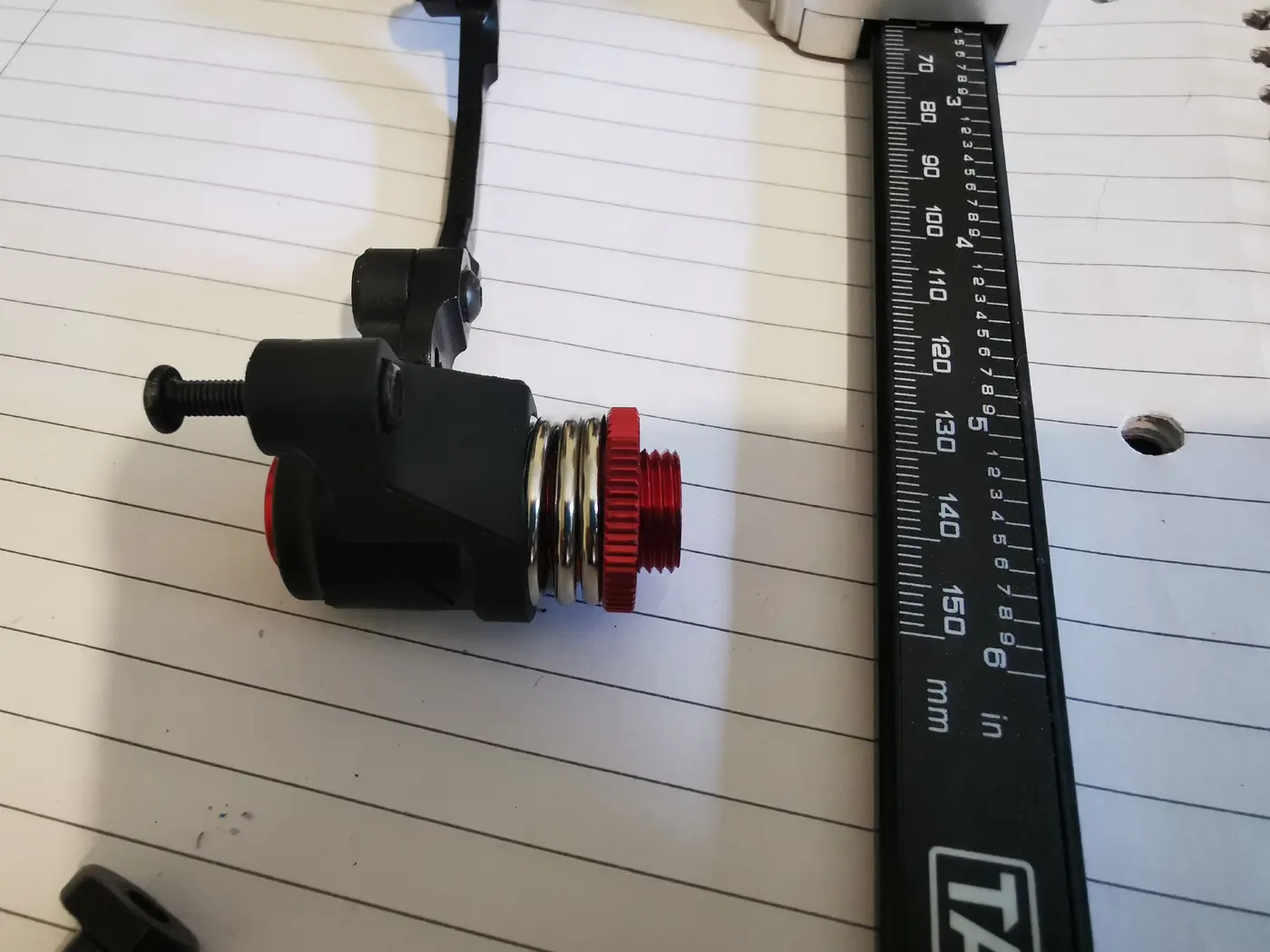

Many people tighten their servo saver all the way up so that there's no gap between the coils. This results in more direct steering.
Unfortunately, it also results in broken gears in the servo when you crash.
2 things:

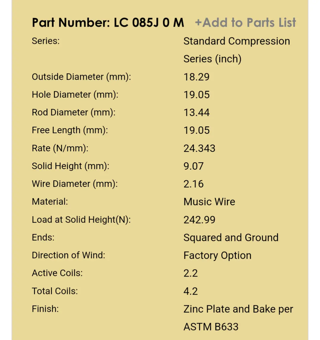

Upgrade your servo saver spring to a Lee Spring LC 085J 0 M
Buy a decent servo, such as an AGF 81BHMW, or if budget allows - a Protek 170 SBL.
Then you never need to give the steering any more thought. 👍👌
Clamping the spring most of the way down is not a solution - it's a straight trade - positive steering in exchange for no saving action whatsoever.

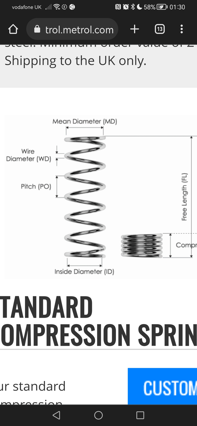

Speccing a spring is not as straightforward as you might imagine.

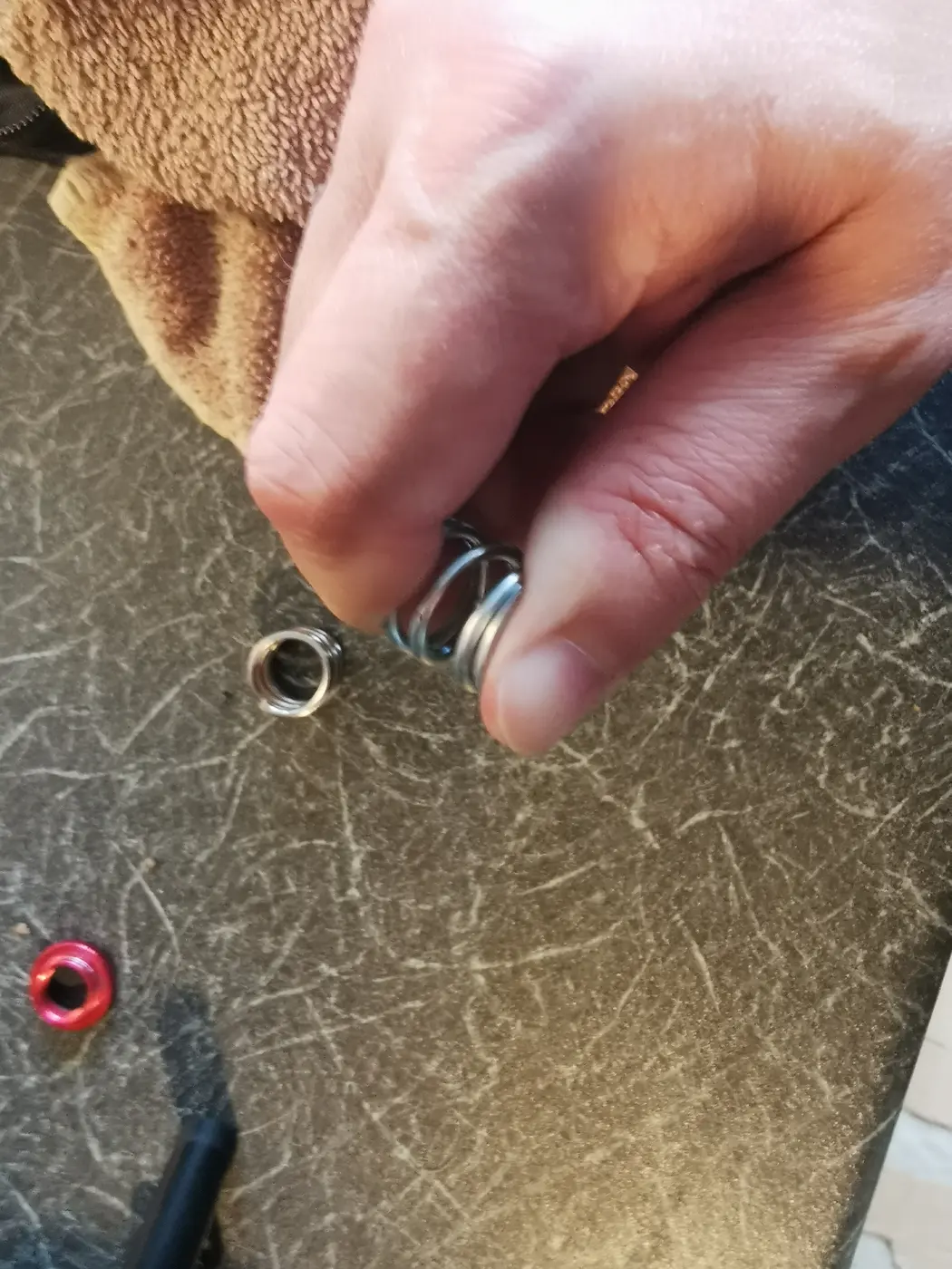

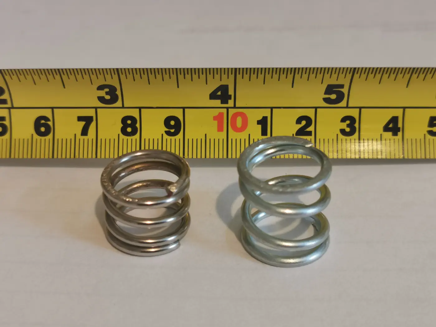

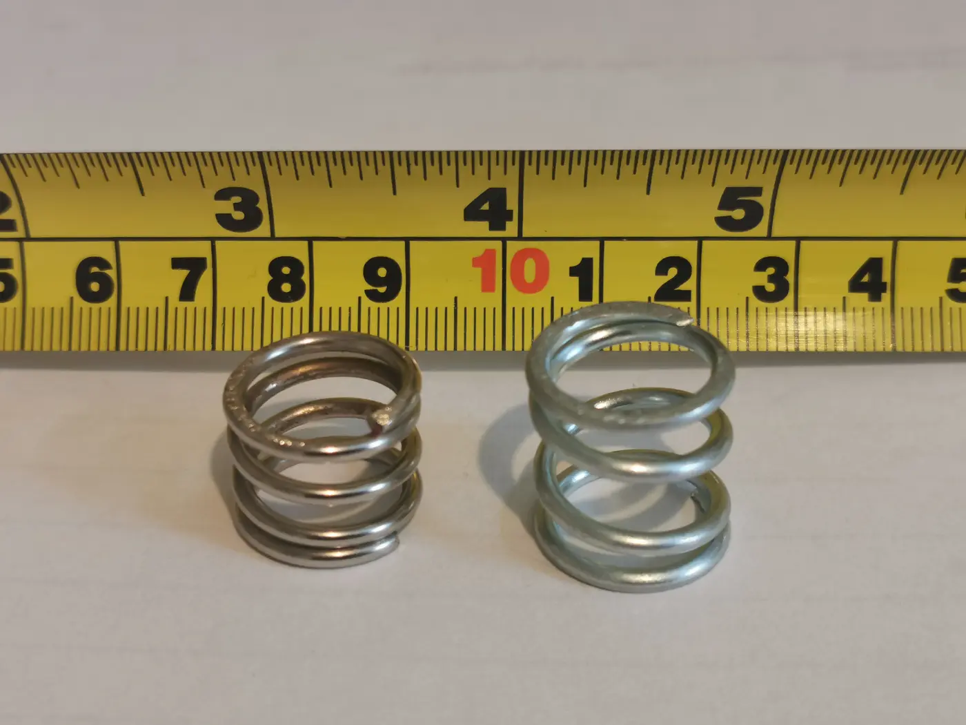

So here's the Lee Spring on the right.

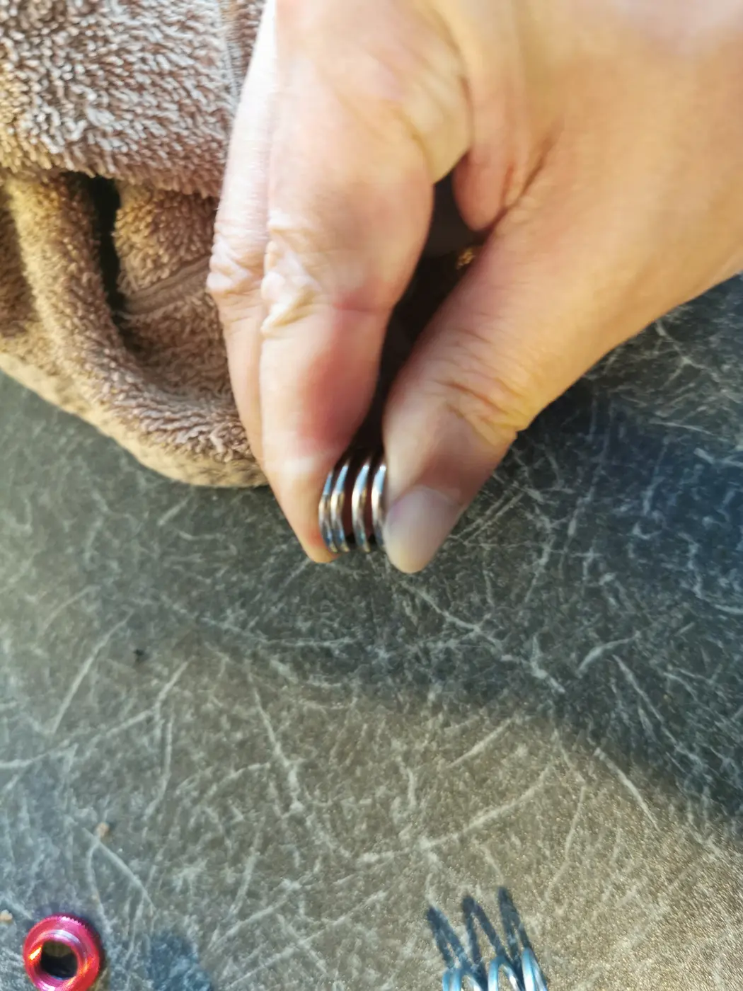

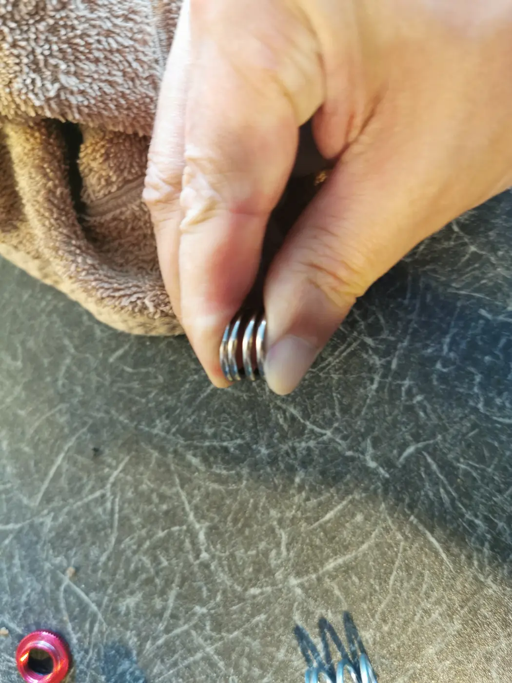

The stock spring I can fully compress between the tips of my index finger and thumb.
Not happening with the Lee Spring....23N/mm rate. This means that to compress the spring just 1mm, you need to apply 2.3kg of weight. Even though I have a grip strength of 50kg, I can't compress the spring anywhere near full compression.

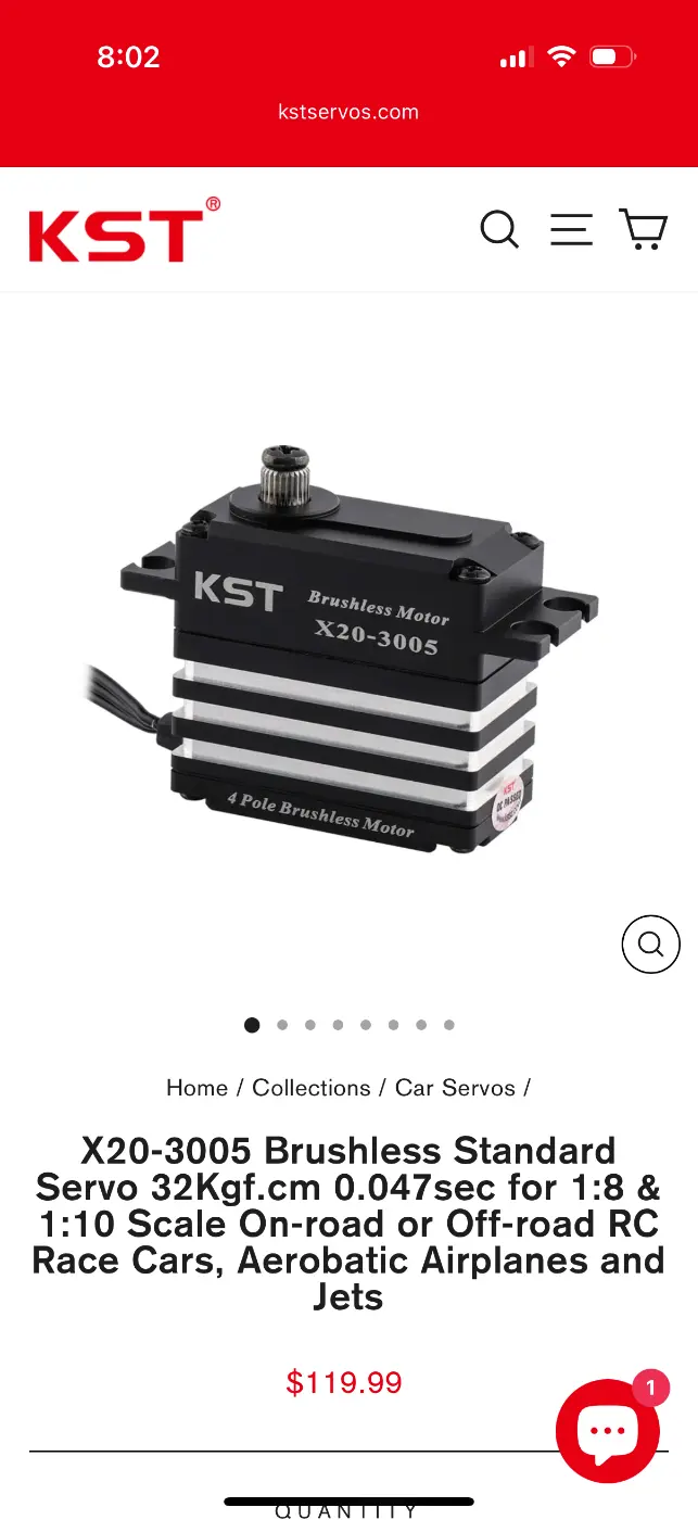

I just ordered a few I’m US $6.25 for shipping, I tighten my servo saver but haven’t to the extent of not leaving any coil space. So far my stock servos have been fine with a 50 mph crash straight on a wheel that deformed it of course breaking the lower control arm and shock lower. For servos I use KST for mine there high priced but are amazing quality

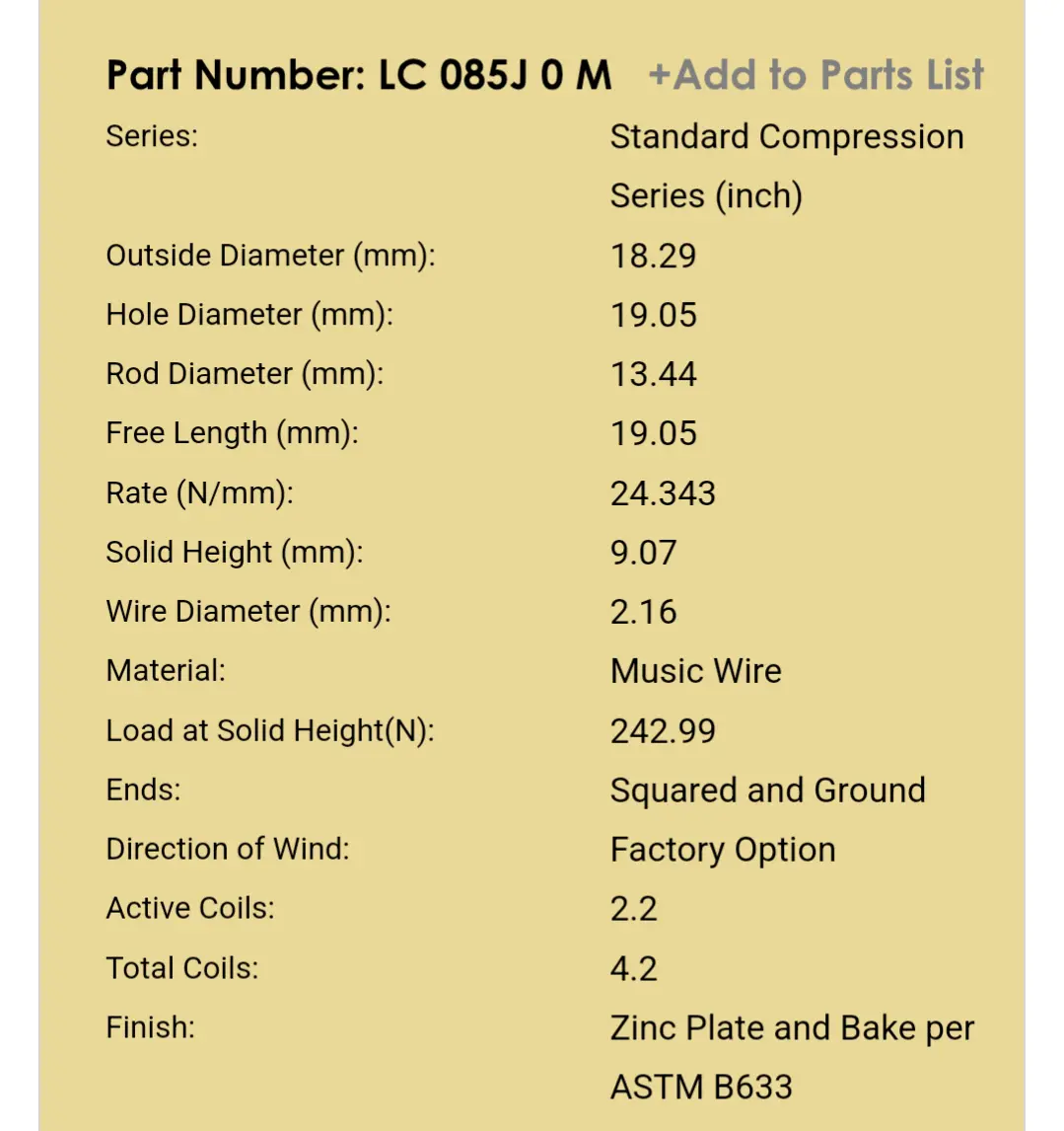

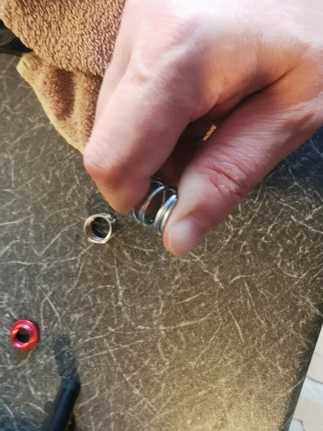

That lee spring sounds like the option spring for my mayako, it was so hard that I couldn't get the top assembly to compress it, so many in racing aren't using the springs any more. I think I'll save and look at an agf as suggested, I've read good things about them, I'm not keen on spending $200 on a servo though, I'll keep in touch if I have trouble with getting the spring down. Thanks 👍
