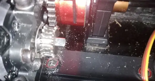

Hey all,
I took out my Asuga for its maiden run with the MAX6 G2 motor/esc combo. It was awesome...for about 3 seconds. I could hear a high-pitched whine just before I lost all power. I took it back to the bench and saw my 19t pinion had been chewed to bits.
Obviously, I've got some bad gear mesh. Is it too loose? Too tight? Is there anything else that could cause this? I'd used what I thought was a hardened steel pinion, but maybe not, given the results. Any advice on how to troubleshoot this is mightily appreciated. Thank you!
If it lasted 3 seconds, it was not hardened even with a bad mesh.
Difficult to see in the pic, but it looks like it may have been on the loose side.

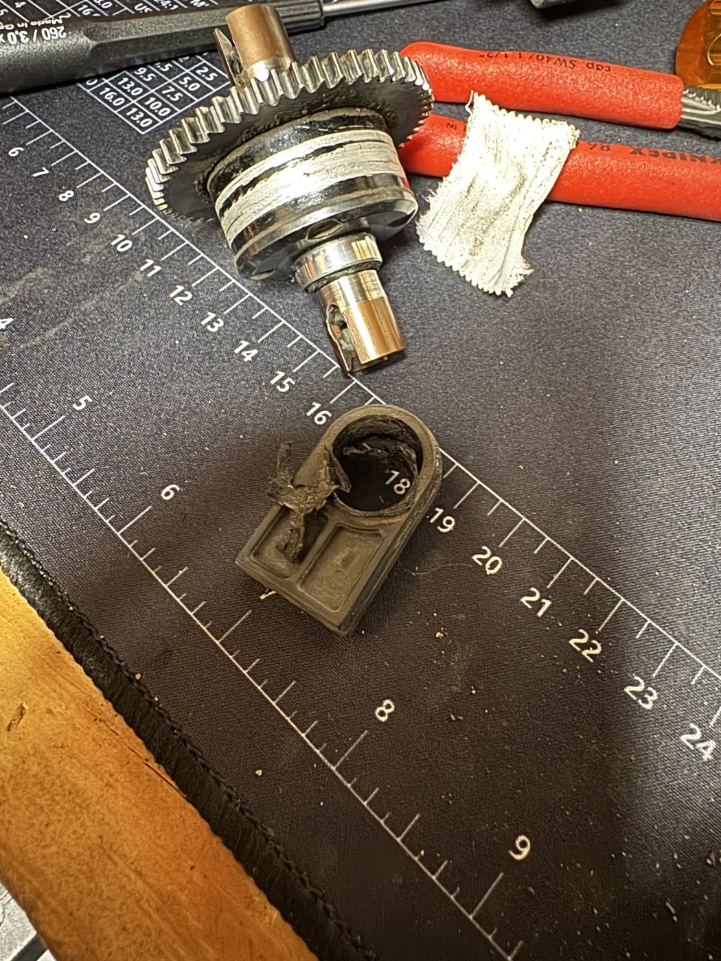

Sized bearing, under rotating, smoked the plastic consumable part, mesh was all over the place.
