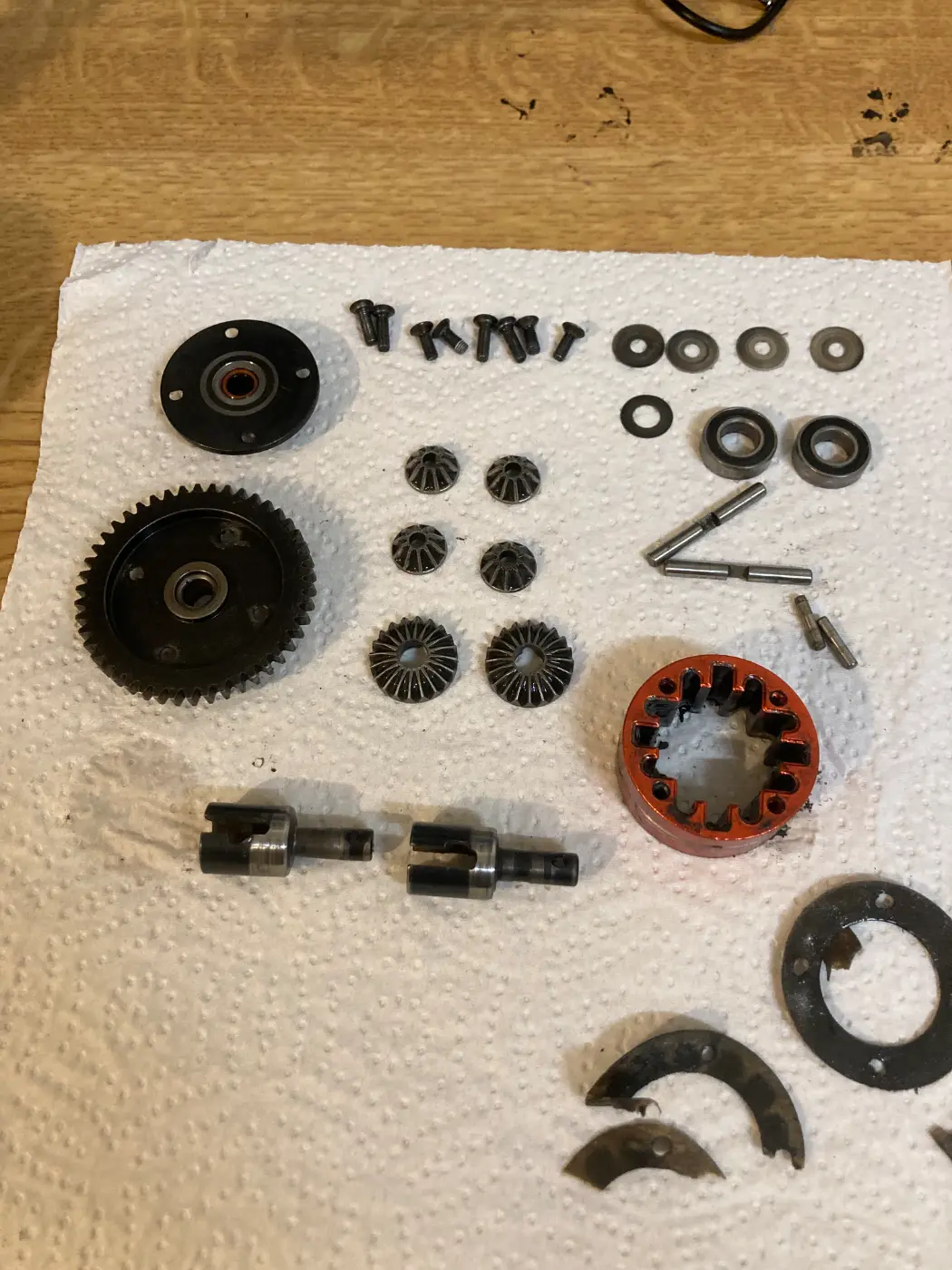

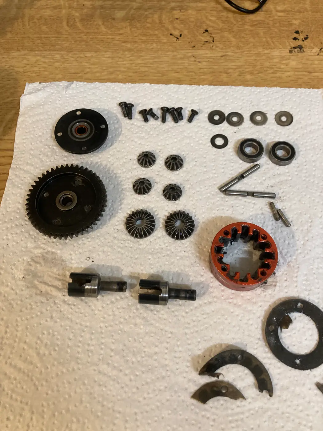

I agree that with your diff looks like both the Spur and the end cap are ever so slightly off centre, meaning that the diff sandwiched in between is eccentric. 🫤
When I flipped the center housing the other way then the end cap and center housing spun true with no runout. The spur gear in the video appears to wobble simply because the center section has runout with respect to the end cap and as a result so does the spur gear.

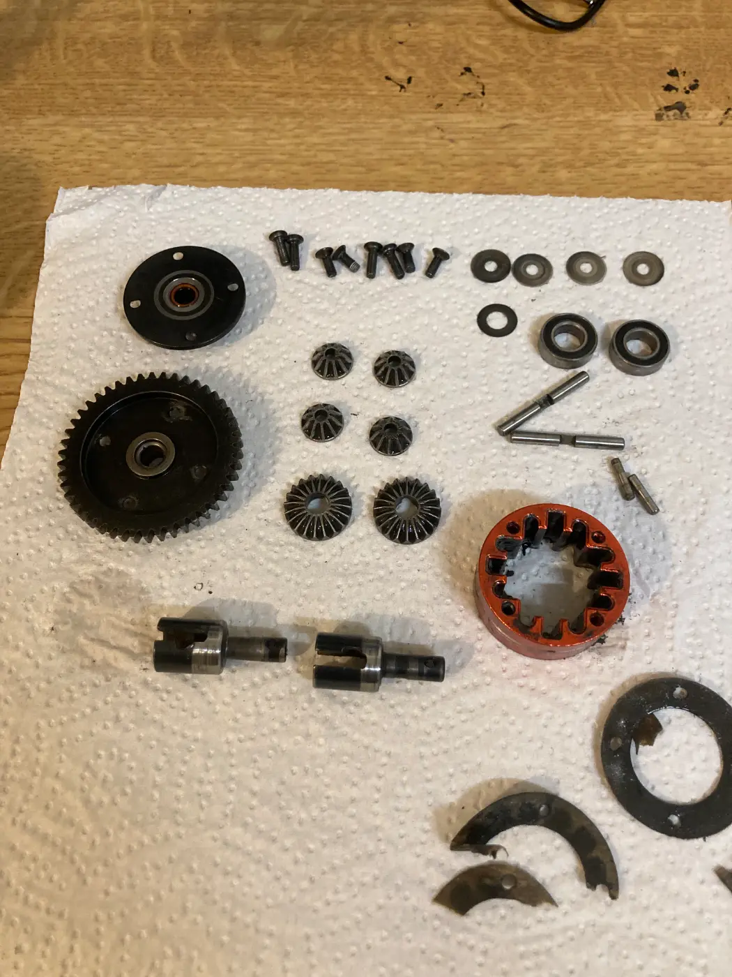

There is a very tiny amount of runout in the center housing, less than 0.05mm, but both ends are concentric. The spur gear rotates with no visible runout or wobble. EDIT this is only when measuring the outside of the housing with a dial gauge and does not necessarily mean the interior structure has runout or how much.
The screw holes in the new differential are machined differently than the old one, the old one had blind holes drilled on either side, the new one has screw holes drilled straight through. The manual shows that both sides should use m3x10 flat head screws but the old diff had m3x8 screws on one side due to shallower holes on that side. The red shade of the anodizing is also slightly different.
