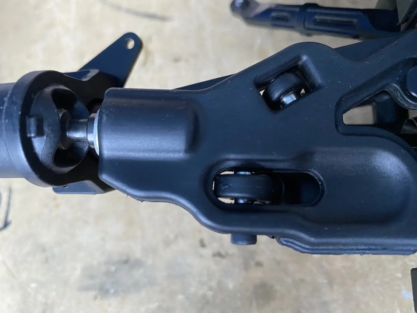

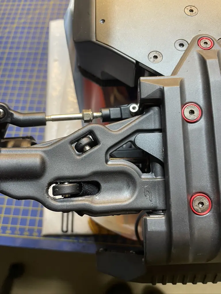

Just fitted HD shock ends ( C-00180-770 ) onto the Radix and noticed that when you use the outer hole on the arm the shock ends bind, it's quite stiff and will require a small amount of filing for it to not bind..!!
Just a heads up for all of you that will be fitting these on the outer hole..👍🏼
