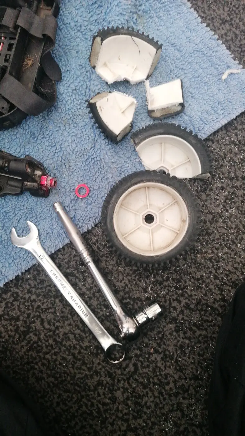

Never ever again am I gonna use blue locite to hold wheel nuts on, cos my blue locite jammed the nut up solid on 4 wheels, I got 2 off by force but I had to hacksaw the other 2 wheels off to access the nut & hold it to undo the wheel nut!! Never never again!
N. B red locite is permanent, blue locite should allow the wheel nut to rotate

FFS! There's quite a lot of blue loctite on there! 🤣
There's no need to put loctite on wheel nuts to be fair. Now you've learnt this from experience, it's not likely you'll make this mistake again.

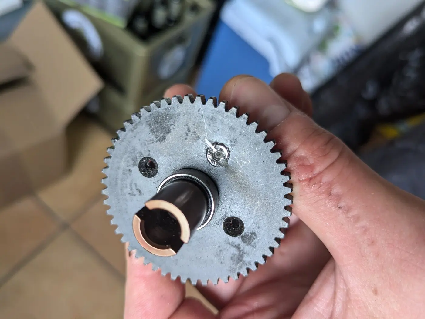

Another weird thing about loctite is that it builds up. This is especially annoying with pinion grub screws.
There's quite a fine line between 'staying together' and 'never coming apart again'. 😅
Never had problems opening the diffs. But this one from my Asuga is really bad. Never opened it before and i probably wont open this one either. Needs a replacement i think.
A 5% or higher carbon alloy bit (1.8-2mm) and a screw extractor have served me quite well. So far have gotten 3 11.9 grade steel screws out with them. Make sure to heat up before using the extractor to break the loctites bond.
