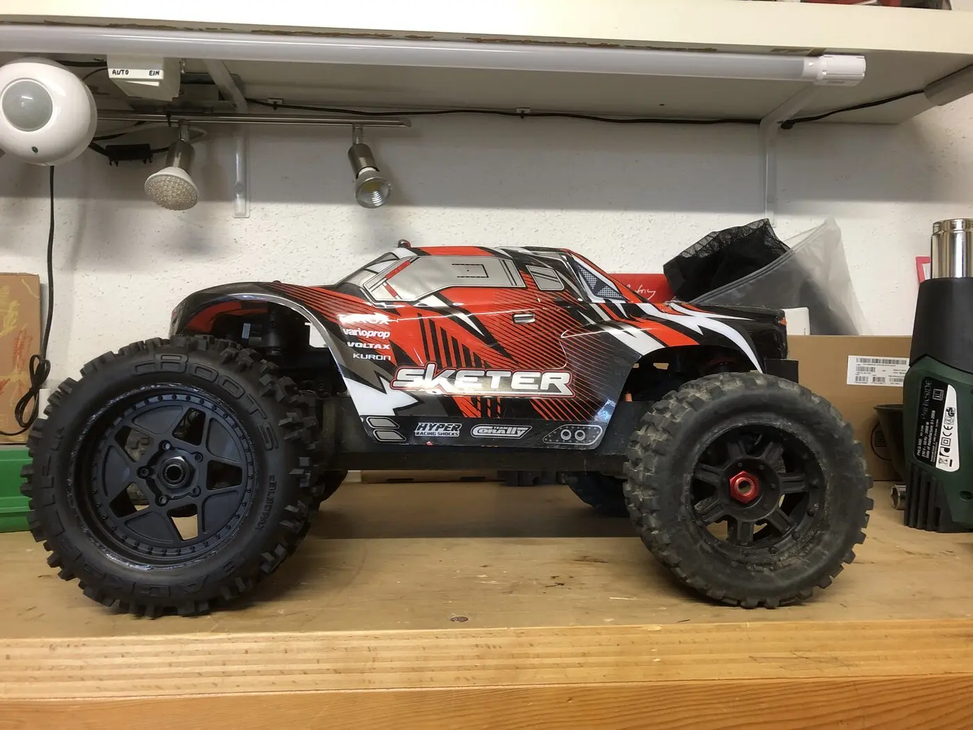

On my Sketer I have installed the dBoots Backflip LP 4S and I am very happy with those. Good performance, seem to be reliable (also often recommended in the ARRMA Forum) and for me they just have the right size/proportion (in between the stock tyres and the supersized Kronos tyres) to look good on the Sketer. Only thing to mention is that you have to do some widening as well … here’s a picture to compare (front dBoots, back stock):

Sketer stock tires have an outer diameter of 134mm, the dBoots Backflip LP 4S have 154mm and the Kronos tires should have about 170(?)mm …

You need to wide it by 30mm in total. The recommended way would be installing the wide hubs, but I did try the quick & dirty way by using hex extenders (if that will fail at a certain point I still can do the wide hub conversion). Here’s the full story:
https://www.corallyforum.com/threads/widening-with-hex-extenders-a-good-idea.349/
Yes, I still have the stock 13t pinion which with this tires has the same effect than gearing up to 15t and keeping the stock tires … top speed goes up from about 70km/h to 80+km/h 😎. In both cases the motor gets more stressed and therefore hotter, so I would recommend to install a heatsink+fan on the motor.
