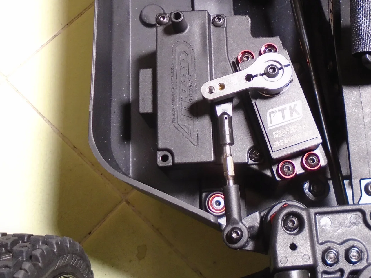

I solved the issue by replacing the plastic link on the servo side with one for a 700 size helicopter and a 5mm uniball from a heli swashplate. As the stock servo arm has no threads in the arm I had to use a generic 20mm aluminum arm I had laying around that has M3 threads to mount the ball.
Nice! That's a solid set up.
Here's how I did mine:
Also using a 5mm ball and anti vibration washers. However, I prefer a uniball that is drilled all the way through - because then I can use a lock nut.
With a revised servo saver arrangement, this would really benefit from a push/pull setup. All lovingly CNC machined in 7075 of course! It just has to clear the ackerman plate.
