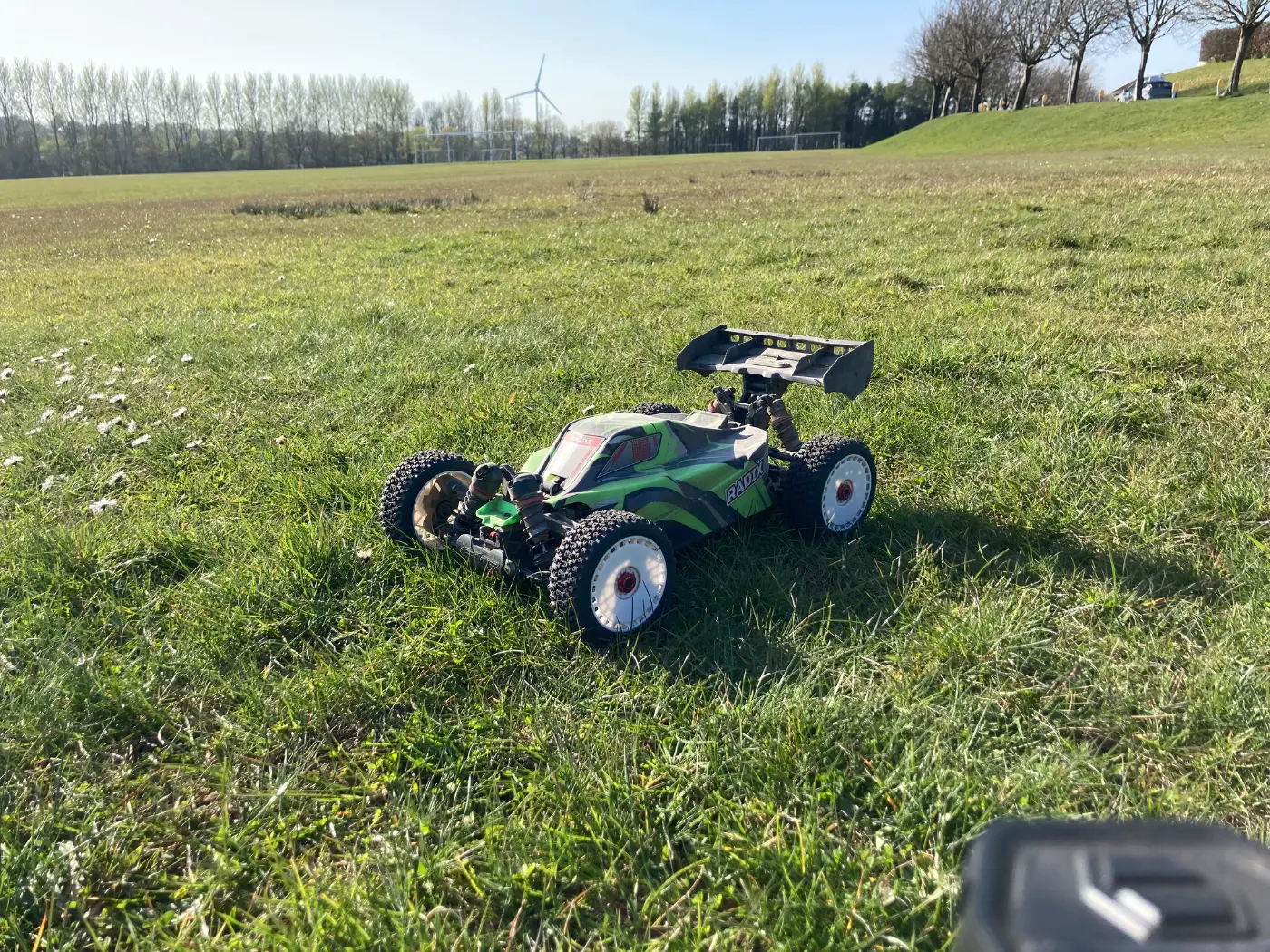

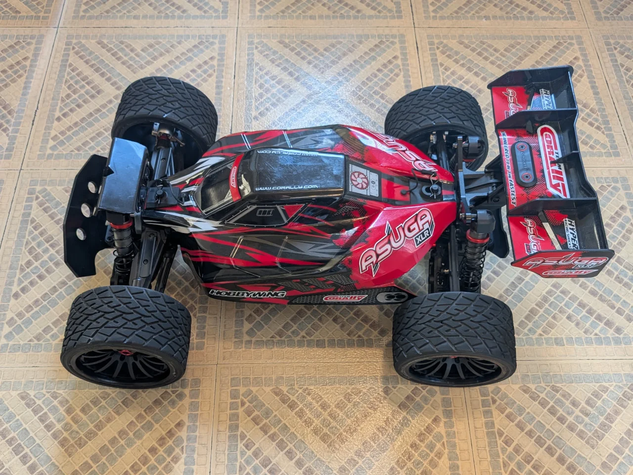

Move the shocks to the inner position on the towers.First Corally car! This Asuga is tons of fun but it tips over too often during turns in grass. Stock tires and suspension.
Any tips for reducing the rollovers?
Try adjusting the suspension first don't just start cutting things. Moving the shocks in on the towers will improve resistance to rolling and cornering while reducing traction a little. It'll also make the suspension a little less bouncy. With the stock position the Asuga almost but not quite stands on it's suspension with the shocks moved in on the towers it hangs a little more. You can also try leaving the shocks in the stock position in the rear and moving them in on the front tower and maybe moving the rear lower suspension arm up one hole on the hub block to lower it in the rear slightly.I’m probably trim down the edge knobs of the tires at like a 45deg angle.
Correct, moving the shocks in on the towers doesn't change the droop it causes the chassis to sit a bit lower on the suspension because the shocks have less leverage in the vertical direction and more leverage in the horizontal direction. So they resist rolling more but resist bouncing less.

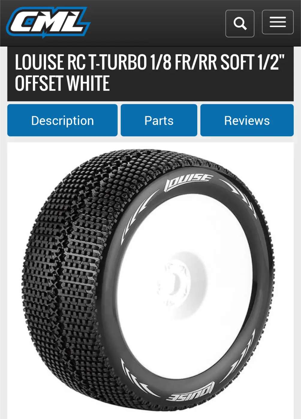

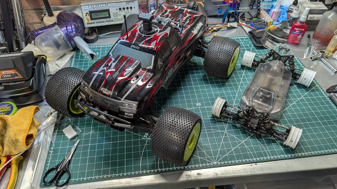

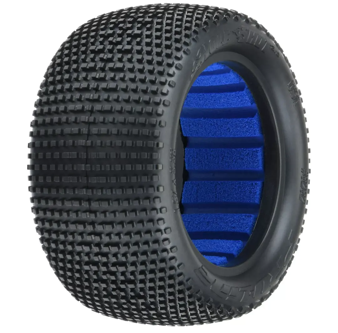

Many people simply put truggy tires on it for grass, skeeter tires work well. Mojave 6S short course truck tires will fit too.

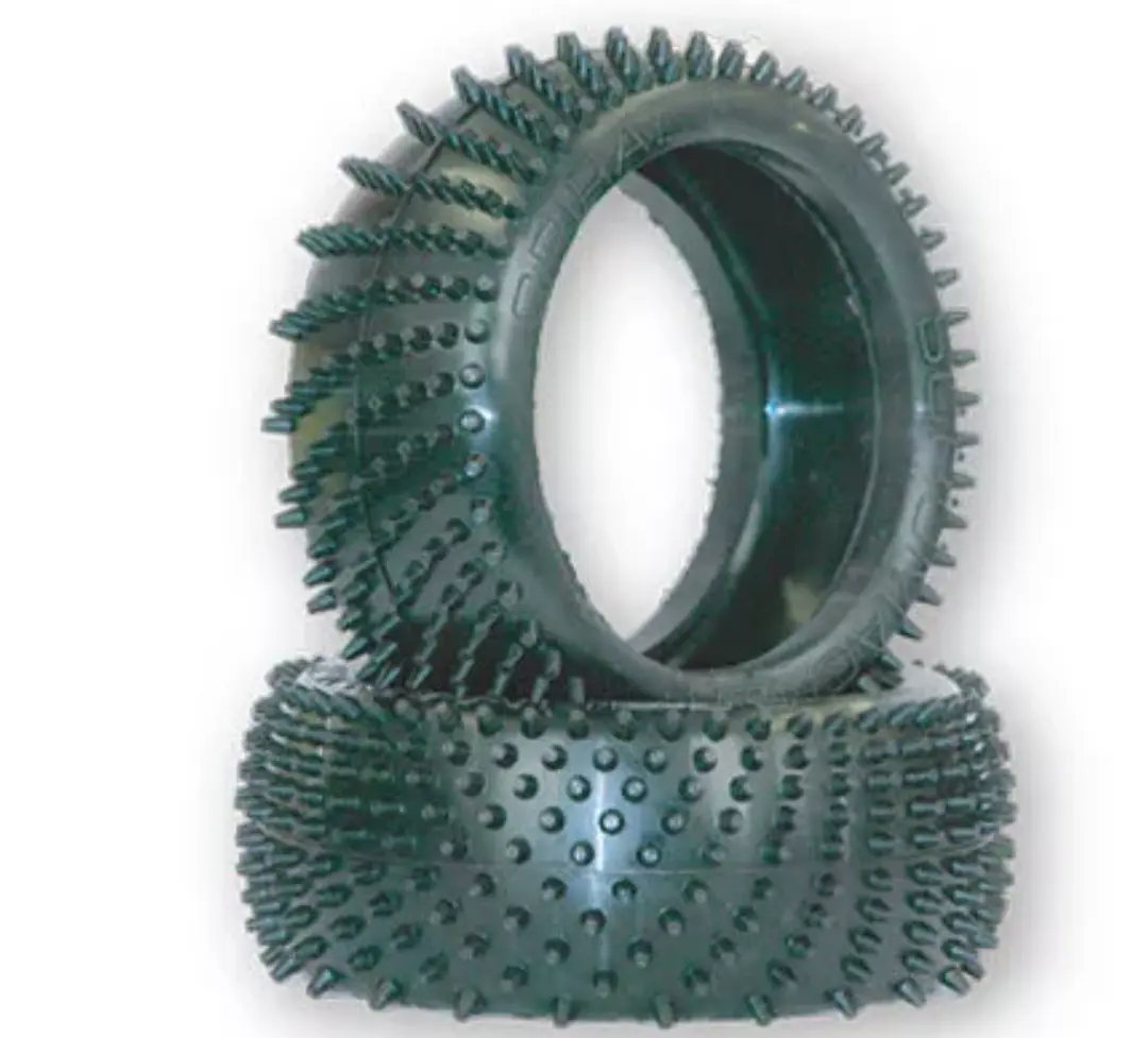

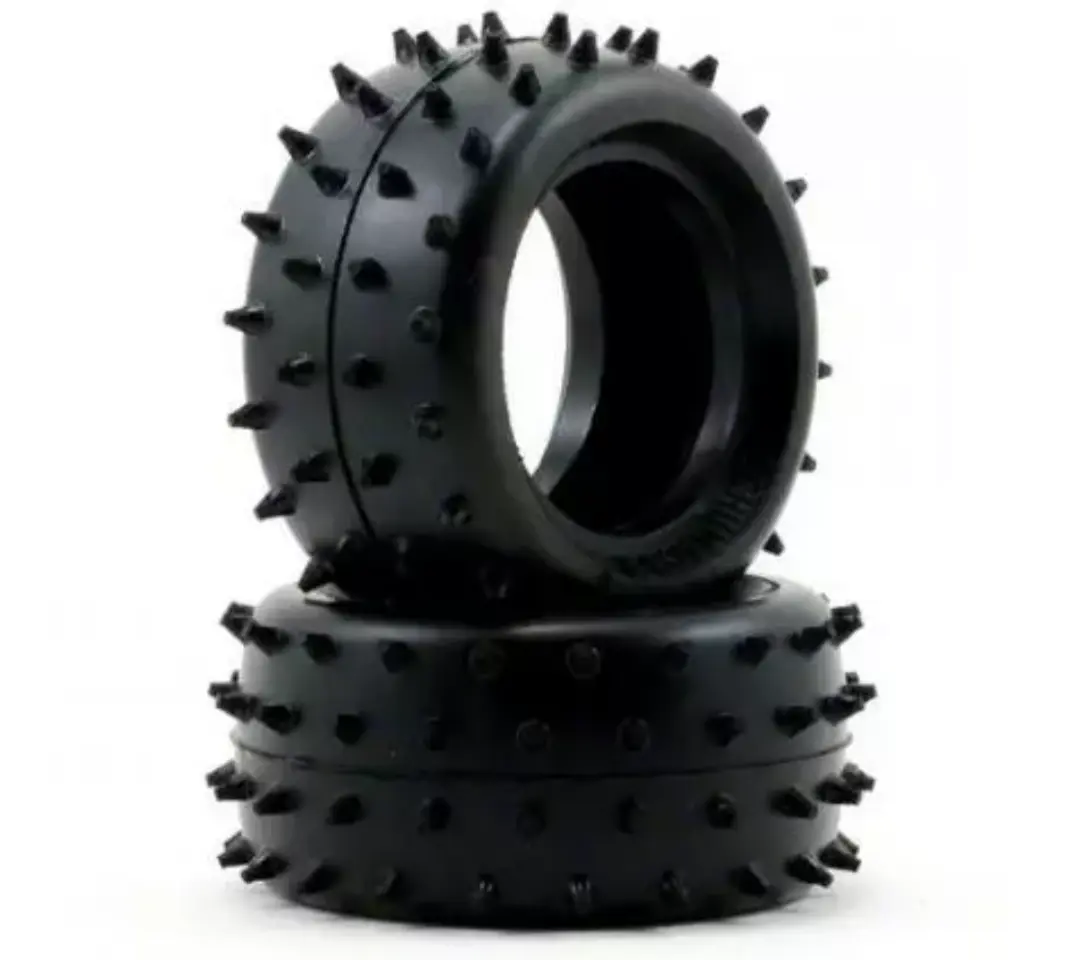

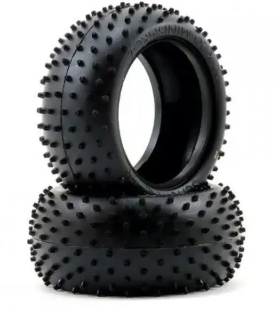

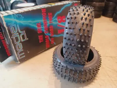

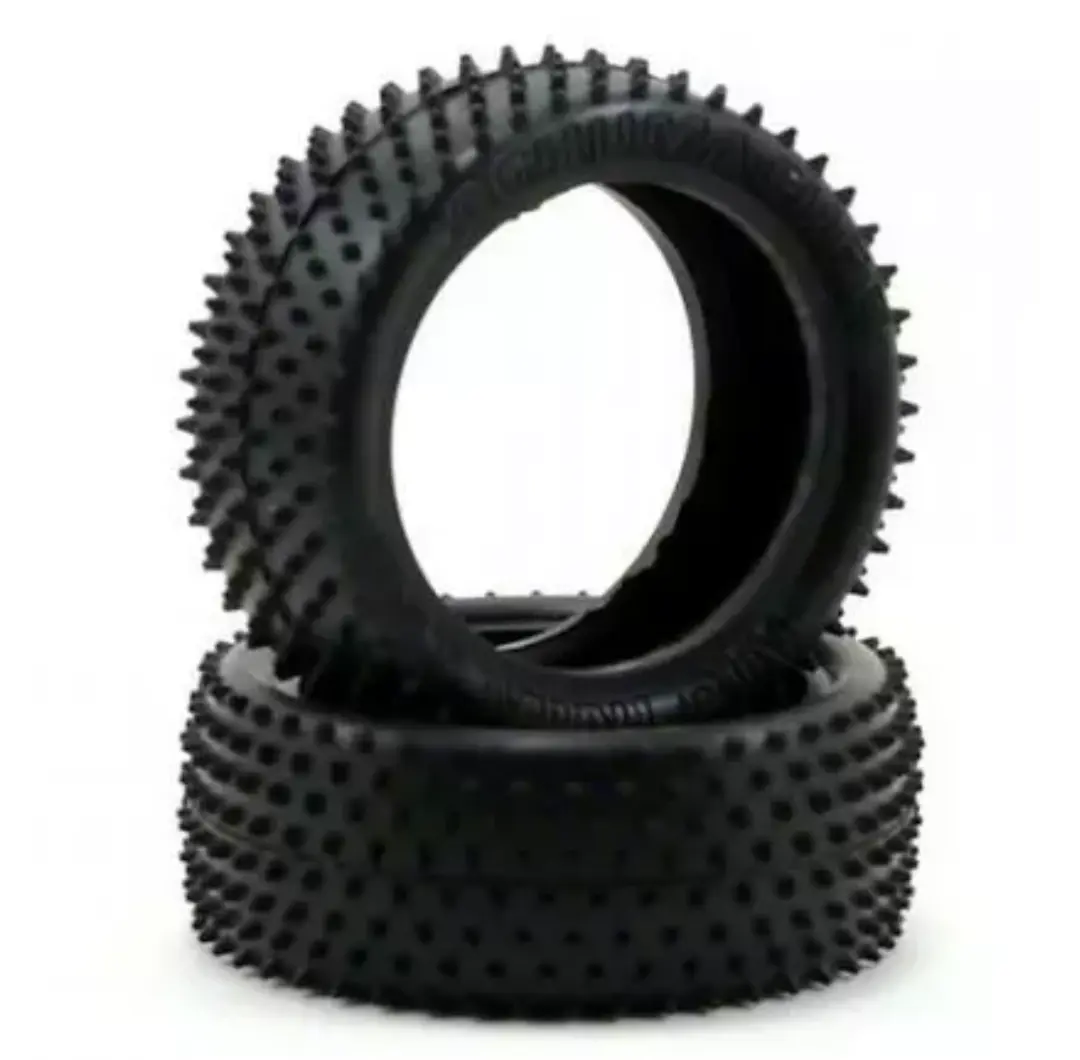

With spike tyres, we used to cut every other spike on the outside edge of the tyre to reduce grip roll. Not sure if this is an option with stock Asuga tyres though!![]()

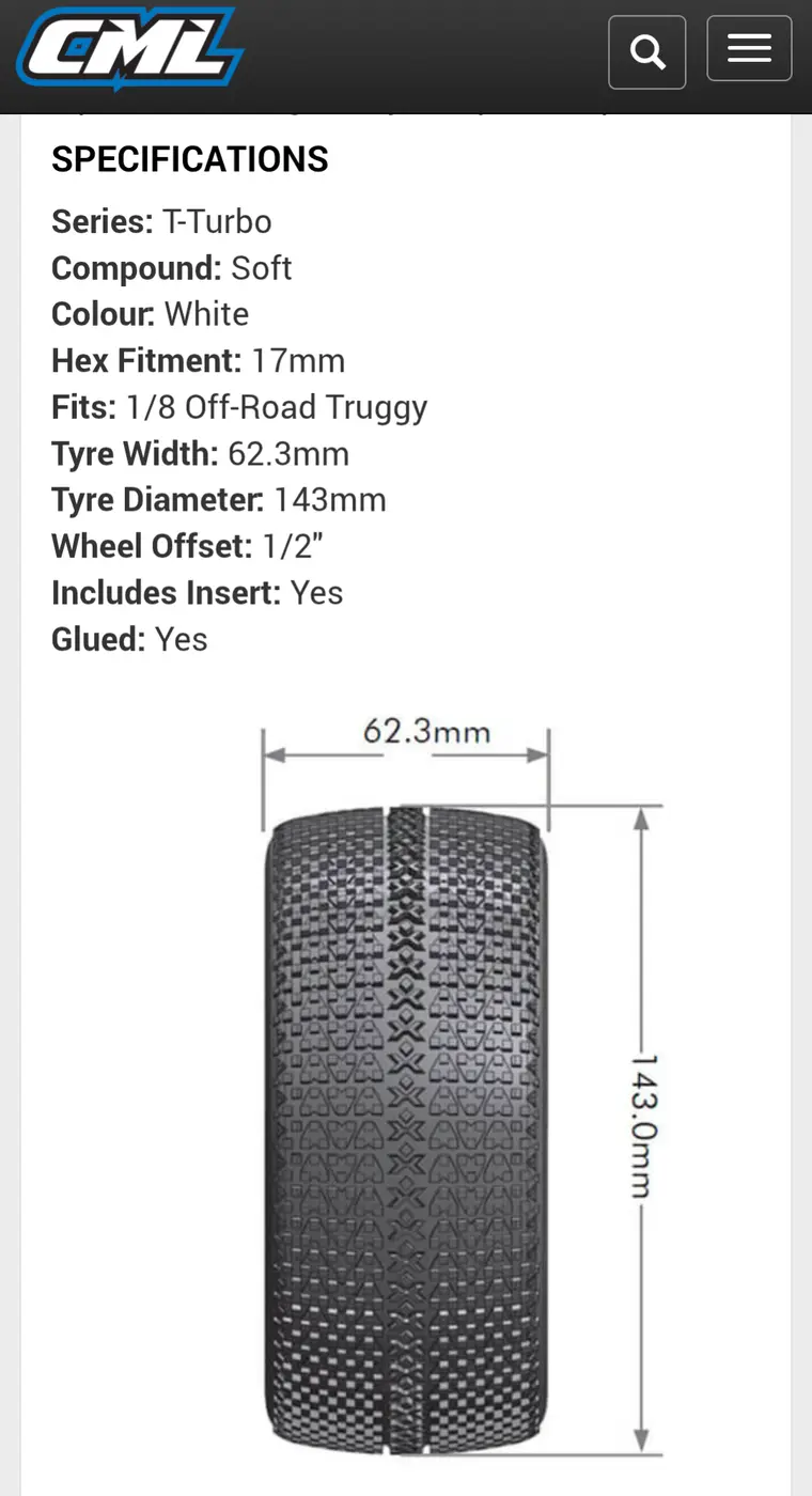

If you figure that the Asuga is 15% larger than a standard 1/8 buggy then 120mm + 15% is 138mm, a bit larger than the stock 130mm tires and that gives you some more wiggle room. There are more options in 135mm~140mm than at 130mm like the 140x70mm aliexpress Phaltlyne clones. Also basically any tire that fits a Mojave 6S will fit the Asuga.Agree 100%. Unfortunately the Asuga has a weird tire/wheel size, so you have to make do with what’s available.
