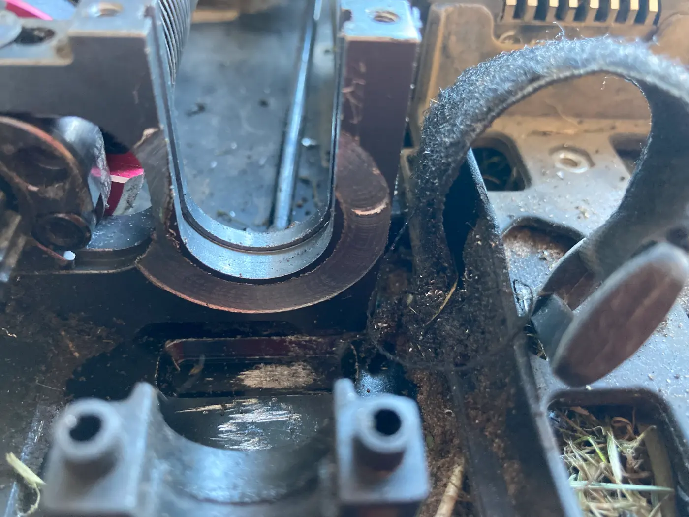

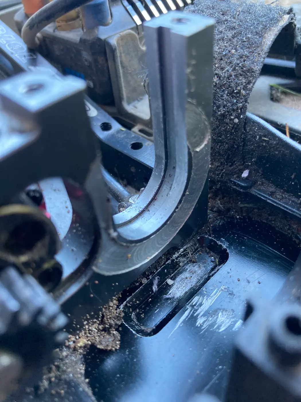

Hey all!
Finally got some time to carve out to work on this. Fortunately, the screws in the diff had just backed out.
Scuffed the motor plate pretty good too.
When I tightened up the screws and put the diff back in, it rolled smooth as butter. So it looks like there's nothing major here. Thanks for all the imput everyone!
Quick question--I should threadlock these diff screws, correct? I just wanted to double-check before I did so. Thanks again, y'all
Hey all!
View attachment 7874View attachment 7875
A little blue loctite, suitable for hand tools. Loctite 243 is about as strong as you can safely go for hand tools. Conservatively applied! 🙏👍
Devcon now has an orange "medium high" strength threadlock gel that can be removed with hand tools but do not ever use it on things that you can't apply a heat gun to. It's not like red where you need to nuke it but unless the parts are all metal and can be easily accessed with the heat gun or removed from anything that can't take some heat don't use it.
