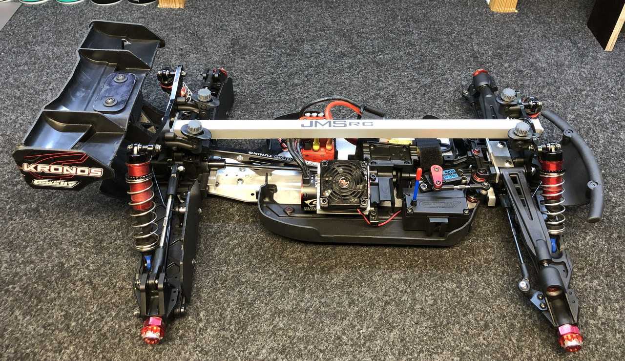

Just thought i would start a wee thread that can hopefully be added to.
Please feel free to add any tips or information on other compatible parts.
The aim is to help people easily find information on how to modify / strengthen there corally rc cars.
Parts i have found out fit sometimes with minor modifications.

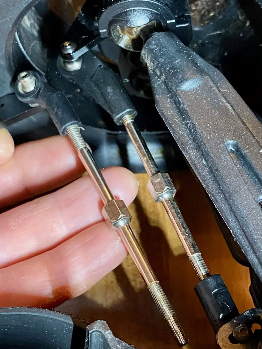

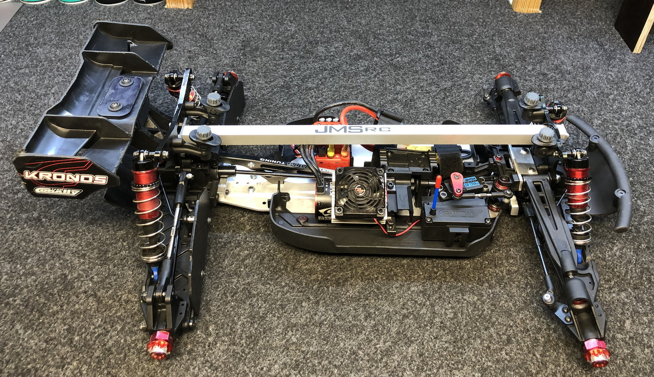

Arrma kraton steering ends. The ends are slightly longer and thicker but if you cut a wee bit off the corally steering shaft they fit on.
The bar on the car is the modified Corally one with arrma ends. The one i am holding the standard xtr one.
