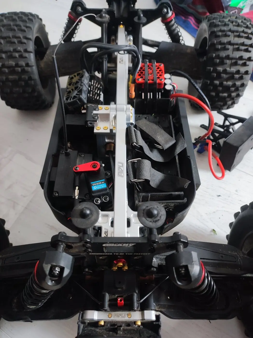

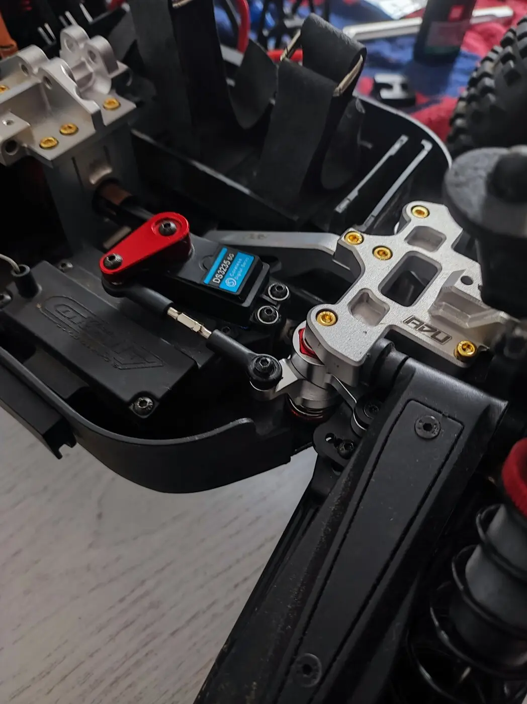

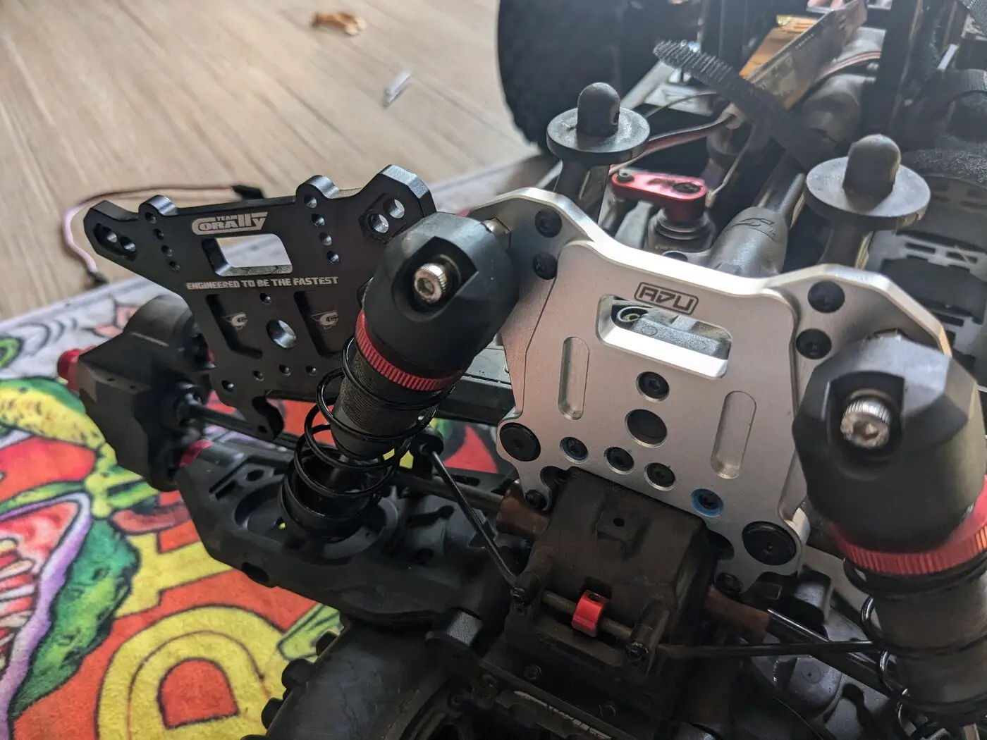

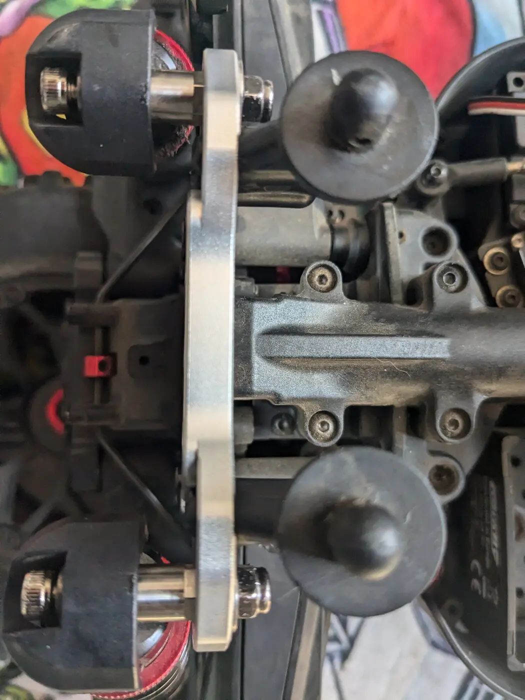

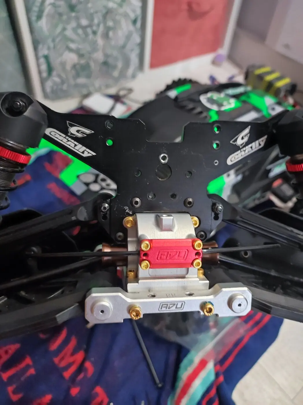

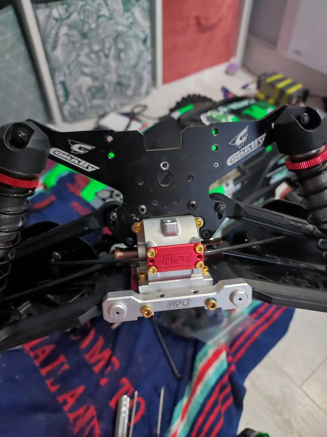

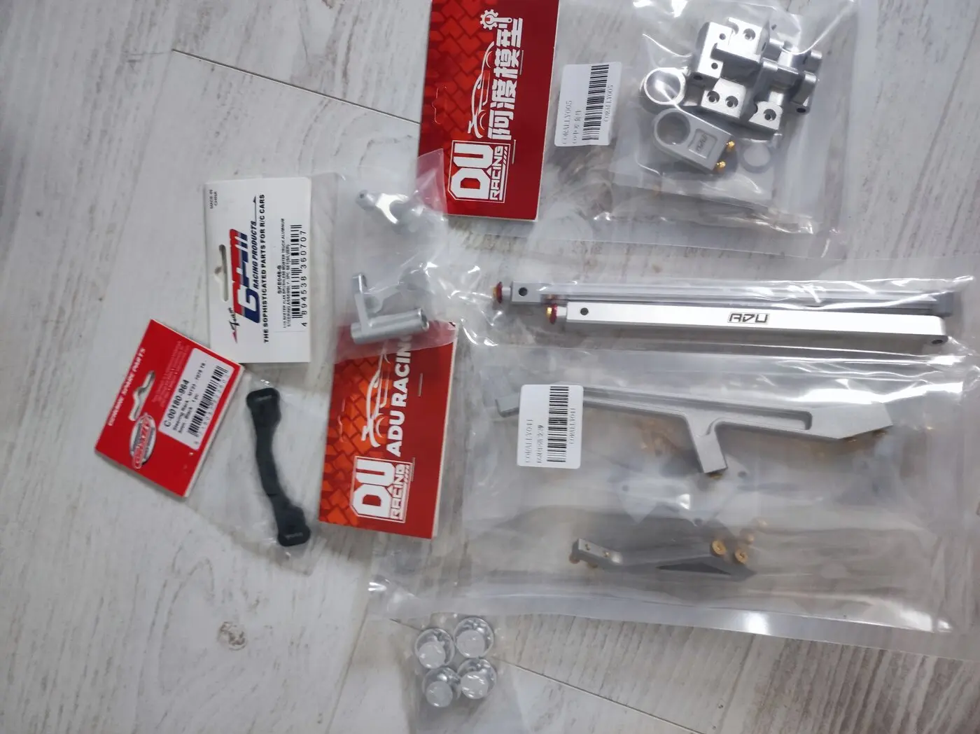

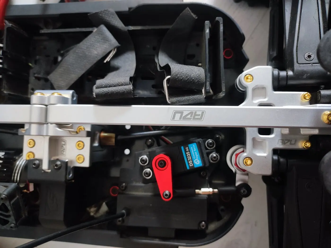

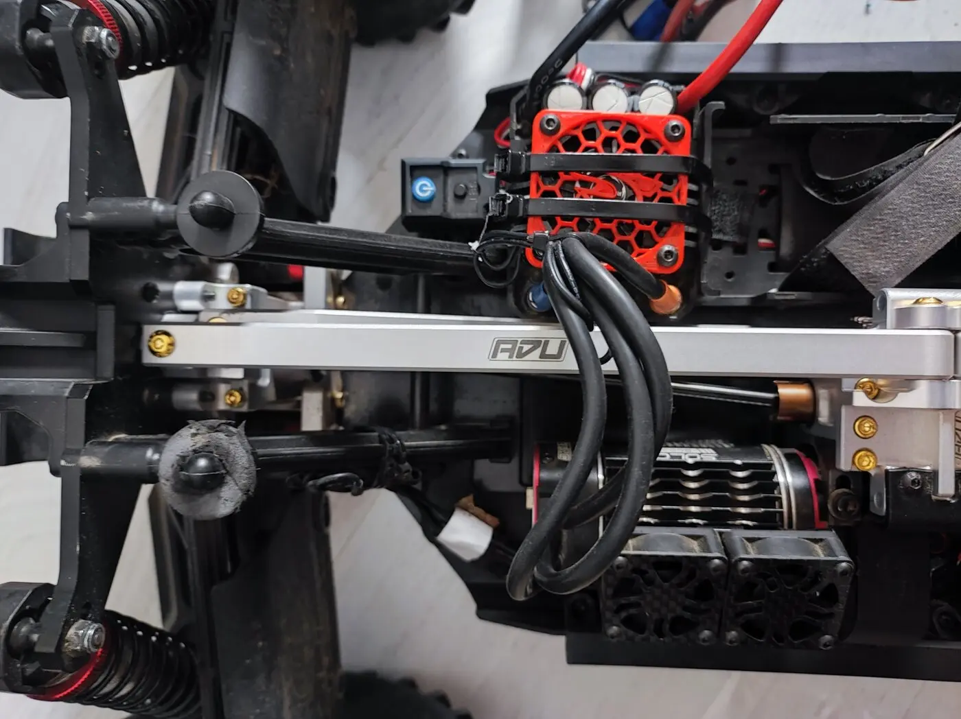

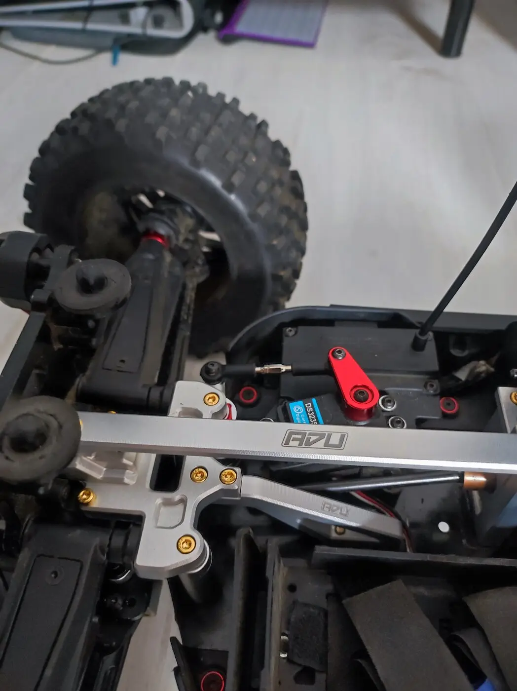

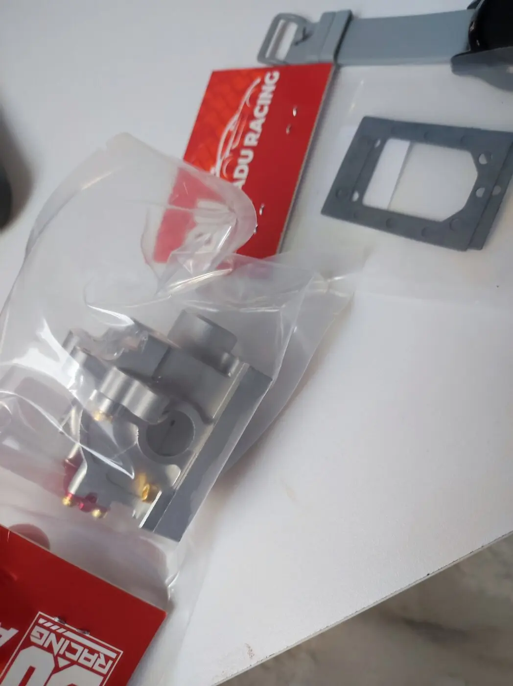

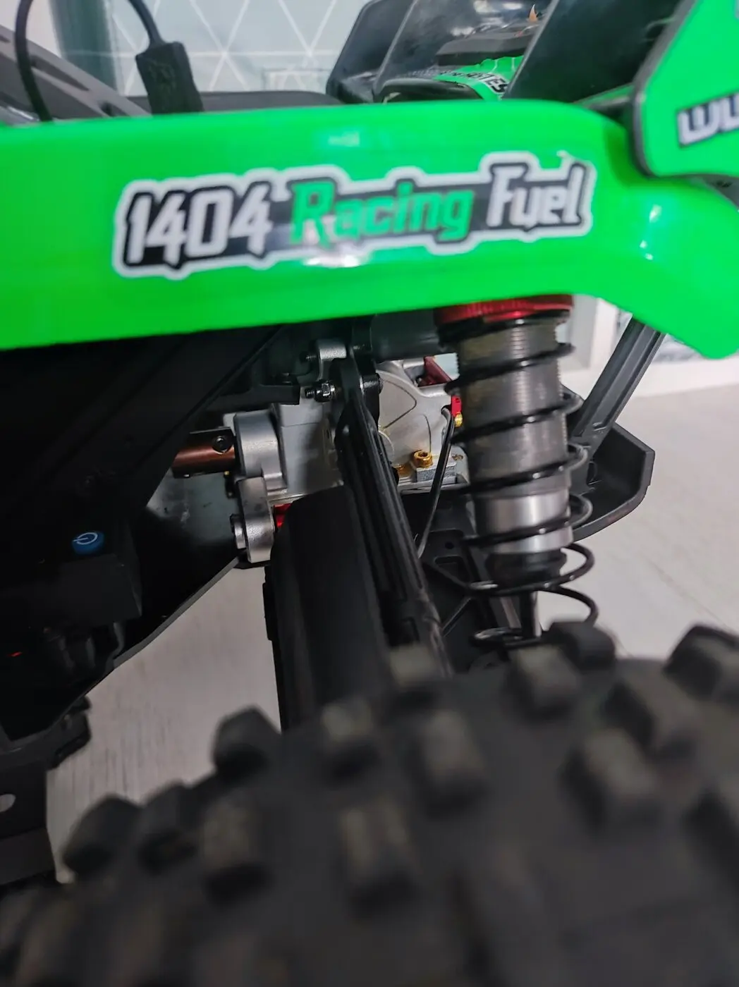

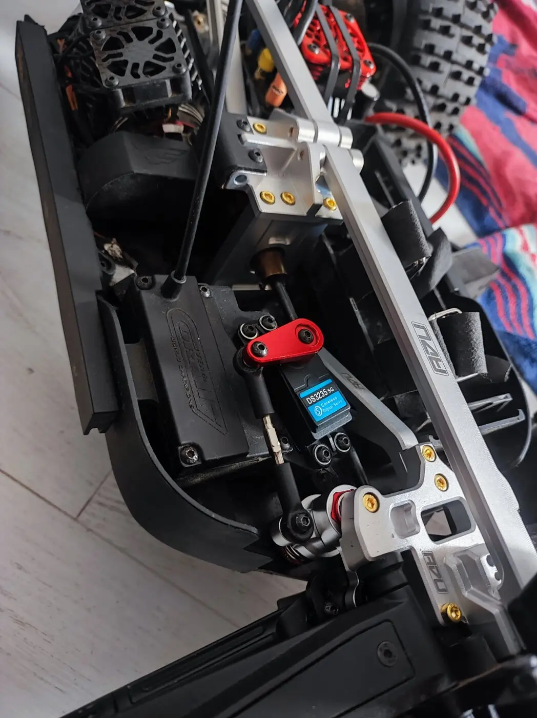

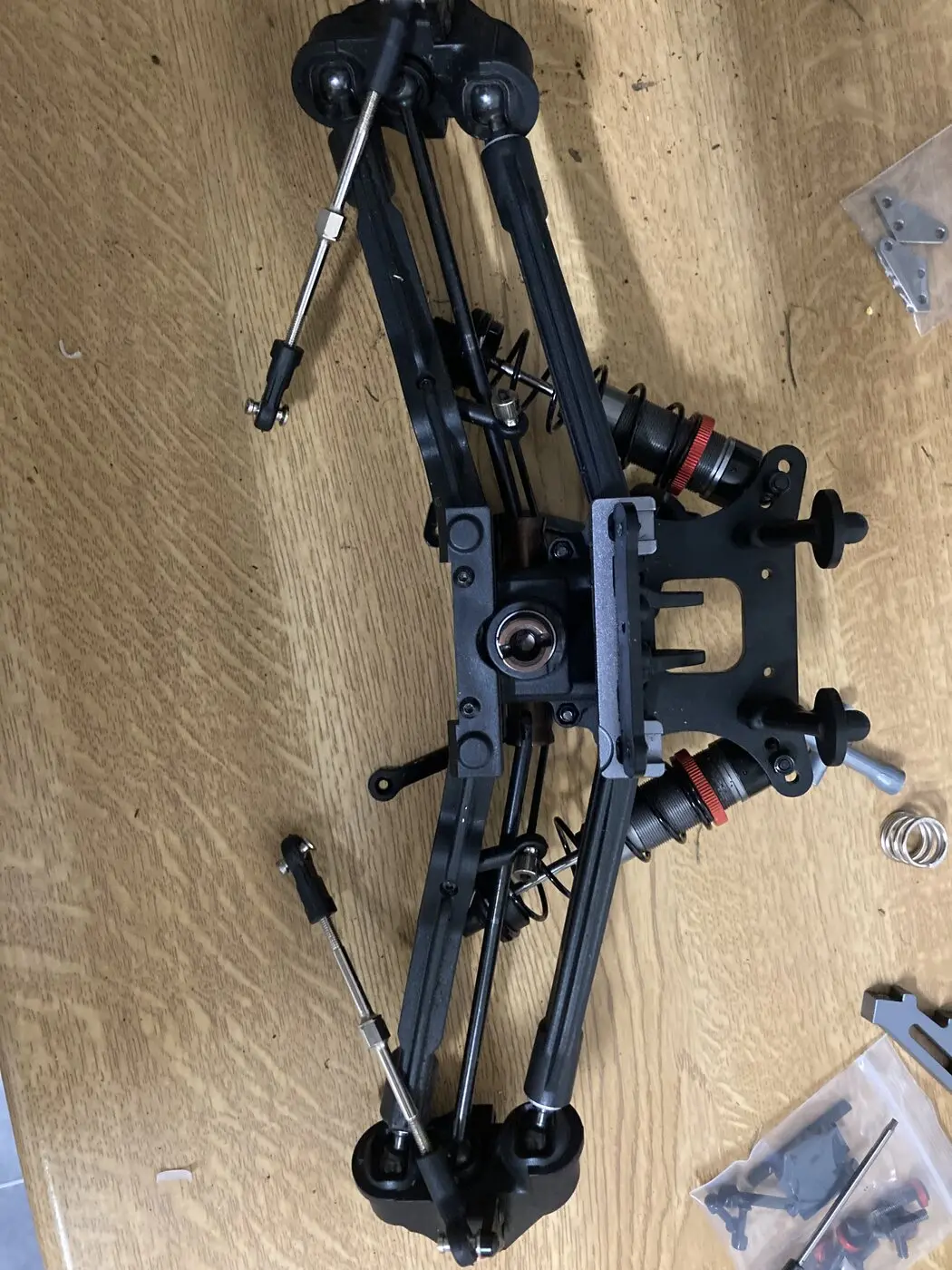

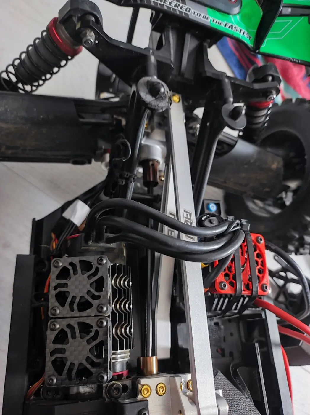

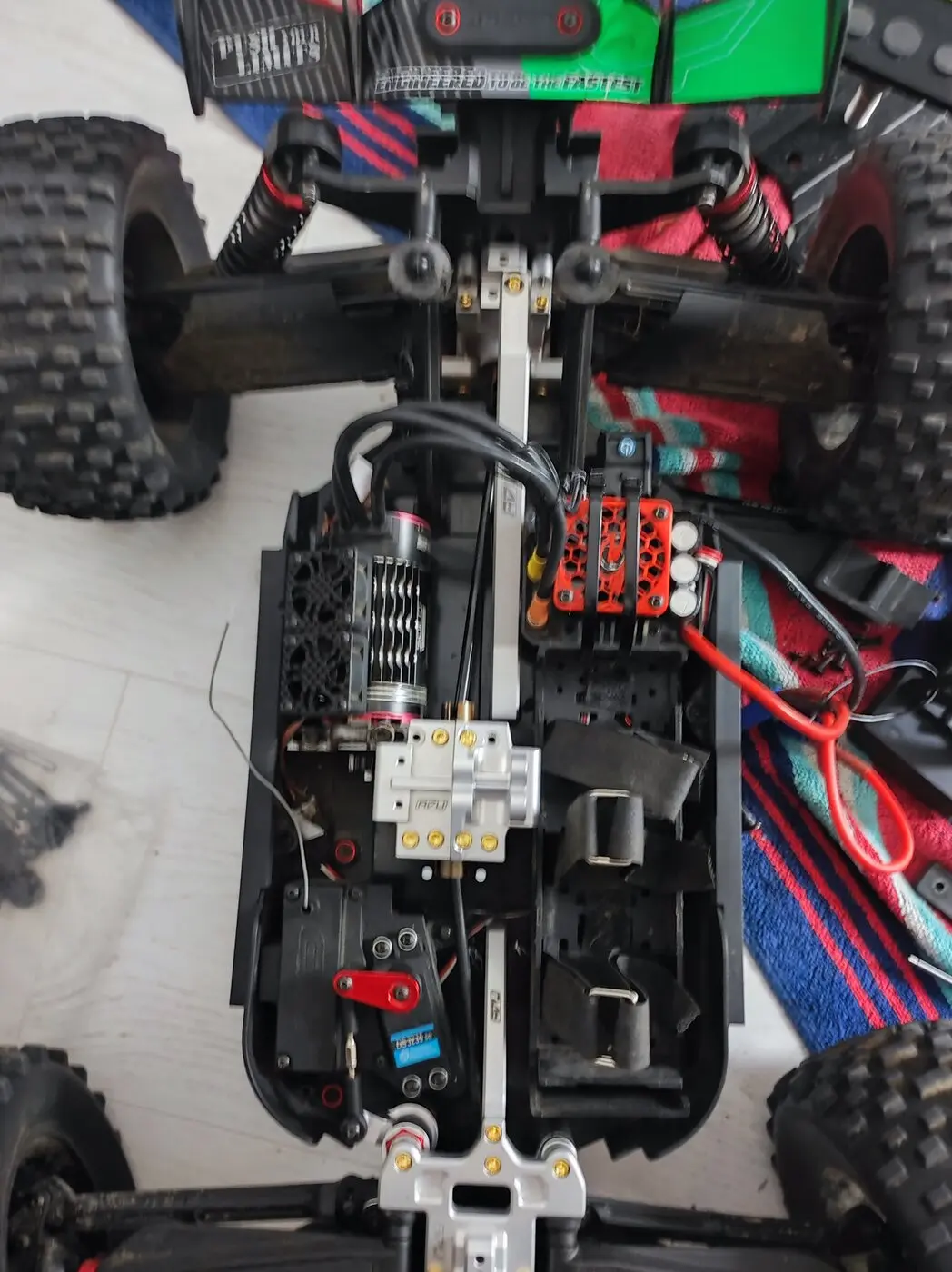

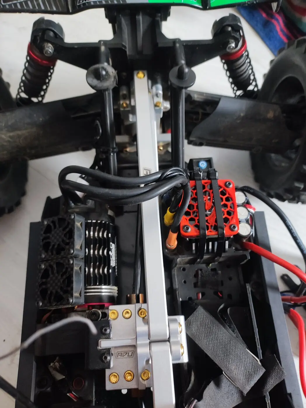

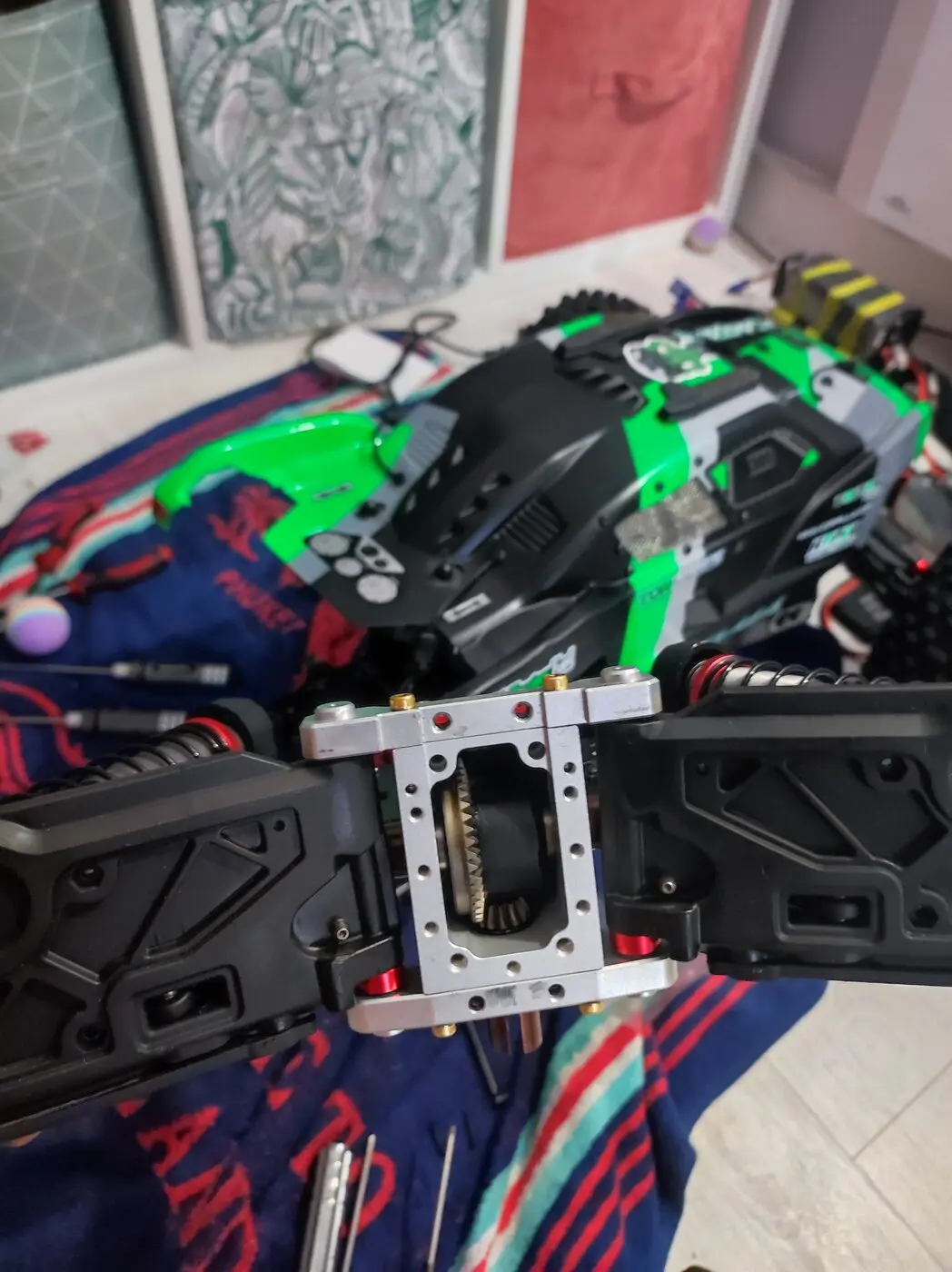

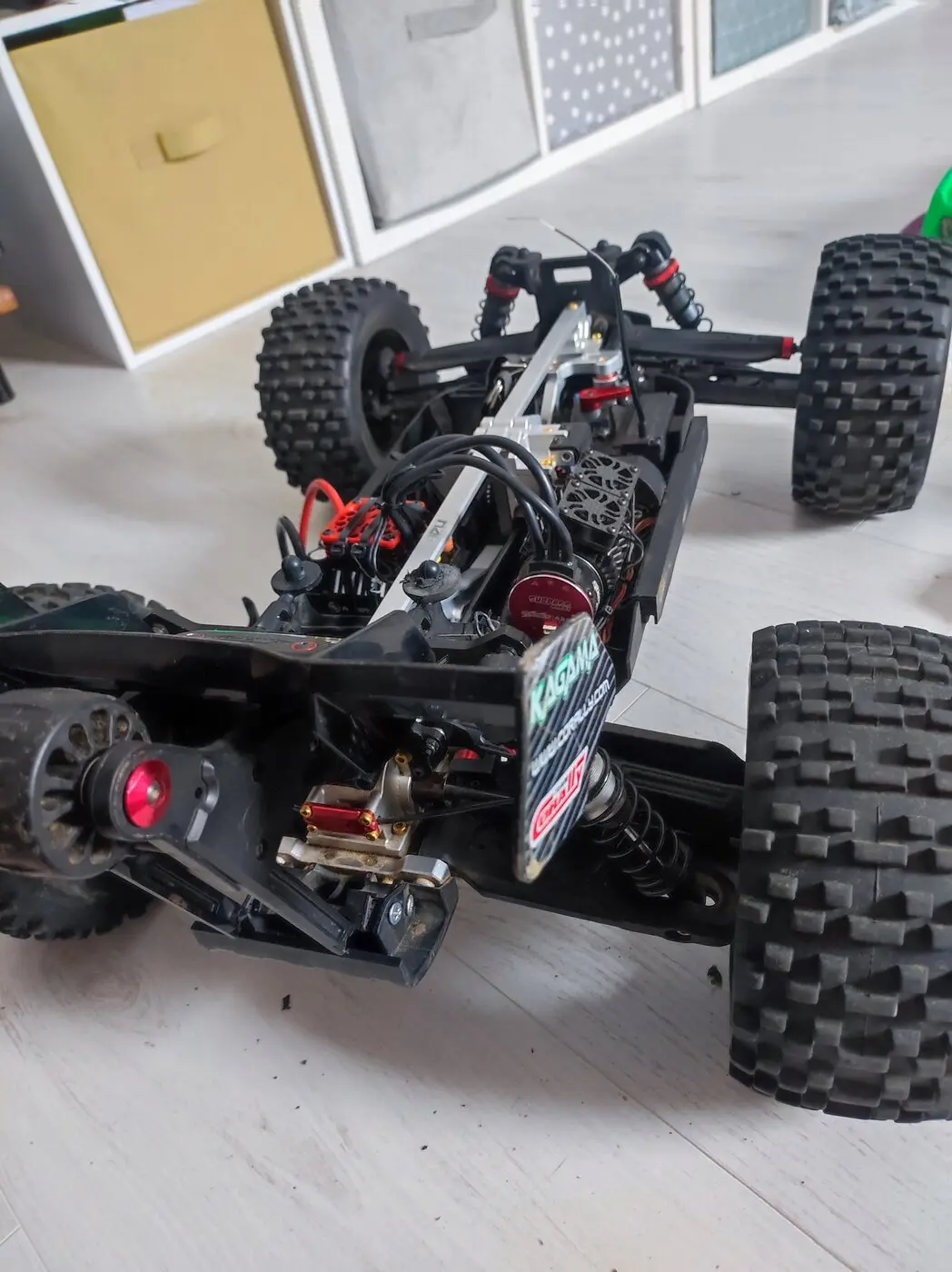

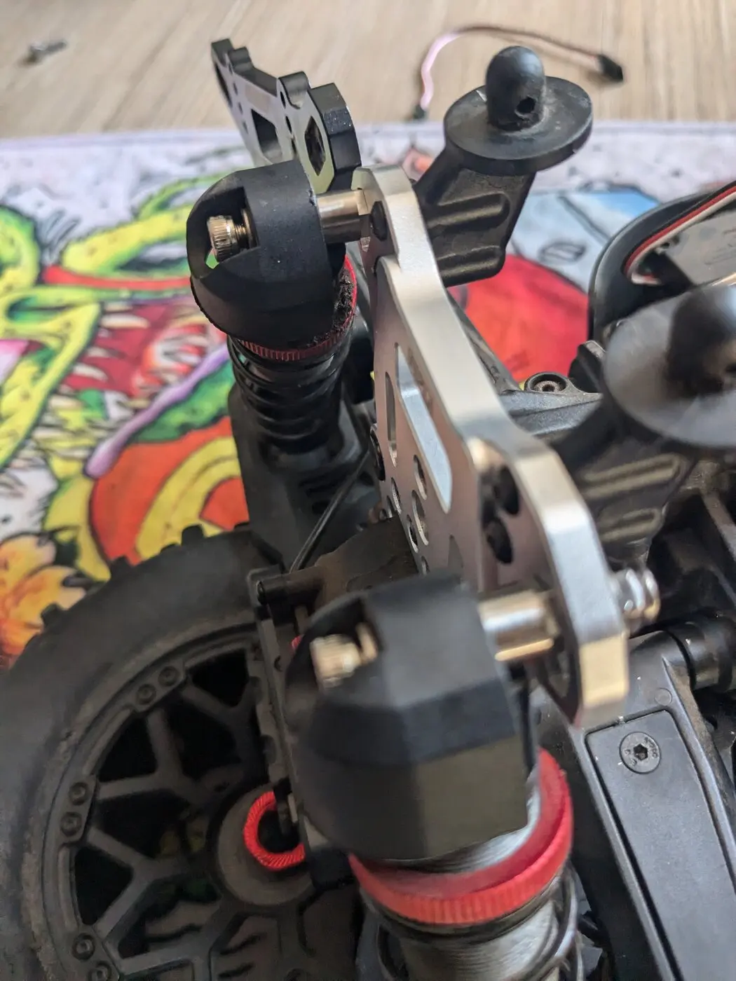

ADU 7075 shock tower and ADU Racing titanium shock standoffs installed.

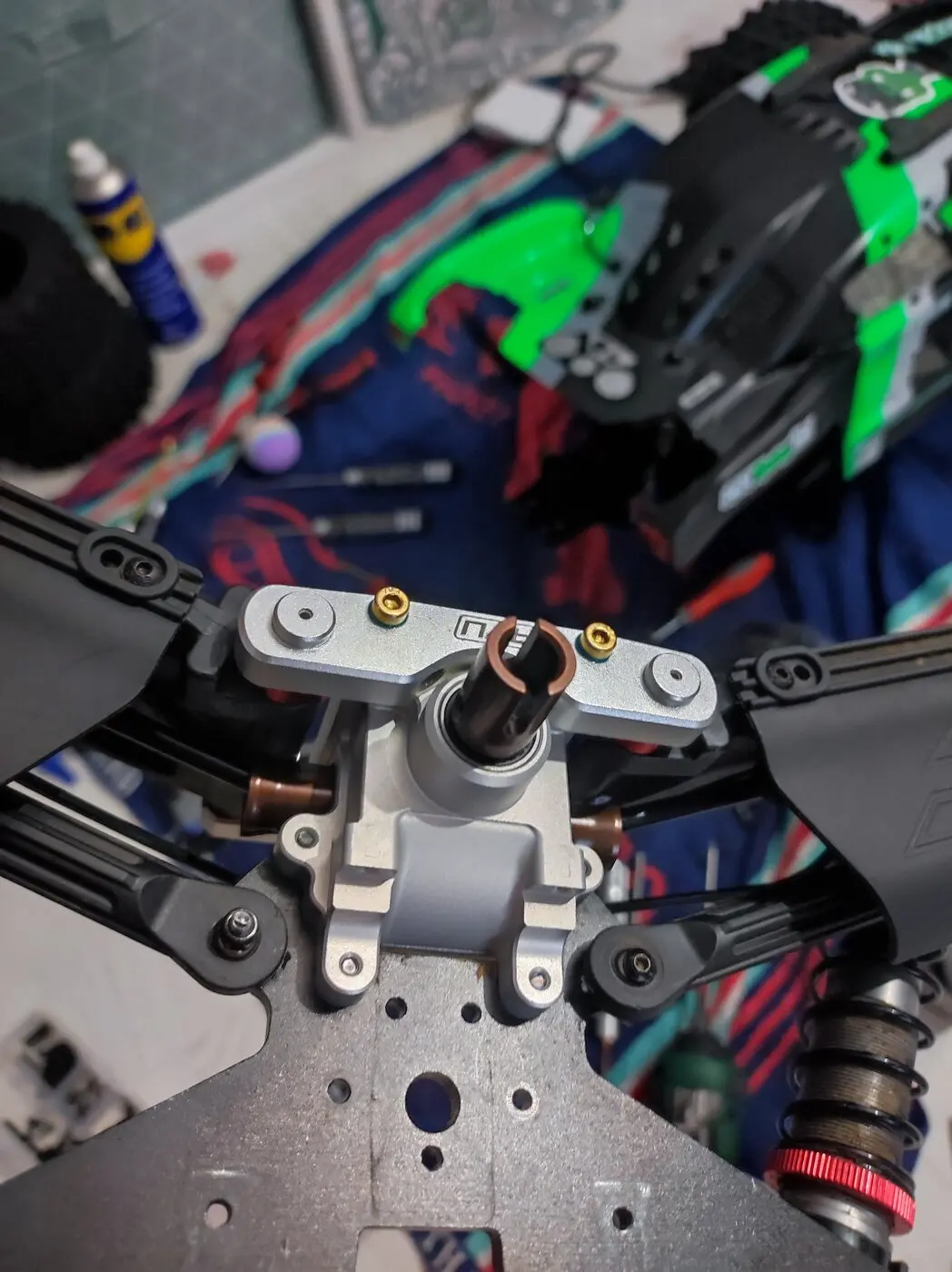

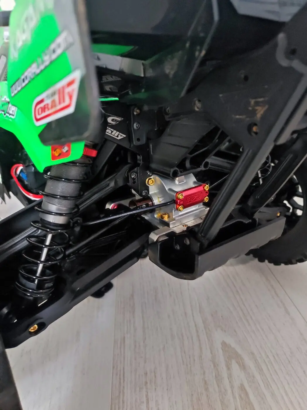

I bought the ADU titanium steering rack as well, but I wasn't using my brain, so I didn't install it yet.
Replacing the front shocks towers was the first work I'd done on this truck, and I needed all my brainpower to make sure all the screws went in the right places. 🤯
My CNHL 5s battery arrives today, so I thought it was a good time to install the new shock towers.
I wanted to go with SMC, since they have the most truthful C ratings in the industry (IMO) but they didn't offer a 5s.
I just think 6s is too much for me and the truck. Not like it isn't durable, but I'm still learning to control this truck compared to my much lighter Granite.
Happy bashing !
Looking good, easiest way change Ackerman pull front clip off 1 piece, if don’t already know. Take tower 2 tower brace off, unscrew servo servo saver from top deck, disconnect arms from Ackerman then unscrew bumper/bulkhead, front clip should slide out. Bit off work in it but I think that easiest way. How I did my Kronos neway
