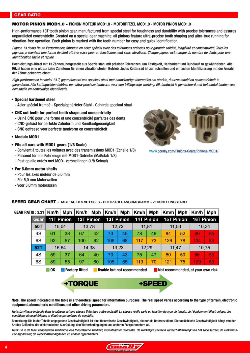

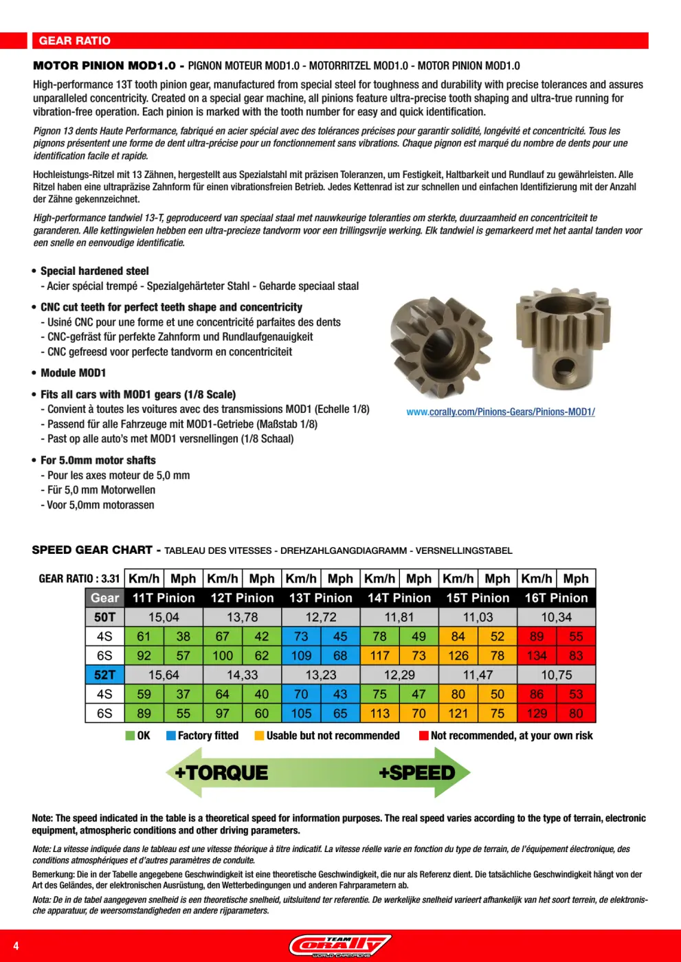

From your posts, 66 mph stock speed seems impossible on the 13t pinion.
Other than the Radix, are there any Corally's that run 60+ in stock form?
Radix won't either unless you gear up. The trucks may come close, 6 extra teeth on the spur which will slow them a bit but considerably larger tires, I've never put the GPS on my kronos when it was still 6s and haven't put it on my xtr either, but even then I'm still running a 15t pinion on the xtr so wouldn't be "stock" numbers anyways
Yeah that chart isn't accurate at all, looks impressive though and that helps sell!

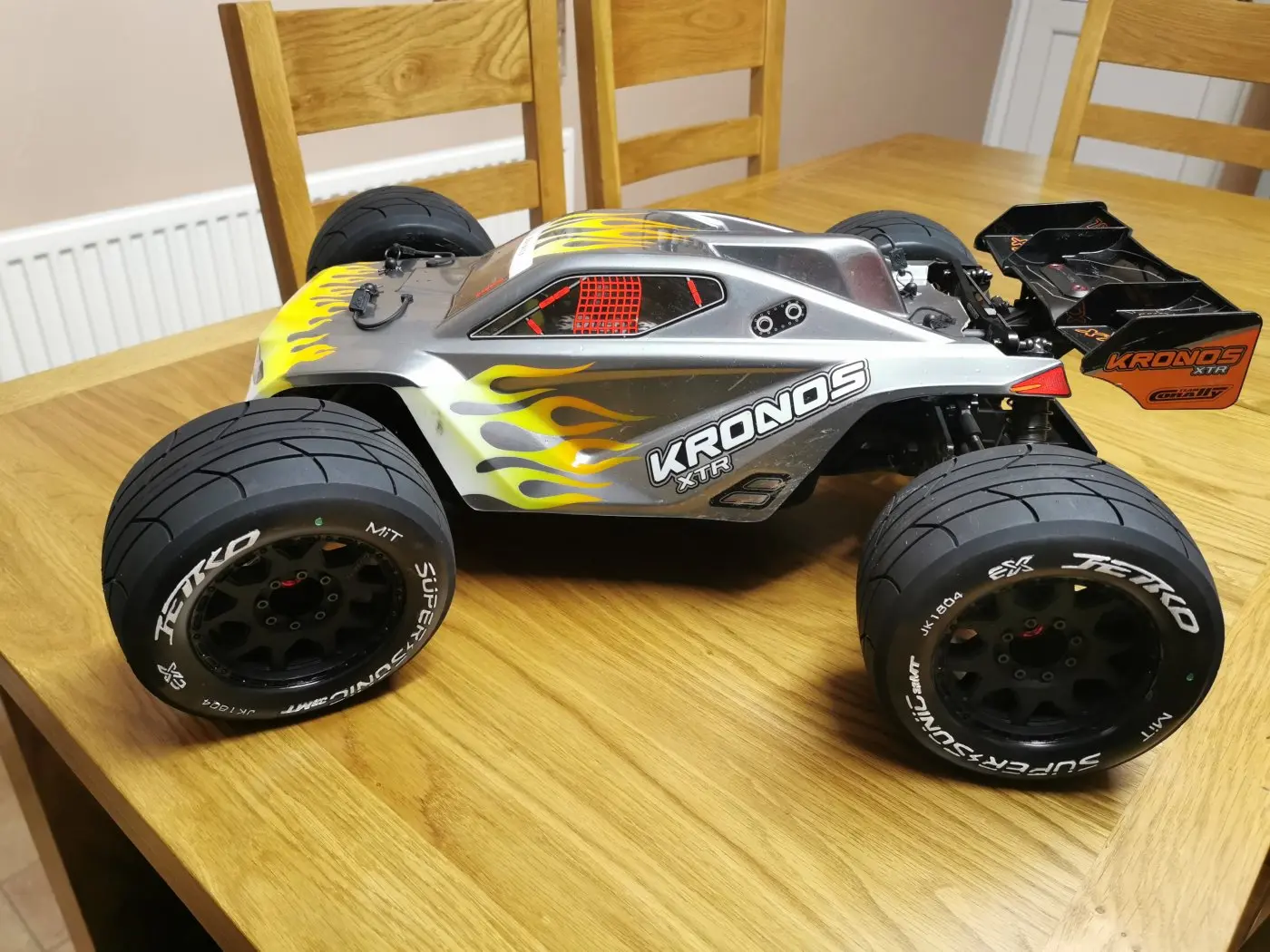

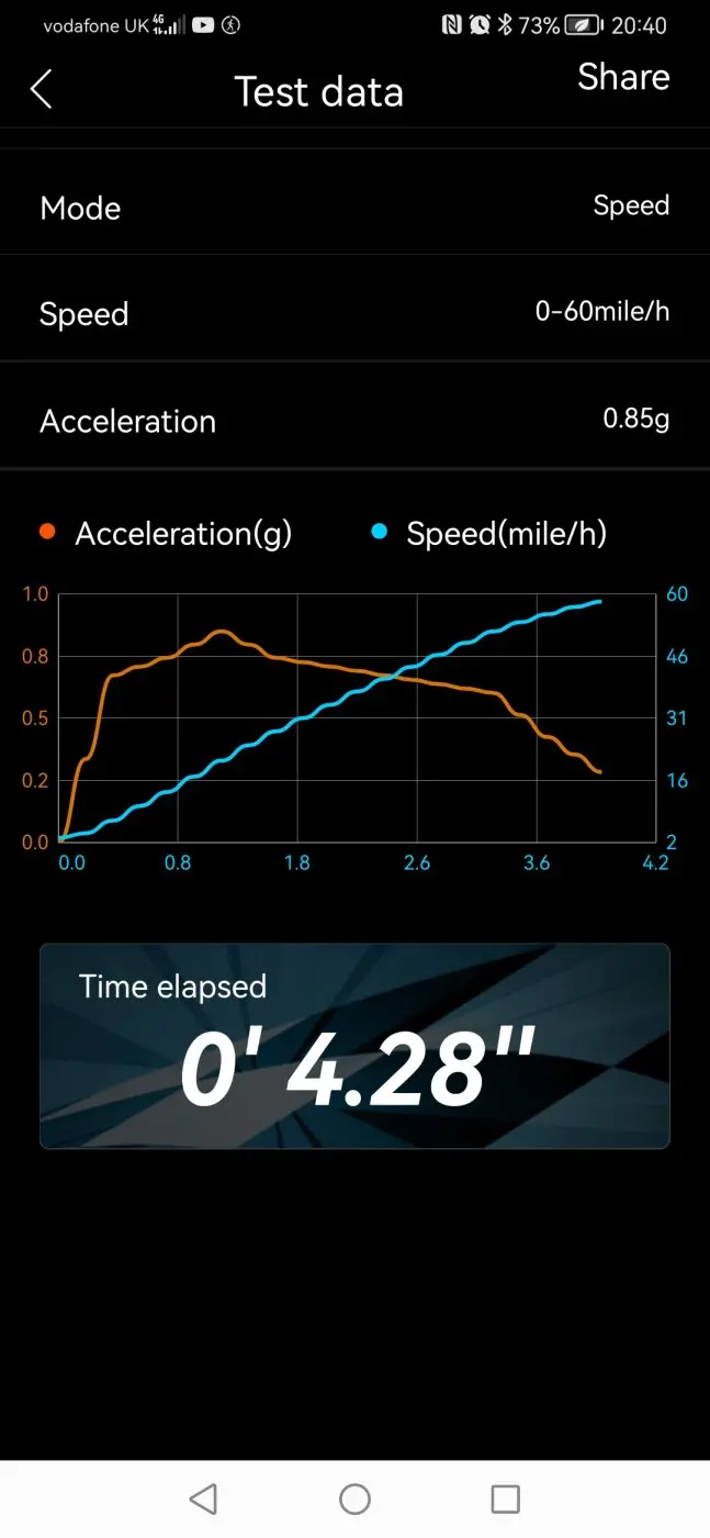

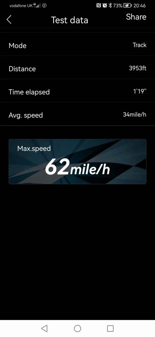

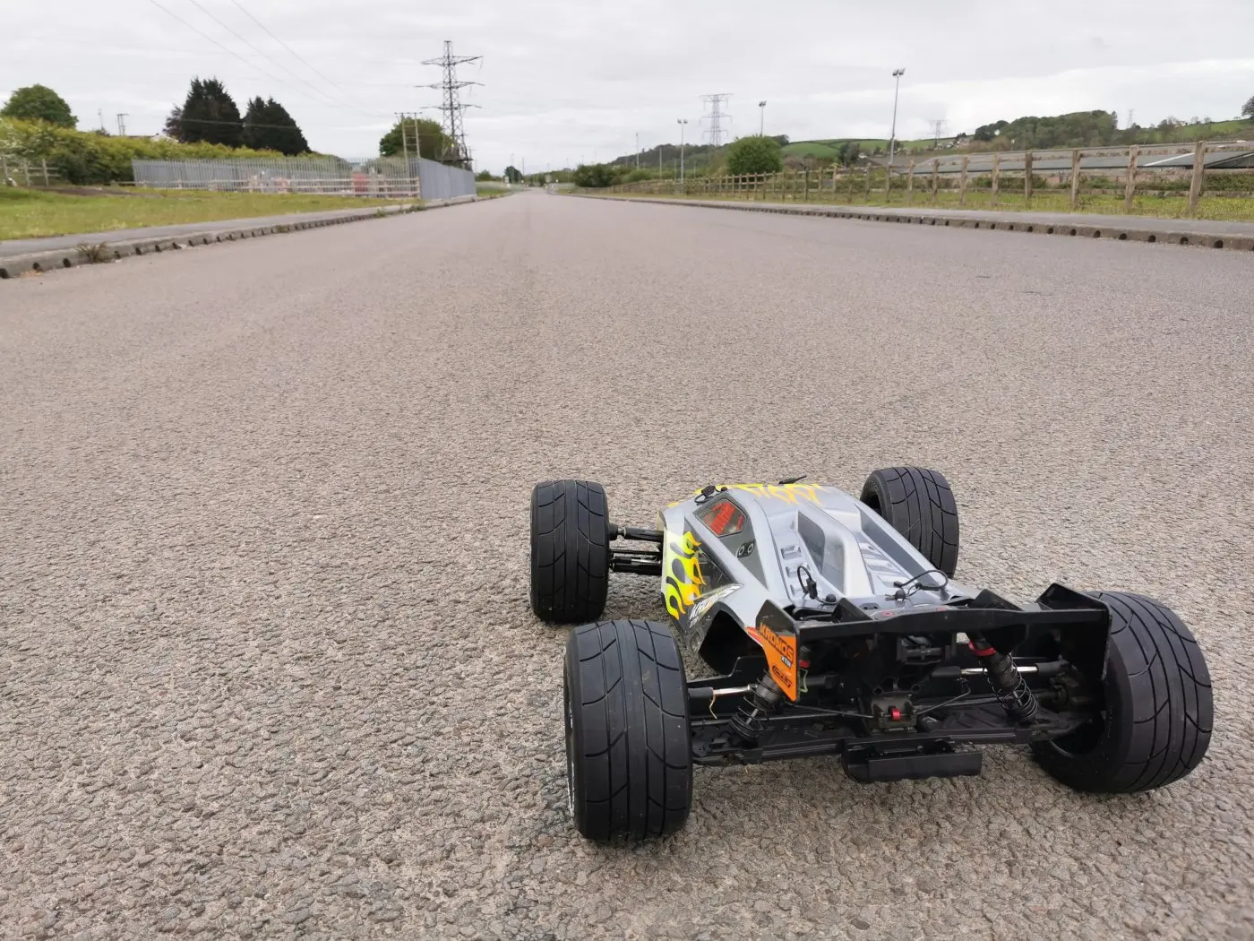

Well using the Corally Electronics on my Kronos XTR, I had 62mph on JetKo belted tyres. 0-60mph in 4.28 secs on stock gearing.
With that in mind, you'll definitely have the potential for higher top speeds in the Shogun/Muraco, provided that you run tyres that enable you to keep the rig pointing in a useful direction - at all times. Ballooning stock tyres aren't helpful helpful on speed runs.

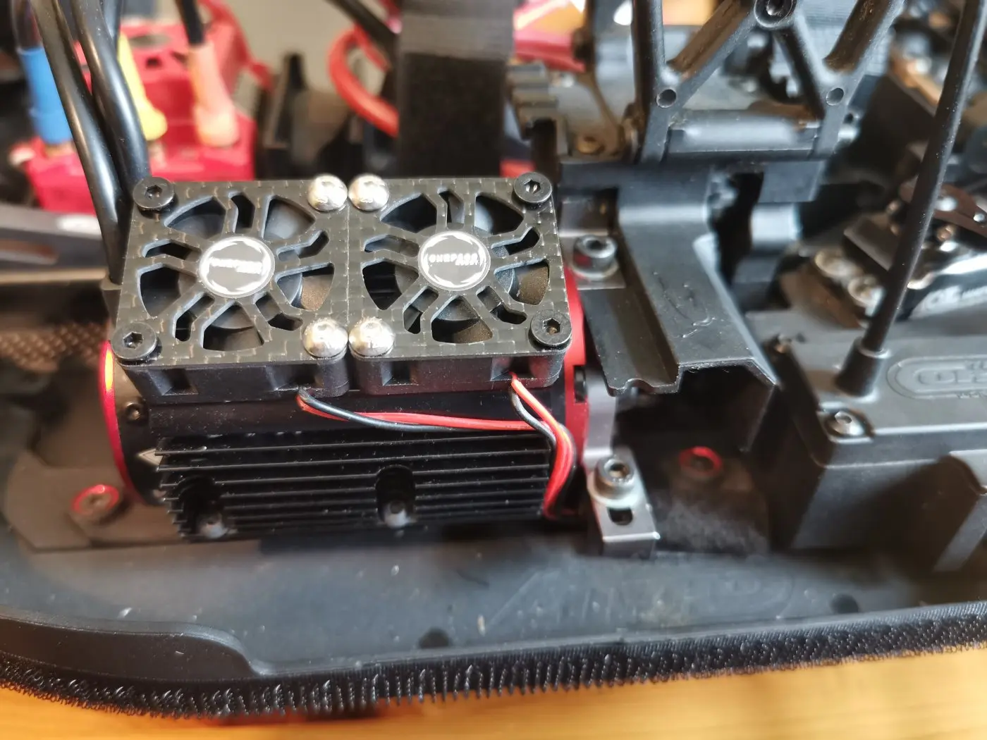

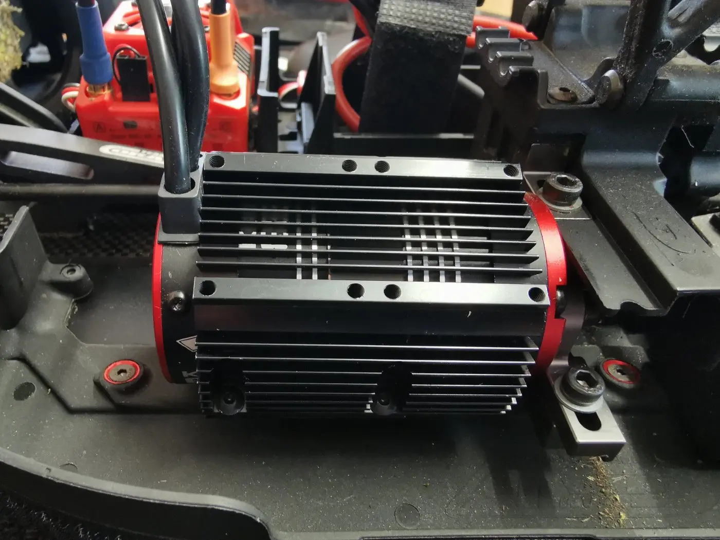

Also worth pointing out, that anyone wishing to do speed runs or mess about with higher gear ratios will need to mitigate the heat generated to avoid 'magic smoke'. The Corally motor is already pretty wild and can get overheated very quickly. Don't ask me how I know!

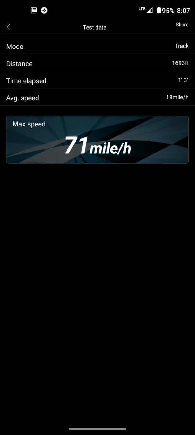

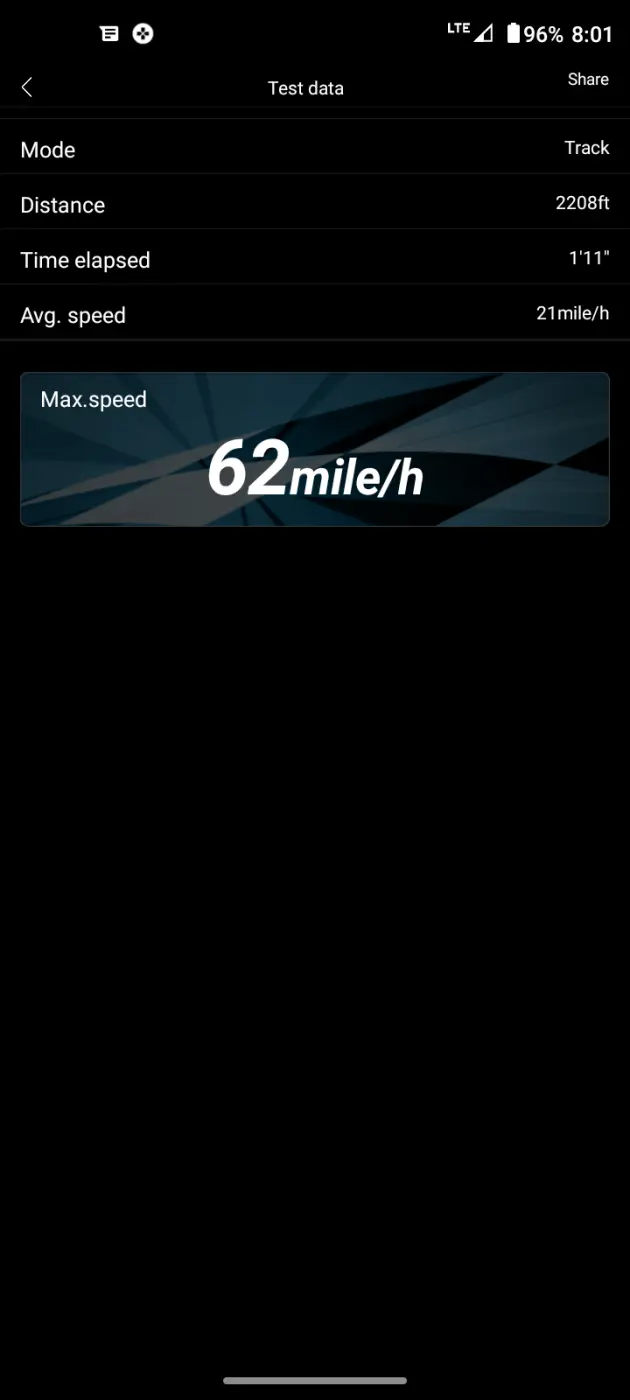

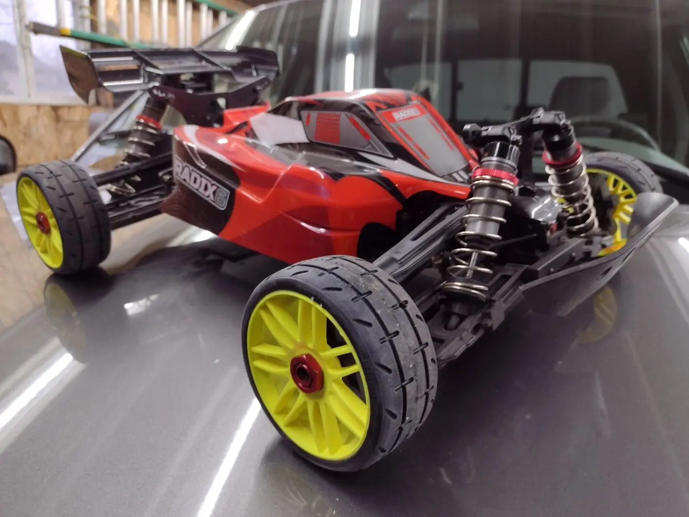

Radix runs, 6s, stock esc, hobbywing 2200kv motor, big cap pack, grp belted tires. First run on 18t pinion/46 spur, second run 22t pinion/46 spur. Now the car is 8s, castle mmx8s esc, 1480kv motor, 22/46 and ran 63mph, currently running a 24t pinion and have not yet tested

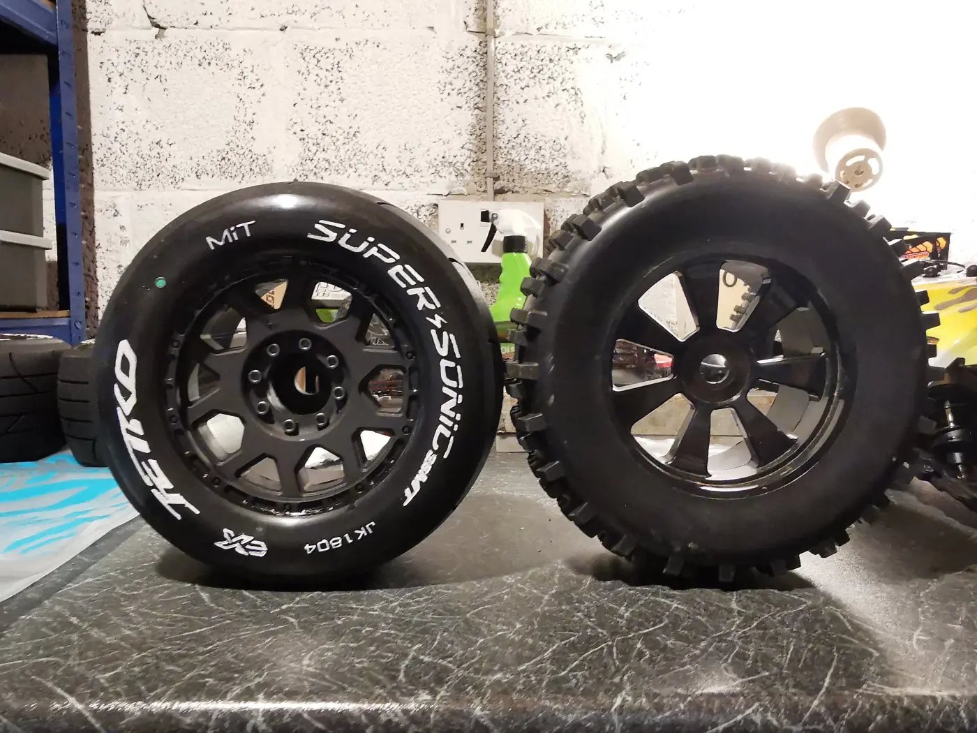

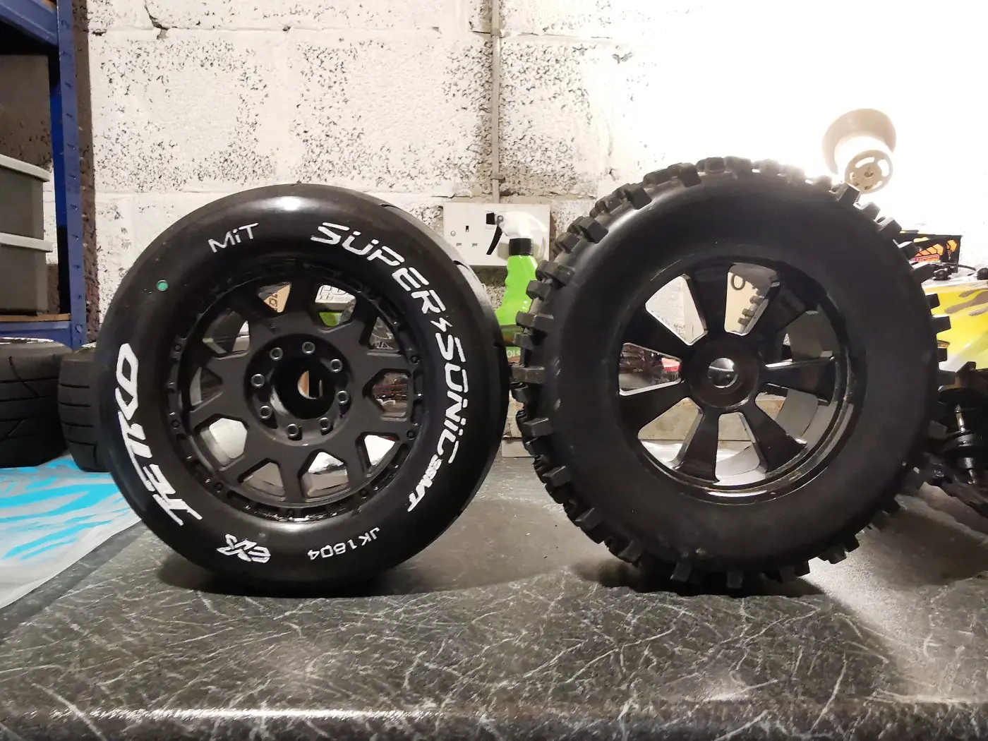

These:
They're belted and won't balloon. Because they're heavier than stock tyres, you'll need to use a firmer spring in the servo saver - the stock spring is too soft.

How well balanced are the jetko's in your experience? I've tried a few larger size belted tire brands and they weren't very good, I'd definitely be interested in a set of decent balanced belted 3.8's for testing speed on my 8s kronos
Mine were excellent out of the packet - very impressed with them. They are very sticky, give brilliant grip and don't balloon. They can flat-spot if left under the weight of the truck when not in use.
With a wheel balancer and balance putty, it's good to balance your wheels and isn't difficult 👍
That's good info to know, I don't think there's enough putty to balance the ones I've tried!! I'll have to put the jetko's on my winter buy/upgrade list and give them a shot
